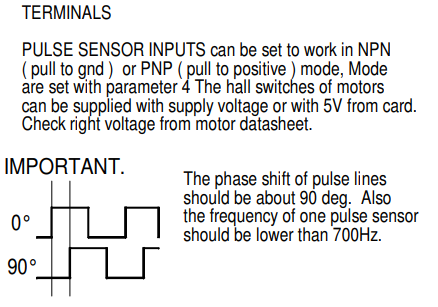

I have 2 actuators with analog potentiometer that I would like to drive parallel with the help of motorcontroller EM-339-PLI from Electromen.
Problem is that the motorcontroller will not work with analog signals. It needs dual channel pwm signals that are phase shifted by 90 degrees, from each actuator.
I want to use an arduino to read the analog position signals (1 analog from each actuator) and output 2 dual channel pwm signals to my motorcontroller. 1 dual channel for 1 actuator.
Im a beginner when it comes to arduino and I only know basic C++. Before I spend too much time with this, I wish to know if this is even possible.
Picture from motorcontroller data sheet.
Thanks in advance.

One key parameter is the <700Hz frequency, which means that the basic problem is that you have to switch a pin slower than every 1s/700/4=357us.
How is the potentiometer supposed affect the signals? Slow them down? As if it was the speed of a 0-700Hz signal?

As far as outputting a 2-channel signal based on what you read goes, it is unclear what you want the 2 channel PWM to do. Does it look like your pic and change frequencies proportionally to the position? Porportionally to an error in position? Does the pic Modulate Pulse Width (PWM?) based on the position? Should the motor turn both directions based on the signals? (like a quadrature signal into a stepper motor?)
An Uno can easily read a potentiometer position and output a 2-channel quadrature signal at well over 700Hz using micros(), digitalWrites and a state machine. It is completely unclear how you want to modulate the "2 channel PWM" based on the potentiometer.
This needs to be in the range of 0 - 1023. (I added a "graph" to the code in post#2).
I think you are right. Googling up the datasheet I see:
It looks like the signals are intended to be something like a quadrature position encoder signal from some Hall sensors.
If the 0-1023 potentiometer is supposed to map to a quadrature encoded position, that seems not at all to be PWM. You only get 1023 steps of resolution, and should likely (bidirectionally) slew the quadrature encoder signals towards the new position setting with some rate limiting.
Sounds possible, but the resolution seems terrible.
