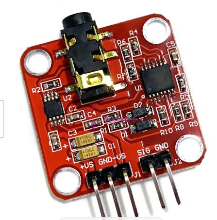

the EMG amplifier that I used is the next
emg2
Are the header pins shown in the product photo soldered to the amplifier board?
Please post a focused, close up photo of your setup, showing the solder side of the PCB.
Use your multimeter to check for +9 and -9V at the board power inputs.

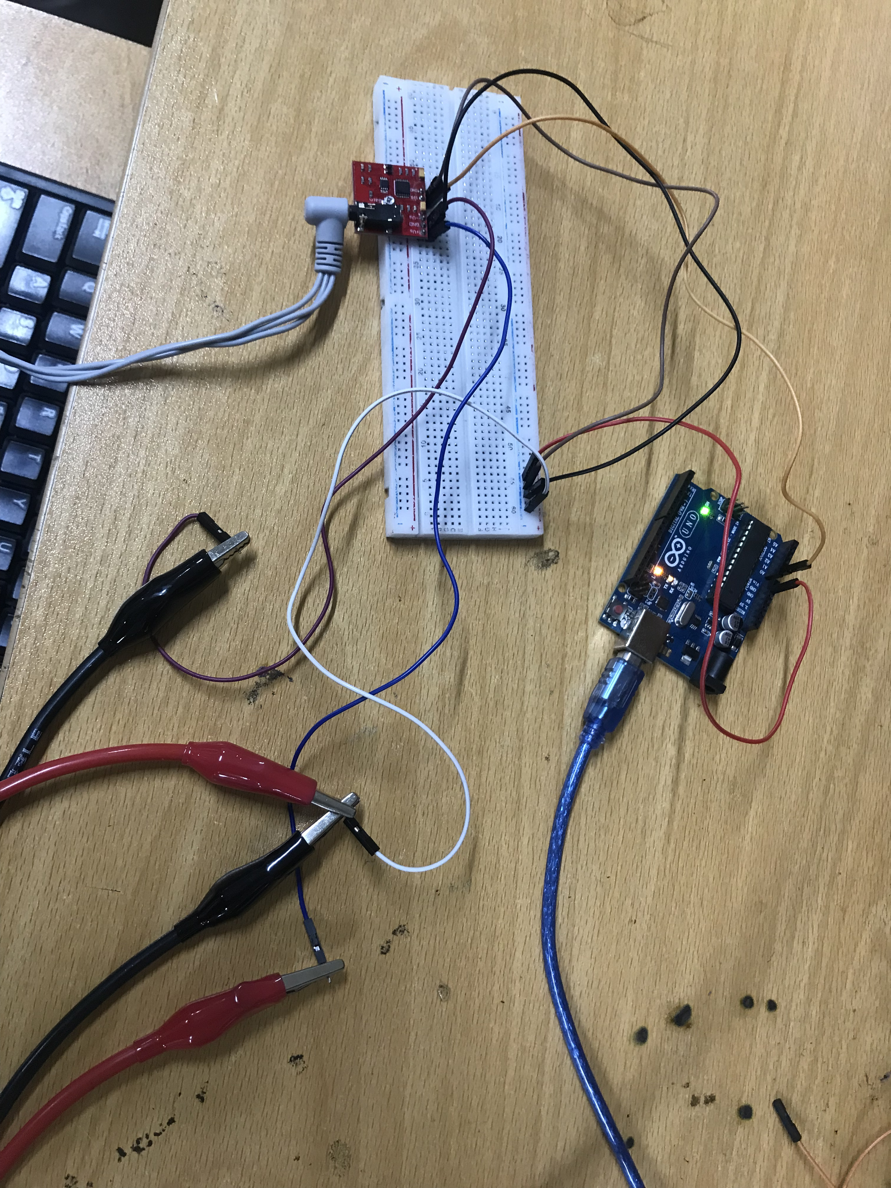

Hello sir,
We are facing the same issue. I have attached a snapshot of our circuit. Please look into it. Also, the code is written below:
