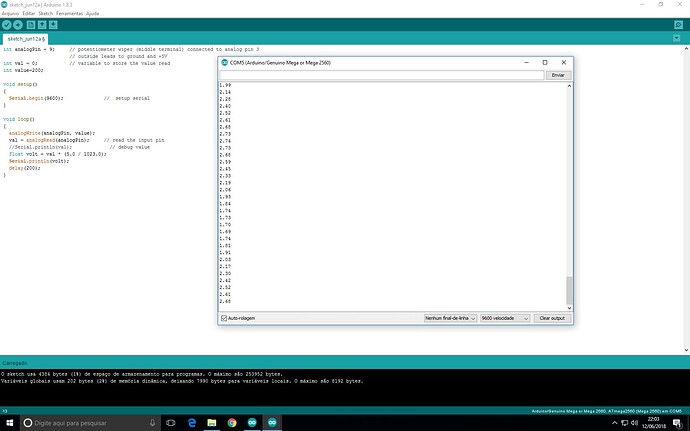

Good evening everyone

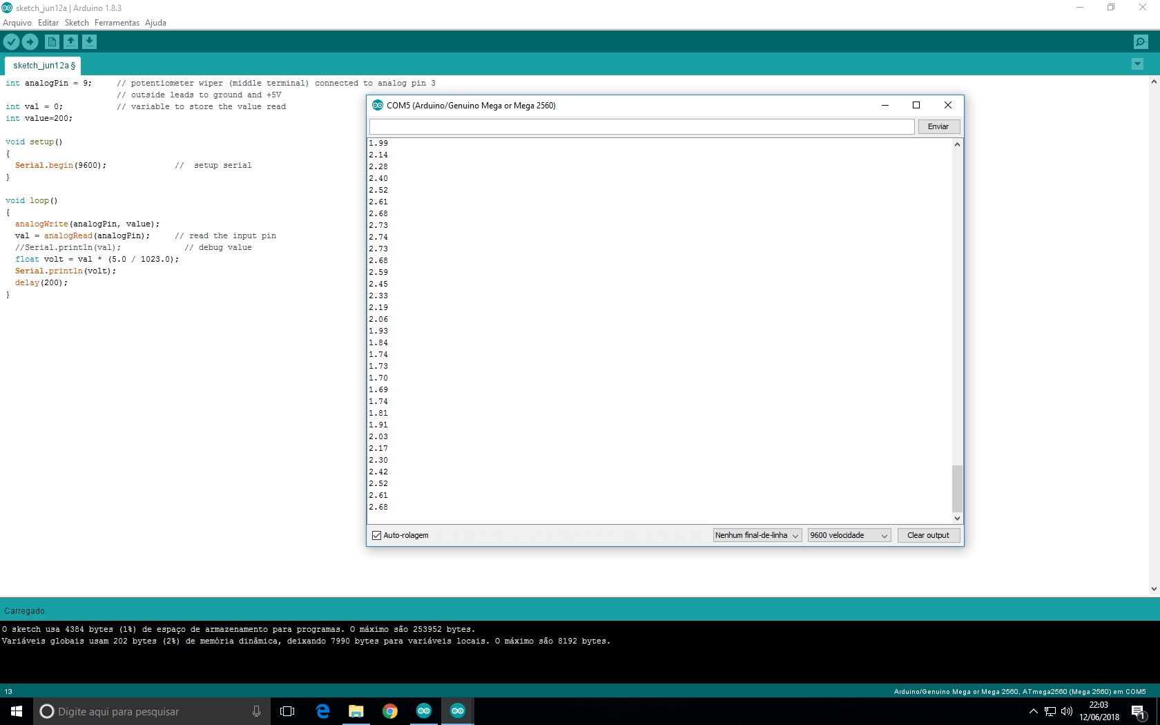

I got a new arduino I have here and I programmed it with little code and I did the test but the results are not exact in the serial port arduino as seen in the attached image, I just want to vary the voltage in some pin that gives to do this and show on a lcd screen, on the multimeter is showing at this time 3.84v
Have you actually read this thread ?
Using a PWM output does not vary the voltage. It will always be 0V or 5V. Only the duty cycle will change.
Did you read this before posting a programming question and if so why did you not follow the advice given about posting code and Serial monitor output ?

I already explained my fault with the title of the post and I apologized, I will explain what I need to do to solve this problem, I need in any pin of the Arduino less of the power supply of course, I need to vary the tension in this pin and show how if it were a multimeter but on an LCD, I only need the reading part of the pin because the communication with the LCD I have and it is great, so I will now summarize this question:
Vary the tension on a pin
read the tension value
I did tests on pin A0 and the values ​​are random see the attached image please, ta on pin 9 but the same result was seen on pin A0
This is my last attempt.
thank you all.
How many times do you need to be told that writing a value to a PWM pin using analogWrite() does not change the voltage on that pin ? It changes the ratio of how long the pin is at 0V to how long it is at 5V
No matter how you read the voltage on that pin it will be at either 0V or 5V for most of the time and that includes reading it using analogRead(). It is possible that you might read the voltage during the short time that it takes to transition between 0V and 5V but that voltage is is not related to the value written to the pin using analogWrite()
In the code that you posted (wrongly by the way) you might just as well do the calculation of the average voltage on the pin based on the value written to it and not bother trying to read it from the pin.
