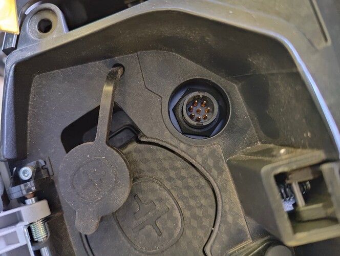

Ok, I think I got it, you were telling me to use two modules to make a communication with those two for experimenting purpose, I think. I read and watched some videos and I think I understand now. I reread the bike manual and I see that the PCU (power control unit), that is the only system that reports a communication interface, communicates in CAN. The other ports don't specify what protocol they use but I suppose is still CAN.
This is my diagnostic port, 8 pins.

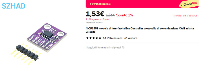

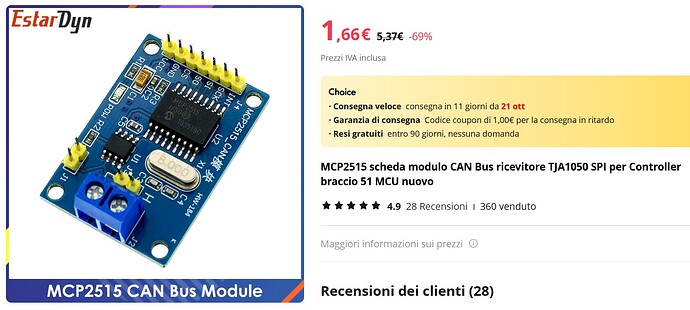

EDIT: My biggest concern now is that I watched many videos of people using only a MCP2515 module but others, like the one of the link I just posted, uses a combination of MCP2515 and a MCP2551 or MCP2562, or a specialized board altogheter.
Is a MCP2515 sufficient?
MCP2515
MCP2551
Those two modules have both the CAN controller and the physical layer interface. Simply add an Arduino, and they will work. Each module can both transmit and receive, so you only need one module to handle both functions.

CAN does not specify types of connectors or pinouts. The connector I show is from the CANOpen recommendations. If the E-bike manufacturer followed the CANOpen recommendations then it should work. I suggest you check voltages and signal levels on the pins before you connect anything.

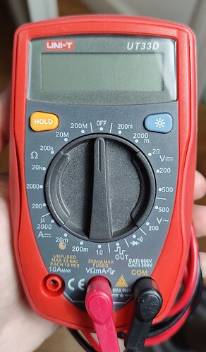

Mh, thank you. Any advice to what should I read on the tester to know if a pin is CAN H, L, or something else?
What is this tester?
Is a multimeter that can read voltage, current and ohms?
Yes, It can
First you need to find out which pin is ground and which is CAN ground.
However, Im not sure how you might go about doing that and I don't want to tell you to do something that may damage your bike.
May I ask you where did you find this diagram? I finally make it to test with my tester my diagnostic port and the pins don't seem to match, given that the power comes from different pins and other pins returns some values that change with time that I think can be the CAN H and L but I would like to do some research before I try to connect to arduino.
I also found some other resources but everything is about a 5 pins CAN port, not 8
CANopen CiA 303 part 1.
However they apparently moved th connector assignments to CiA 106
https://www.can-cia.org/cia-groups/technical-documents
I found the correct pinout. I can confirm because I was able to read CAN frames with an Arduino and a MCP2515 module, now I will have to find a CAN sniffer software to filter and identify them, thanks to all for the help.
