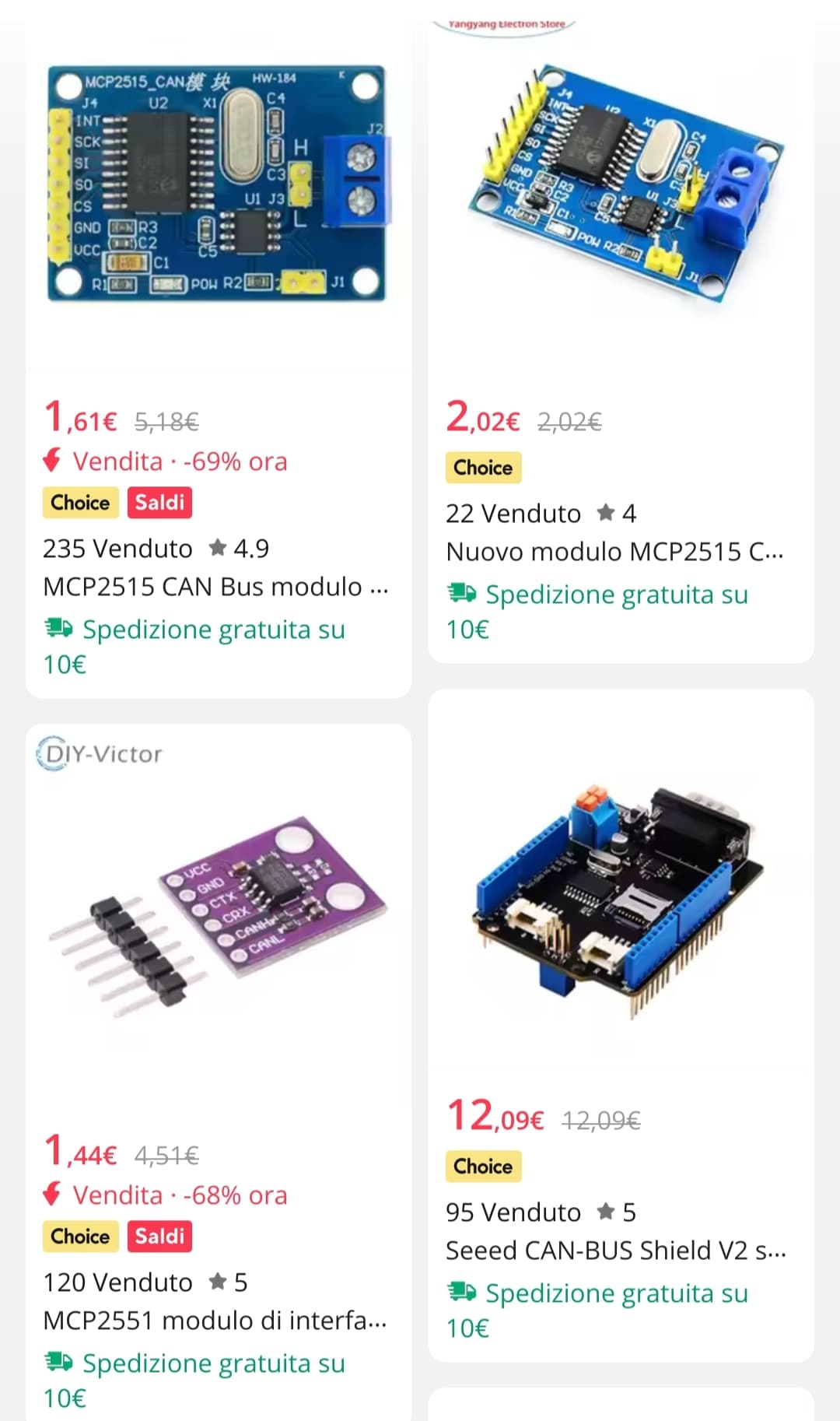

Also I saw some CAN chips on china's best known store that area like 2€ or less and are not so big as I thought, implying that those are the ones I need
All four boards seem to have the CAN physical layer chip. The board in the lower left won’t work unless there is a controller managing it. The other three boards (though I'm not certain about the lower righe one) are MCP2515 modules, which work very well as they include both the MCP2515 controller chip and the physical layer interface.
Cory Fowler wrote the mcp_can library, which works great for these modules. He also provides both receive and send examples. Start by building two modules—one for sending and one for receiving—and get them working. Also, keep in mind that CAN transmissions must be acknowledged by another module on the bus for communication to be successful.
There are various types of CAN in use, including single-wire and differential. They operate similarly, but the interface is different. The bus must support both dominant and recessive modes. For single-wire CAN, think of an open-collector transistor driving the bus with a pull-up resistor. You can have multiple devices connected, within reason. The two-wire differential mode bus is the original and most commonly supported version.

Let's see if I got it.
I need two MCP2515 chips like the upper two in the image I posted earlier. I connect both to my Nano and both chips to my OBD and I use one to read, the other to send to the CAN bus, but to do it the OBD to which I connect the chips must carry 5v.
Given that I am sure it carries 12v, what can I do?
I am reading this Instructables that links to a sparkfun shield that has both MCP2515 and a MCP2551, don't I need the MCP 2551 too?
