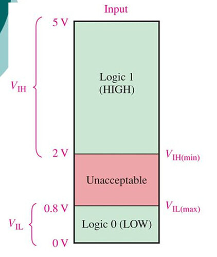

The level of the PWM signal is not matching with the TTL Level Standard:
Your high level at the Oszi is around 700mV. To get high level you need 2V minimum.

Not only that, the Arduino doesn't recognize the full range of TTL standard voltages.
The lower limit for a HIGH on the Arduino Uno is 0.7Vcc or about 3.5V for a 5V Arduino.
Oh yes good hint, thank you. For UNO with ATmeg 328P
shall then
low max 0.3x5V = 1.5V
high min 0.6x5V = 3V
