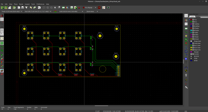

I've seen this done before and to save pins on the wearable computer I decided to try it.
PCB design pros: Is anything wrong with this? Are my traces too noisy or too long? (You're looking at the green lines going to I/O pins 1, 2, and 3.)
Electrical engineers: Are the internal resistances of the buttons going to cause any issues when doing an analogRead() on them?
The extra mounting holes are for a rotary encoder and a joystick that I didn't feel like integrating into the PCB.
EDIT - I just realized how low-res this picture is. I/O pins 1, 2, and 3 are the top 3 pins on the I/O header. 3 is at the top, and it counts down to 1. Below that is GND and the bottom pin is VCC to power this board. The grey text above some mounting holes is there because of a settings error.
I wouldn't worry about the noise since you are almost at DC. But I am concerned with the buttons. First, what buttons are you using? All of the (inexpensive) square buttons I've seen connect diagonally. Also, it looks like you have traces going through the holes for the buttons.

And yes, I have traces going through the THT holes because I want the buttons all connected in a row.

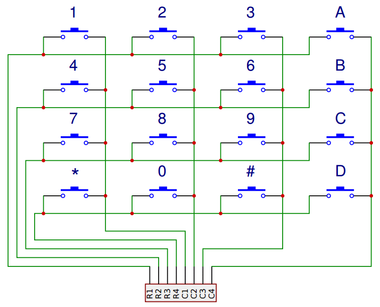

EDIT - I want everything hooked up like this but without one column:
...and then converted to this for analog "multiplexing":

Why are the traces so thin ?
I’ll bet you have room for 35 to 50 mil traces.
They are just logic lines. Maybe I'll beef up the 5V and GND lines though.
Thicker traces are more robust, especially when it comes to people new to electronics/soldering.
True. I'll make them 0.4mm or something.
Why .4mm ?
Use 50mil and make the thru holes for the switches 80mil.
