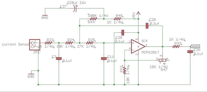

Hi All,
I have an ongoing project for spot welder where i am trying to read the ac voltage induced in a transformer at its secondary. The open circuit voltage of the MOT(Microwave oven transformer) is 2.6vac.
I have two taps on the secondary 40 cm apart to read a voltage when the secondary shorted or in other words when a weld happens. My current sketch looks like this but i need some help to adjust to required voltage. after which i could calculate the current using ohms law.

In the schematic the voltage is level-shifted-up from the center to a safe voltage that arduino can handle.

Just noticed that even without the secondary shorted there seem to be constant value which is not correct. The schematic would be wrong i guess.
Would it be ok to pass this voltage into the arduino directly ? Would this damage the IC ?
You have an AC voltage, while an Arduino can only read positive voltages. So you have to bias your AC signal so that the lowest is >0V, then add a resistor divider to make sure the highest peak is <5V.
Your 2.6V AC gives a peak-peak of at least 5.2V which is too much already. If that 2.6V is the rms value of a pure sine wave, the actual peak-peak is about 7.4V even. So you have to bring that voltage down. Now you can start sampling the signal to read the waveform, and do whatever you like with this.
A second option, much simpler but only providing the peak value, is to use a diode to rectify the signal (half wave is enough), and add a resistor and capacitor to smooth the signal. Now you get a 3.7V signal (assuming 2.6V RMS so 3.7V peak) which is safe to supply to the Aduino pin.
So that's the voltage part taken care of.
A similar thing you can do with the signal coming out of your current sensor, which I assume is a voltage signal, but that should be a much smaller voltage so some amplification is needed in that case.

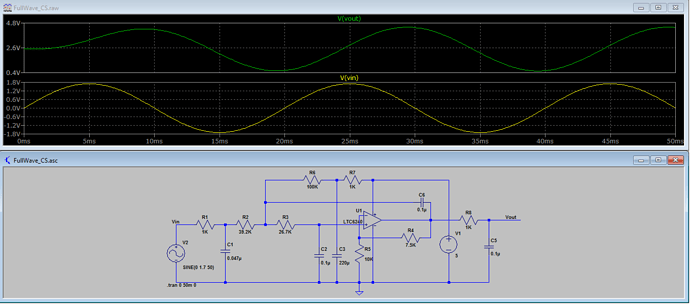

I get the result i want when i simulate the circuit mentioned in the first post.
FullWave_CS.zip (907 Bytes)
Are you sure that output is what you want? I see a large phase shift there. The output really lags the input, which I suppose is caused by C3. Did you also try to simulate with different input voltages?
It's also a rather complex circuit if all you want is applying an offset, which can be done with as little as a single capacitor and two resistors.
Since the voltage at the input is in the range mV. There would be chances of errors in the reading and more over with the input voltage is varying because the weld current is varied.
biasing you mean like this i guess
but i doubt it would be possible for my application though it would can be simulated. I would give your suggestion a try but a concern would be the signal being mV would it be detectable for the Arduino but then hope is that the ADC would detect that.

So what is the signal level coming from that current sensor?
On the Arduino you can set the ADC to use the internal 1.1V reference, making it a lot more sensitive (and probably more stable).

1/ I take it the 2.6vac is for the filament of the magnetron - is it referenced to earth, or some other potential?
I'd expect it to be at about -2.5kV compared to ground - the anode of the magnetron is normally grounded.
Not easy (or safe) to measure.
2/ The circuit you posted is a Sallen and Key Butterworth lowpass filter - of what relevance is this to your needs?
