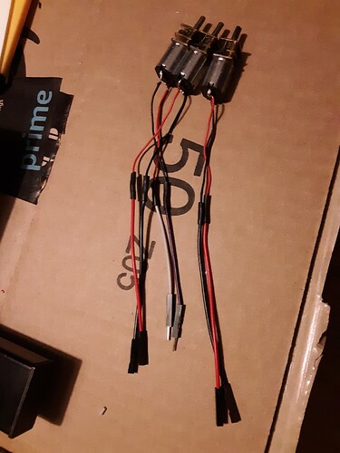

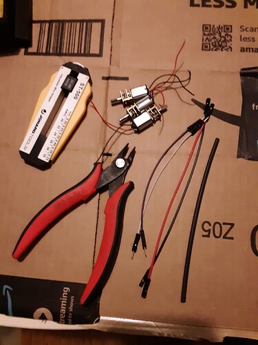

Alright, let's get to it. I'm going to solder Dupont jumpers to some motor wires.

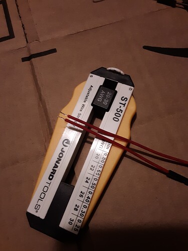

Cut the jumpers in half and strip the ends. Any wire stripper for the size wire will do. You can use a sharp knife or exacto blade if a stripper isn't in your budget. Be careful not to cut the strands or yourself if not using designated wire strippers. I used my teeth when I was young and dumb.

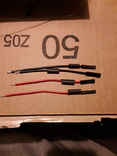

Tin all wires. This means pre-solder the wires with a coat of solder

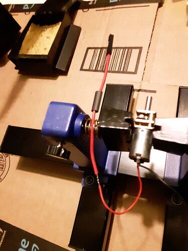

Don't forget to slide the properly sized shrink tubing on one wire prior to soldering them together. Electrical tape can be used but shrink is preferred. The solder joints can be covered with an epoxy if nothing else is handy. In a pinch I have coated it with a few layers of my wife's fingernail polish.
Solder the stripped and tinned jumper end to the motor wire. Make sure the shrink is in place prior to soldering. A stand like what I'm using is nice to have but not required. It takes steady hands and some creativity without it. I lived many years without one. Now I'm too old to live without one :frowning:
Repeat until complete
I hope someone finds this helpful
