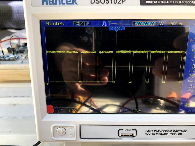

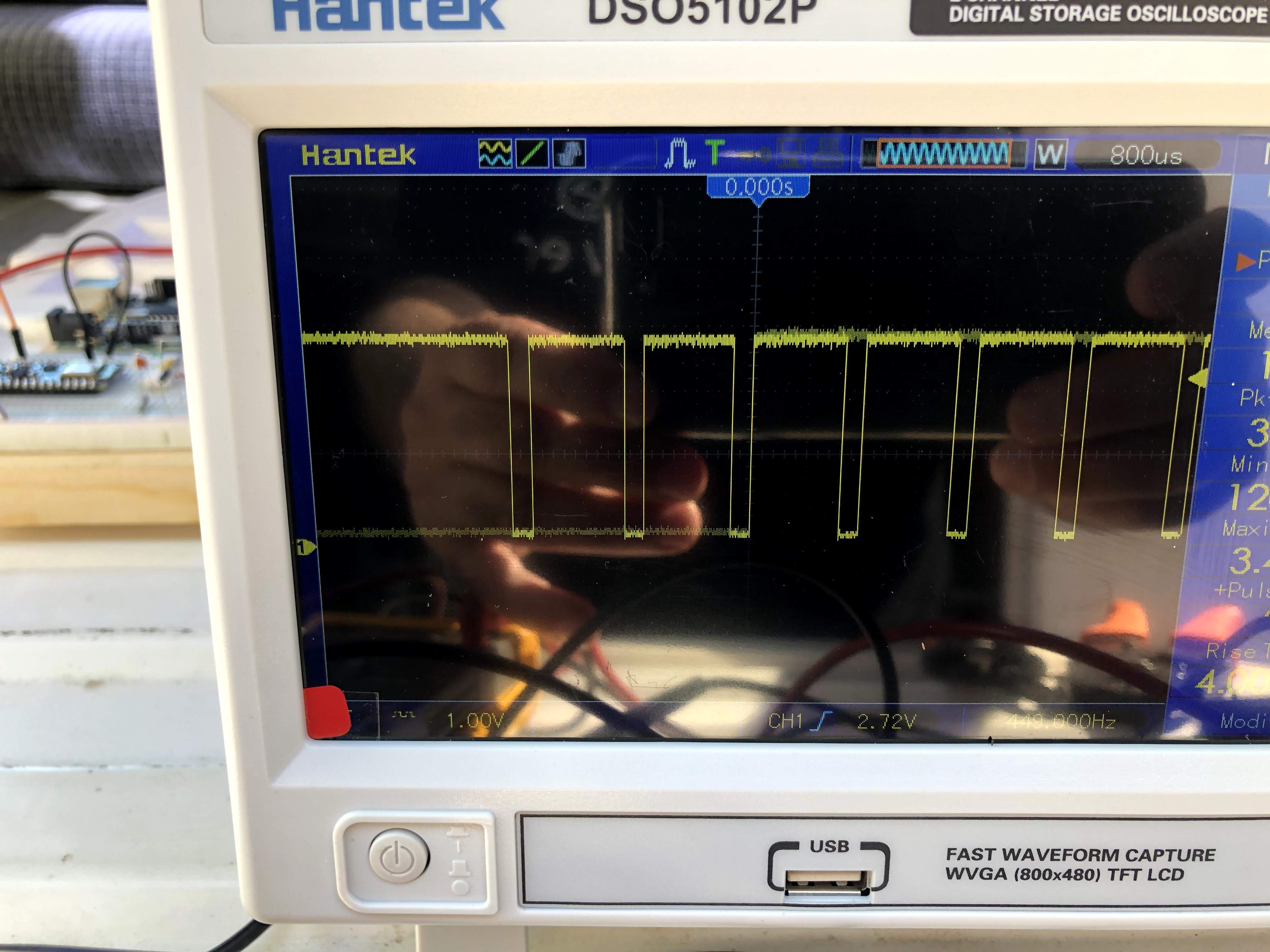

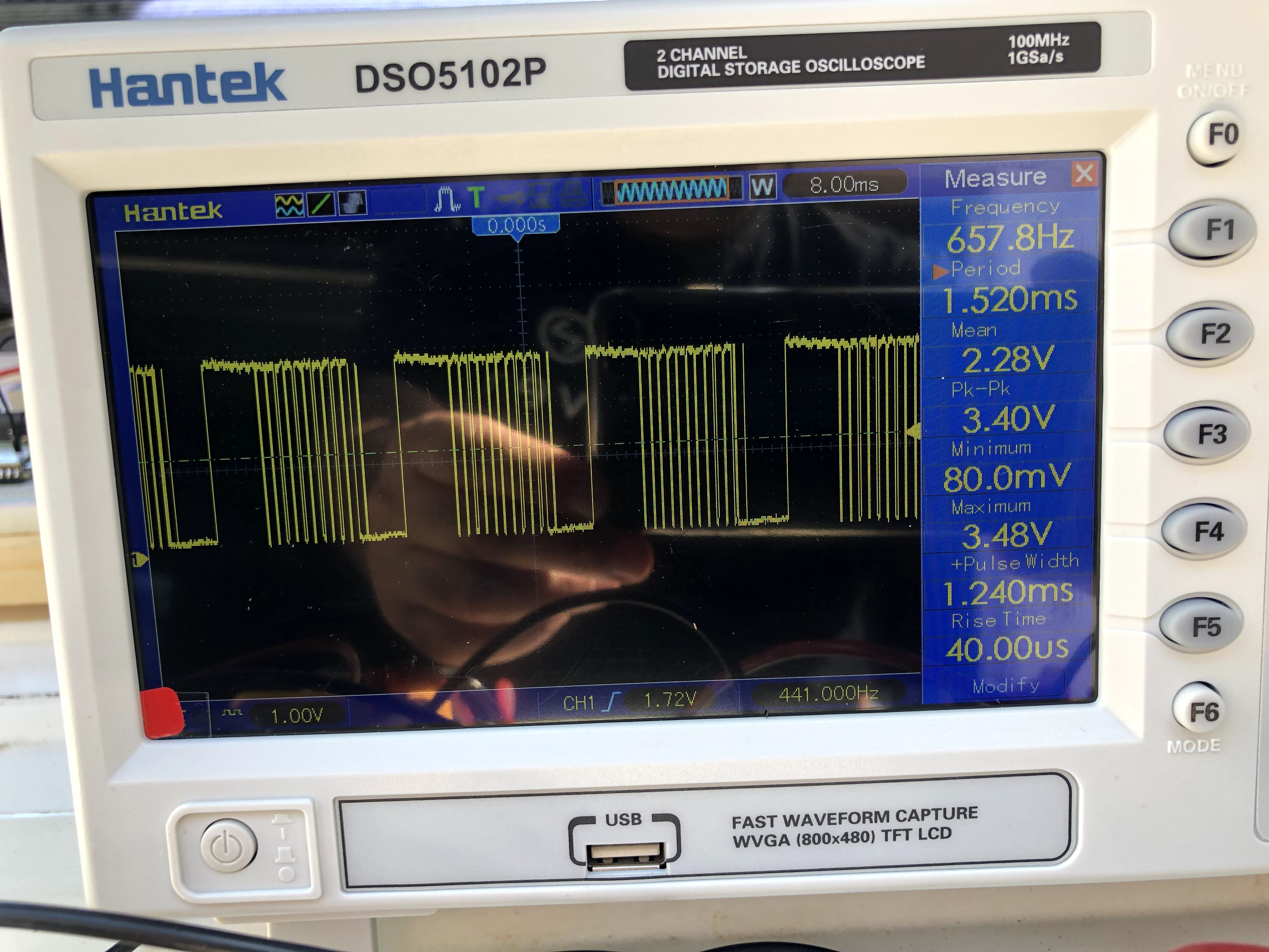

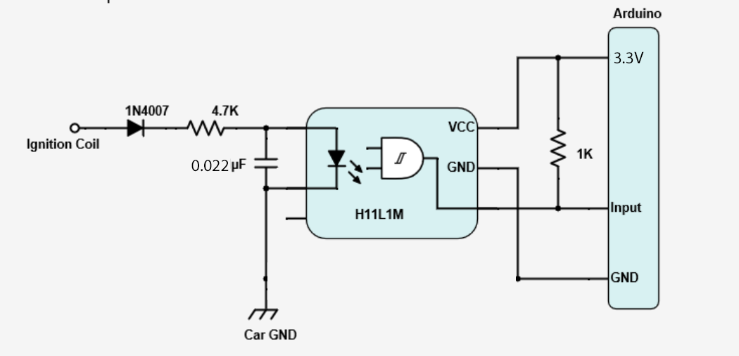

I am trying to read the pulses of the coil and calculate the RPM on an old (86) Vanagon. I found a few topics about simular projects and tried to learn from them. I am using Arduino NANO 33 BLE for the project and the circuit I build for it is based on an H11L1M (Schmitt Trigger Output Optocoupler). Please see attached schematics of the circuit. I am getting very clean pulses on the output side (see attached photo) but I am not sure I am reading the correct information as the frequency is not changing when I am raving the engine. It stays the same. Any thought on what can it be? The last photo (sorry about the reflections) is how the input signal looks like. The software I developed read an average of 40 pulses per 100 ms using interrupt.

I ended up connecting it to the HALL sensor on the distributor. The signal is cleaner and changing with the engine RPM.
