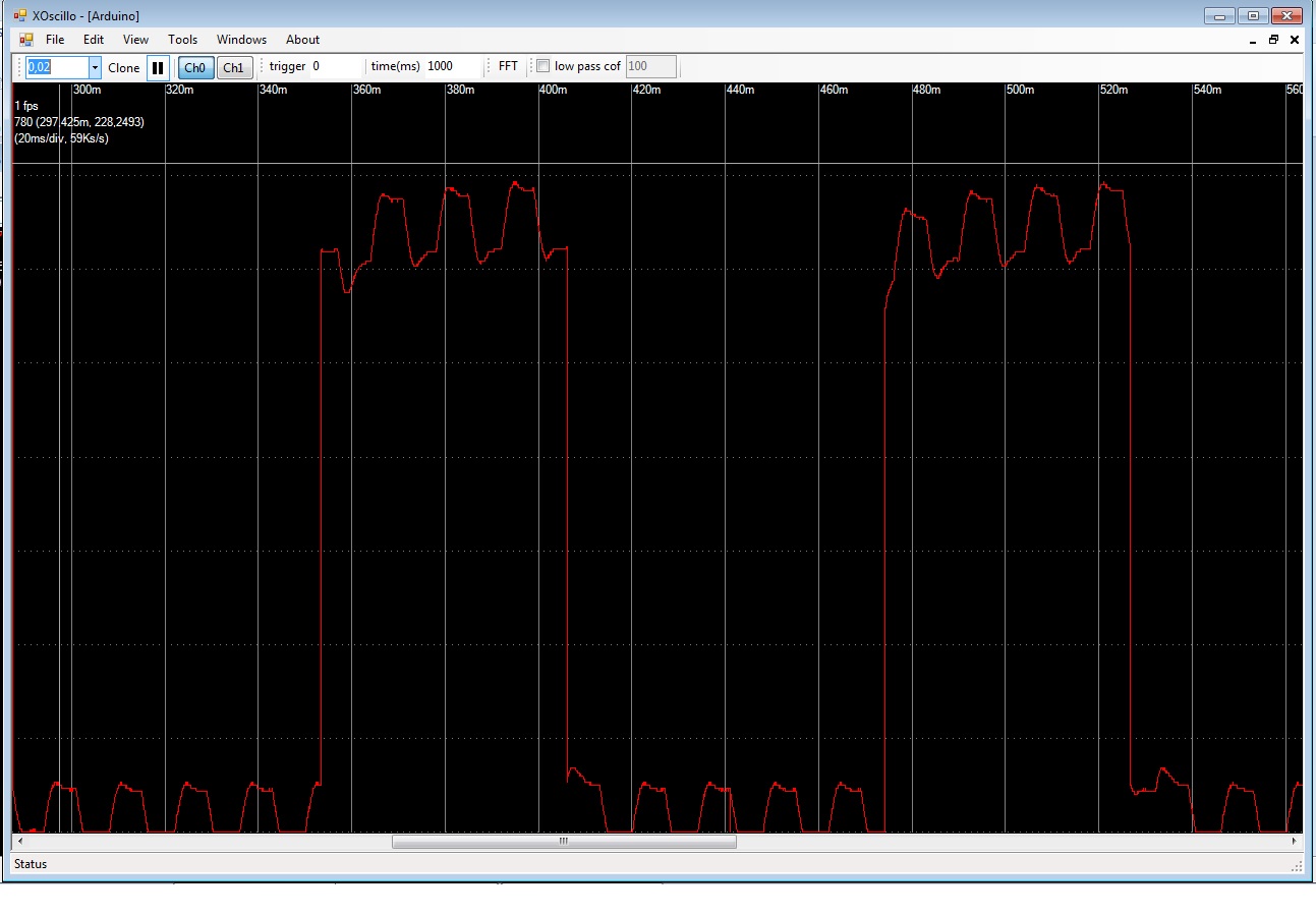

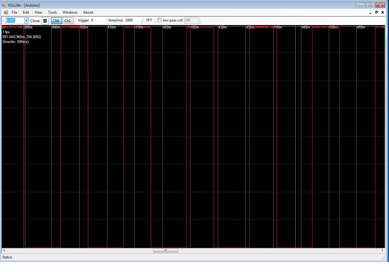

ok so here's an update;
in the mean time, I've gone ahead and simulated a PWM with my one Arduino Uno board by means of simple bit-banging and thus switching an output pin high and low alternatingly.
Now when I take my other Arduino Uno and analyze the signal using XOscillo, I get a nice crisp PWM graph which should be easy to make use of with the Arduino's interrupts:
This is using a voltage divider made by simply arranging two fixed-value resistors in such a way that the output voltage is reduced to a certain lower voltage. Fundamentally, this is what I am going to have to do in my car to step down the 12V from the signal wire to a more Arduino-friendly 5V.
However, something needs to be done to protect the Arduino from voltage spikes in a car environment. So I added a 4V zener diode between the resistors and the input pin just to see how that would affect the signal curve... and this is what I got:
You see the problem... with a signal like that, I can neither detect a "rising" nor a "falling" or a "change" with any degree of accuracy with the Arduino's interrupts.
