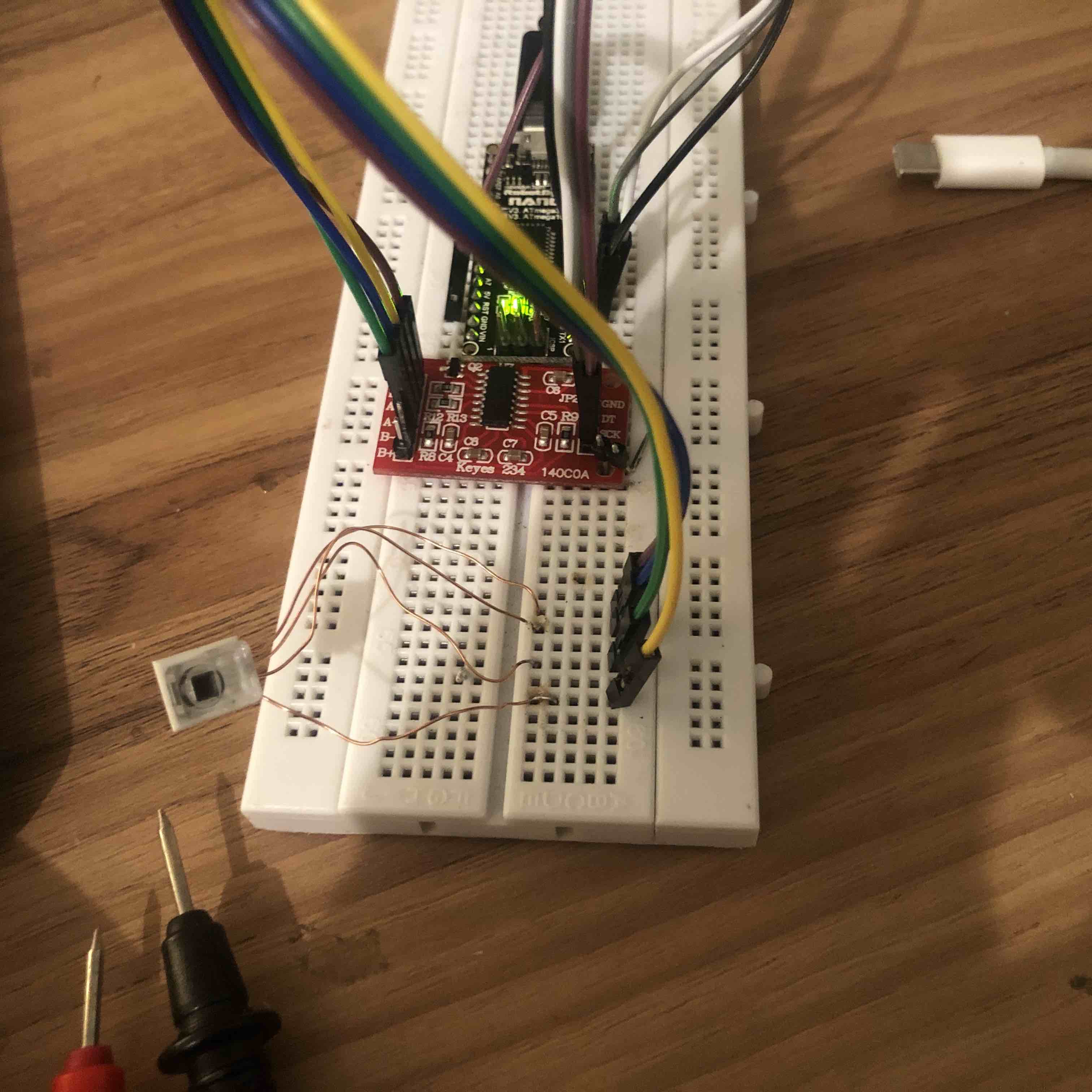

Hi Leo,
I purchased the HX711 breakout (Bought it from a local supplier and turns out its actually a Keyes 234 140C0A) - but appears to be almost identical.
I've tried using the Bogde library and having some issues with the readings.
No matter which gain I set (Channel A 128, Channel A 64, Channel B 32), my readings are returned as:
HX711 reading: 8388607
I can't see many spots I could mess up in the wiring:
Arduino 5V -> VCC
Arduino GND -> GND
D4 -> DT
D5 -> SCK
My sensor is then connected directly to E+, E-, A+, A- (Tried B also).
Any suggestions on where I may be going wrong?
Cheers
Oliver

280mV between A+ and A- is way to much.
E+ should be 4.25volt.
E- should be 0volt (Arduino ground).
Need to see the setup (as previously requested).
Leo..

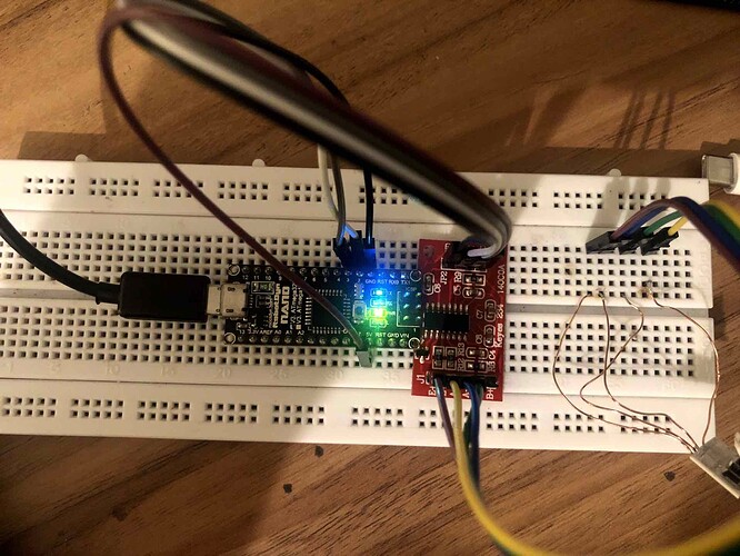

Photos of the setup are attached to the previous post.
Is that enough?
Should I using arduino GND instead of E-?
Cheers
Connections seem right. Are you sure the sensor is connected right? (can't see).
Did you measure with the black lead of the DMM touching the metal part of the USB socket (Arduino ground).
E+ must be ~4.25volt, and E- must be 0volt (no sensor connected).
They must stay the same with the sensor connected.
Leo..
