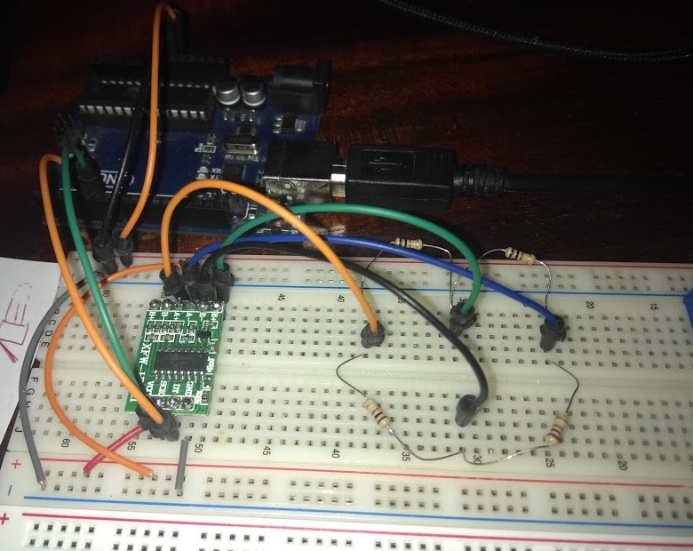

Here, I took a picture of the setup attached below. I still get the readings stuck at 13108 when using this config, are you able to tell if there is an error in the setup?

While waiting for your image...
E+ should be 4.25volt, E- should be 0volt.
A+ and A- should both be 2.125volt, and there should not be more than 10mV between them
(with DMM pins on A+ and A-).
Leo..
On the green HX711 module GND is not connected to Arduino GND directly but via an input protection diode and so E- is not 0V (measured to Arduino GND) but about 0.6V. I don't remember what is E+.
Never seen that, and I can't imagine it to be right, looking at the HX711 datasheet.
That would seriously reduce the excitation voltage.
Do you have a link to the diagram of that module, or clear pictures of both sides of the board.
Leo..

This is interesting, I have 2,7V on all 4 pins (A+/- and E+/-) with this current setup. Do you think of a reason why? I have checked continuity between the 4 pins and none of them is.
ss
Wiring seems ok, apart from too much solder on the pins of the module.
Remove all the wires. and move the module to another position on the breadboard (BB do have bad contacts).
Then only connect VCC/GND to 5volt/GND of the Arduino, and measure E+ with black lead of the DMM on the metal shield of the USB socked (GND).
It should be 4.25volt..... ±0.1volt.
If not, check/re-solder, or try a new HX711 board.
Leo..
Wawa:
Leo..
Thanks, I measured 0V from E+ to GND, and made sure the 5V was reaching VCC of the HX711 module. I am wondering if it might be a setting that deactivates the E+/- pins sent to the chip (maybe it would be saved on its eeprom?) I am not the first person who used this specific module and I am unaware of any changes that could have been made firmware wise. I cant find anything on the datasheet though..
You could be right.
The chip has a power-down mode, activated with the clock pin.
Not sure if that will also affect the E+ excitation supply.
Haven't got a board handy at the moment, so I have to pass that problem on to another forum member.
Leo..
One of my spares, with the clock pin held low (tied directly to ground):
Vcc=4.97v from a wall wart
E+=4.96v
E-=0.81v
All are relative to the GND pin.
E+ to E- = 4.15v
If the clock pin is floating, the behavior may be undefined.
