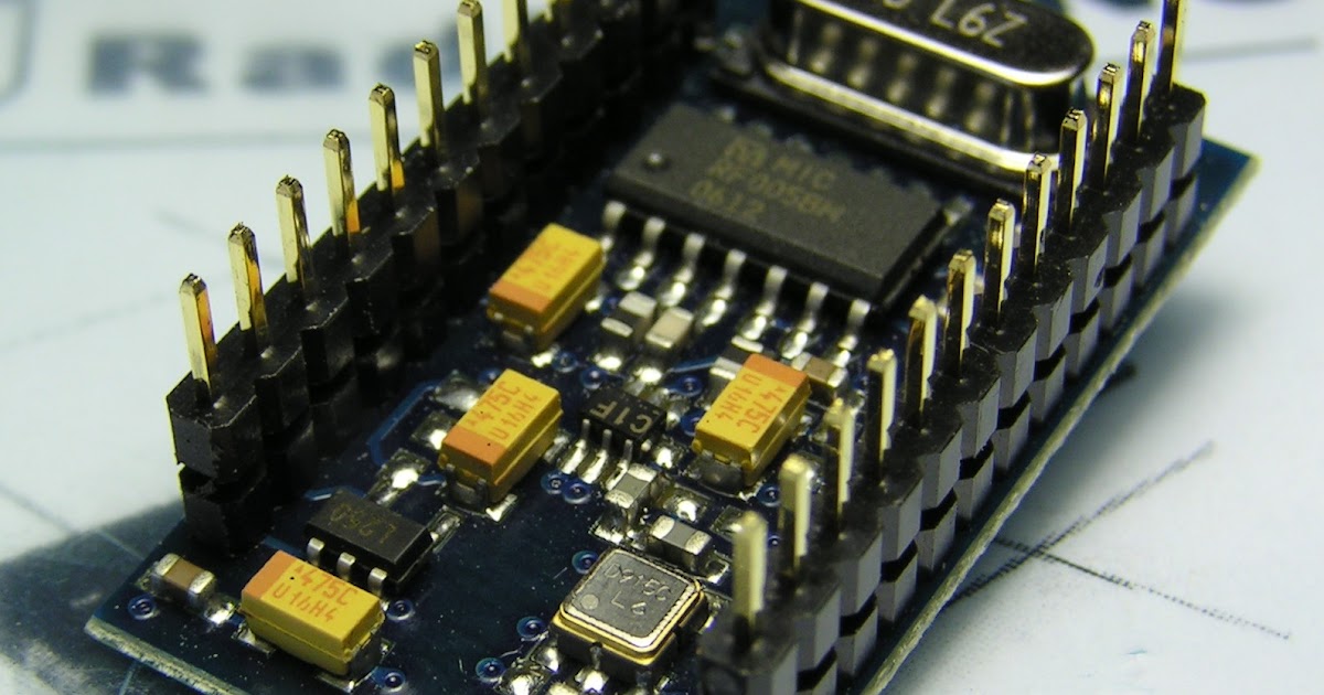

I don't have an oscilloscope but arrived at a solution through trial
and error for my Itron CL200 meter. The CL200 seems to output an
unmodulated infrared pulse of about 10ms width. I used the infrared
sensors from Sparkfun (SEN-00241) successfully for this. Don't use
the Sparkfun IR Receiver Diode SEN-10266, it is for modulated IR
signals, such as from TV remotes, and will not work with pulses from
the Itron CL200.
The nature of the SEN-00241 sensor, and probably any other sensor as
well, is such that it is sensitive to ambient IR radiation, so you
have to shield it. I just masked a good area of the IR emitter on the
CL200 with black electrical tape. The ambient light drives the output
voltage down. So additionally, I route output from the IR sensor
through a LM339 comparator to clean up the output to good high and low
levels to count the pulses accurately on my Arduino. Even though my
meter gets sunlight, the masking and the processing seems to be
adequate.
I verified the correct pulse count by comparing it tothe kWH display
on the CL200, the kWH increments by 1 excatly 1000 pulses counted on
the Arduino.
I have the same meter cl200
I got a simple IR from radio shack and used software to filter - mine is in direct sunlight - used duck tape to make a shield.
been running for 2 years - total error rate is .25% over that time rate - varies month to month most of the time about .5% and max about 3.5% - as I don’t know what time the read it I always use 12 noon from my readings.

anyways here’s my code - the odd filtering is to try and account for different sunlight levels then reading the meter.
unsigned long powerCount = 0;
unsigned long powerCountLast = 0;
unsigned long powerLastBlink = 0;
unsigned long powerK5count =0;
unsigned long powerW1=0;
unsigned long powerW2=0;
unsigned long powerW3=0;
unsigned long powerW4=0;
unsigned long powerW5=0;
float powerBlinkLength = 80;
float powerBlinkRate = 200;
int powerBlinkFlag = 1;
float powerFilterR = 600;
float powerFilterH = 600;
float powerFilterC = 600;
float powerMaxL = 1;
float powerMaxH = 0;
int powerReading = 0;
void PowerLoop() {
  powerReading = analogRead(power_input);
  powerFilterR += .55 * (powerReading-powerFilterR);
  powerFilterH += .01 * (powerReading-powerFilterH);
  powerFilterC += .9 * (powerReading-powerFilterC);
  if (powerFilterC/powerFilterH < powerMaxL) powerMaxL = powerFilterC/powerFilterH;
  if (powerFilterC/powerFilterH > powerMaxH) powerMaxH = powerFilterC/powerFilterH;
  serialPrint();
  if ((powerFilterC/powerFilterH <.9 && powerBlinkFlag ==1 && millis()-powerLastBlink > 50) || powerLastBlink > millis())
      powerBlinkFlag = 0;
      powerCount++;
      float rate = millis()-powerLastBlink;
      if(rate>0) powerBlinkRate += .05 *(rate-powerBlinkRate);
      powerLastBlink = millis();
  else if (powerFilterC/powerFilterH > 1.01 && powerBlinkFlag == 0)
    if ( millis()-powerLastBlink > 30|| powerLastBlink > millis()){
      if (rate>0) powerBlinkLength +=  .05*(rate-powerBlinkLength);
      powerBlinkFlag = 1;
 unsigned long w = millis() - lastconnect;
 if ( w < 60000) { powerW1 = powerCount; }
 else if (w < 120000) { powerW2 = powerCount; }
 else if (w < 180000) { powerW3 = powerCount; }
 else if (w < 240000) { powerW4 = powerCount; }
 else if (w < 300000) { powerW5 = powerCount; }
