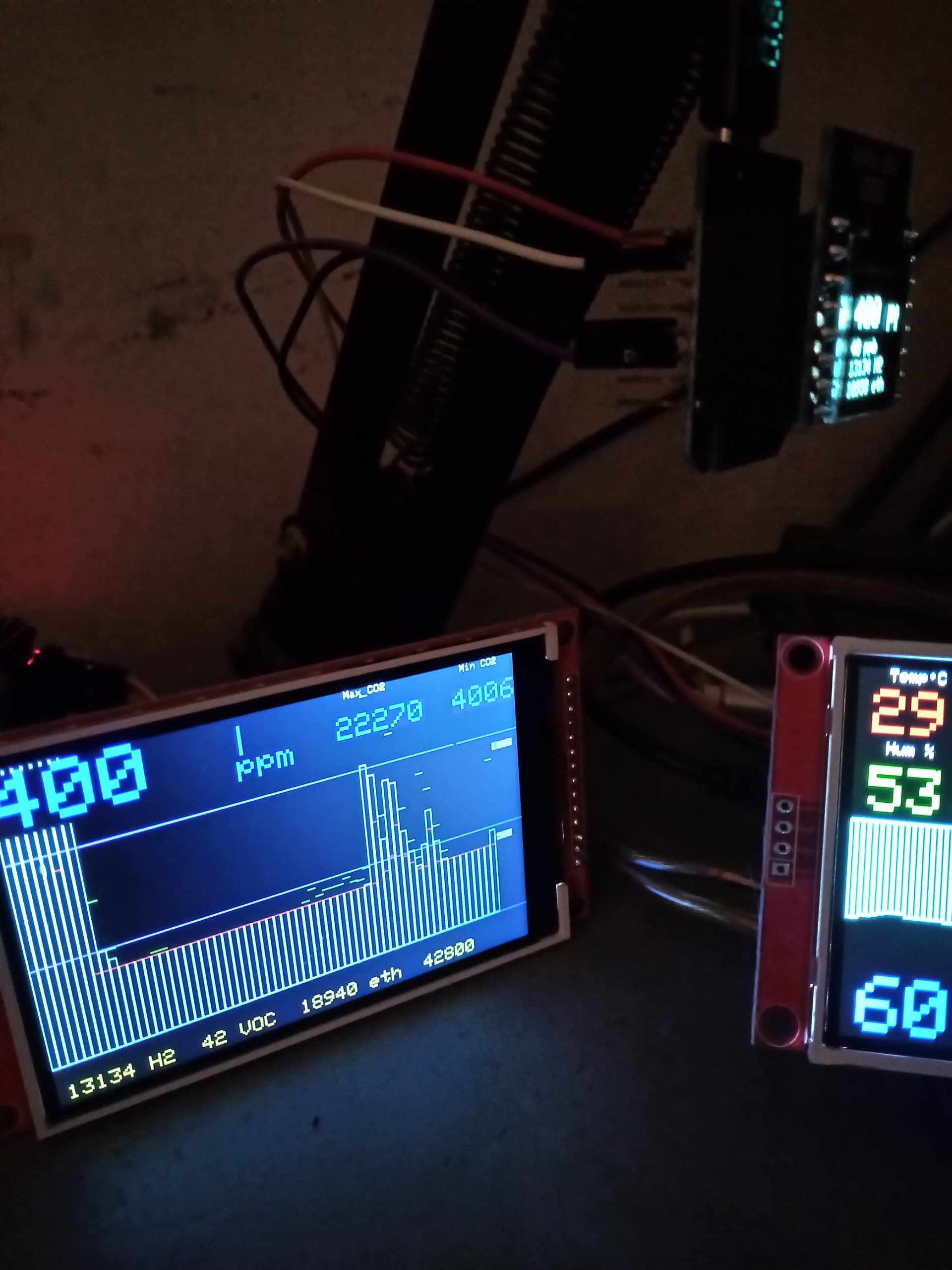

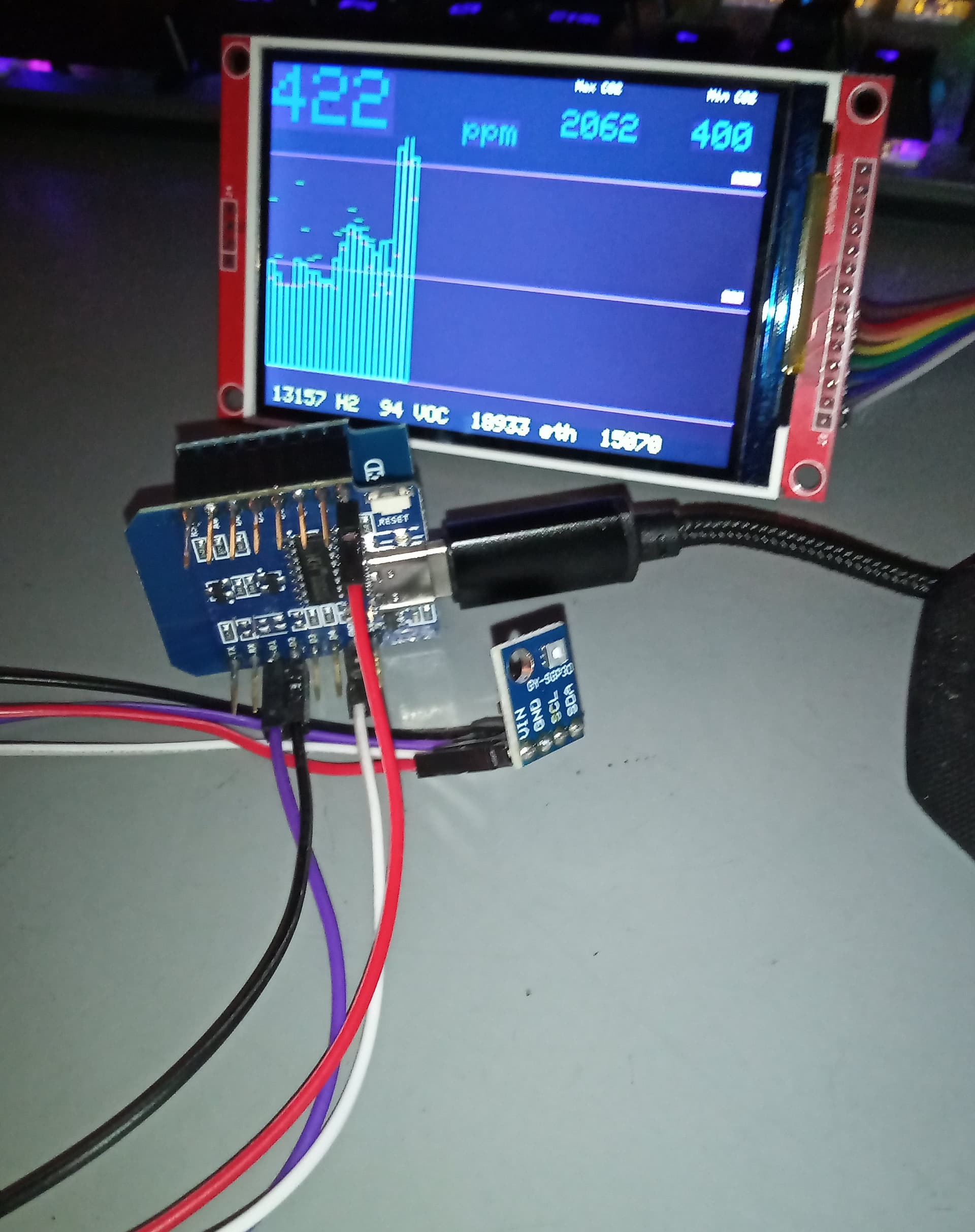

Receive CO2 data wirelessly from ESP8266 D1 mini with SGP30 and display on 3.5" ILI9488
The SGP30 CO2 module outputs 4 kinds of data: CO2, VOC, H2 and ethanol. These are sent wirelessly from a ESP8266 through ESP-now to a ESP32 C3 driving a 3.5" 480*320 ILI9488 display. ( e.g here)
In my last project I used a delay() function to redraw the screen, which works well for a lot of applications. In this project I use a blink without delay function to redraw the screen to allow the microcontroller to do other functions if necessary. I use three such functions to update the CO2 display, draw the columns of the graph and make the averages, and redraw the graph space every 12.5 hours.

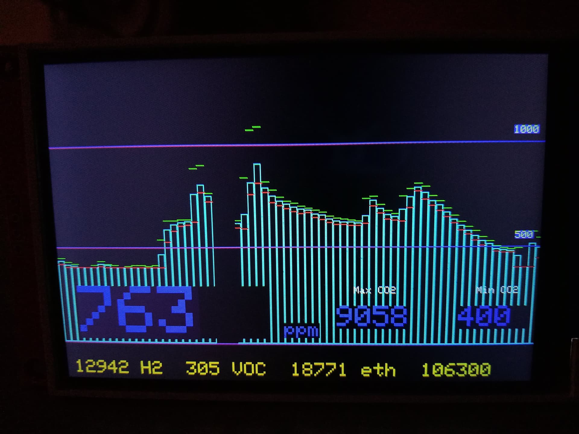

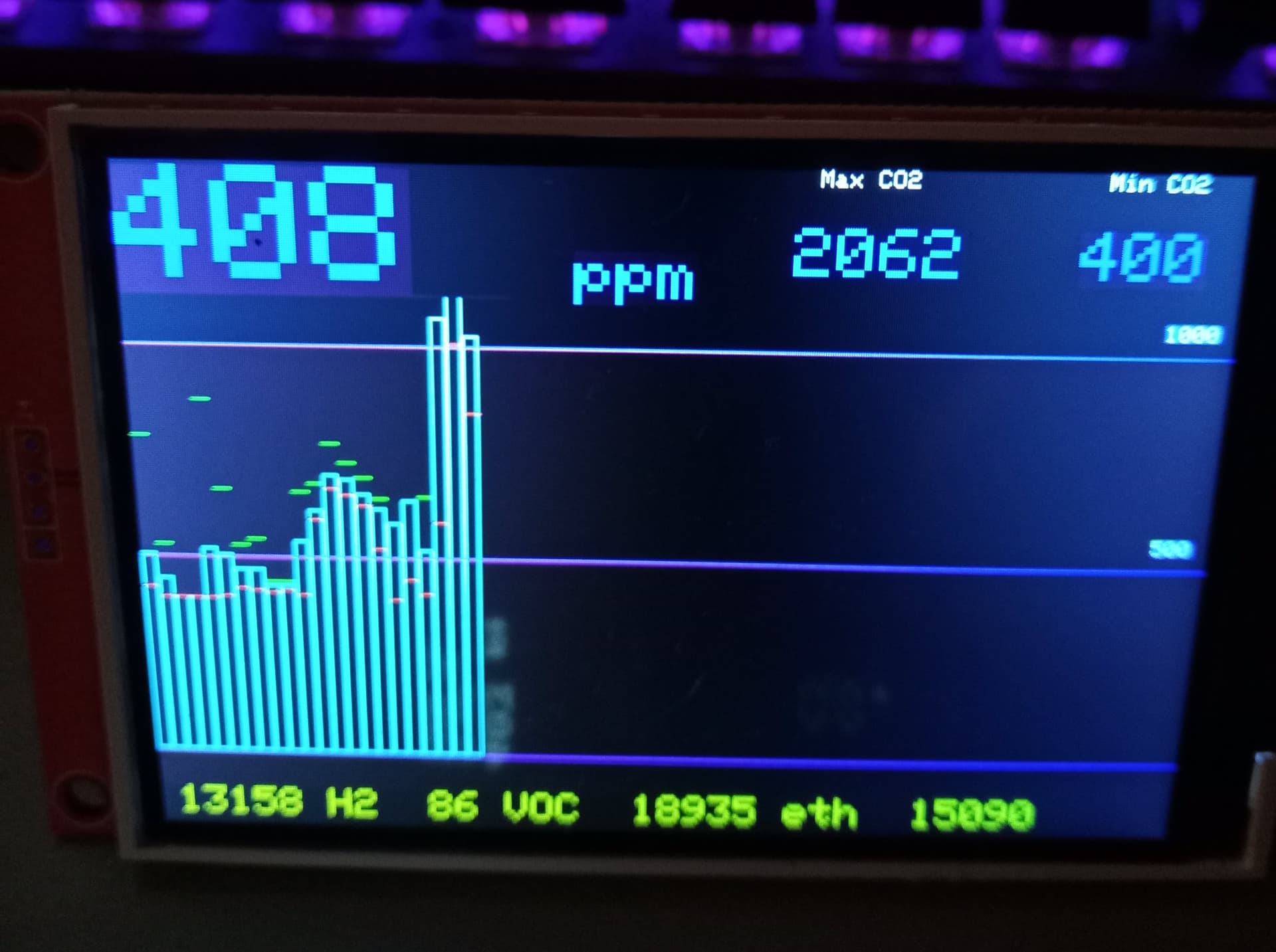

The main data I'm concerned with is the CO2 measurement. Unfortunately with this module the CO2 reading is greatly influenced by the other quantities it is sensitive to. There may be a tricky way to use these other three readings to adjust for this. For comparison my SCD40 CO2 module only measures CO2, temp and humidity, and is far more resilient in resisting the influence of these other gases, such as methane and ethanol.
11 minute columns show the average of CO2 for that time along with minimum and maximum CO2 for that 11 minutes. Takes 12.5 hours to fill the screen from left to right and then it redraws and resets the CO2 min max in the top right.
For ESP32 C3 and ILI9488 3.5" 480*320 I've used Bodmer library setup 70c with ILI9488 uncommented.

One glitch I had was the CO2 min kept reading zero, when it shouldn't go lower than 400ppm, but I haven't seen that in the latest sketches.

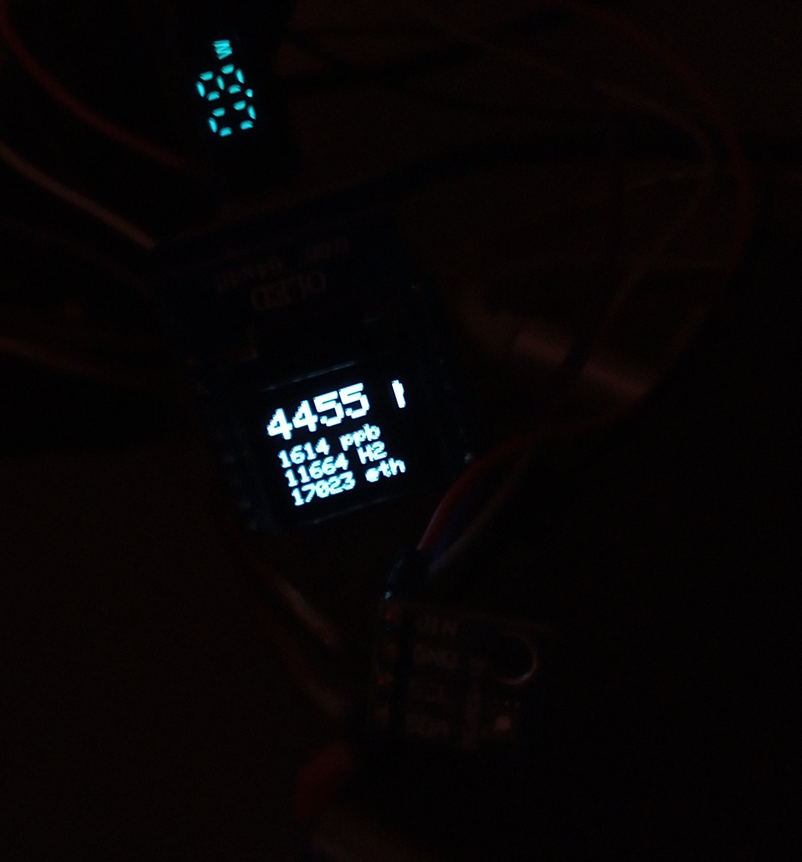

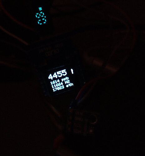

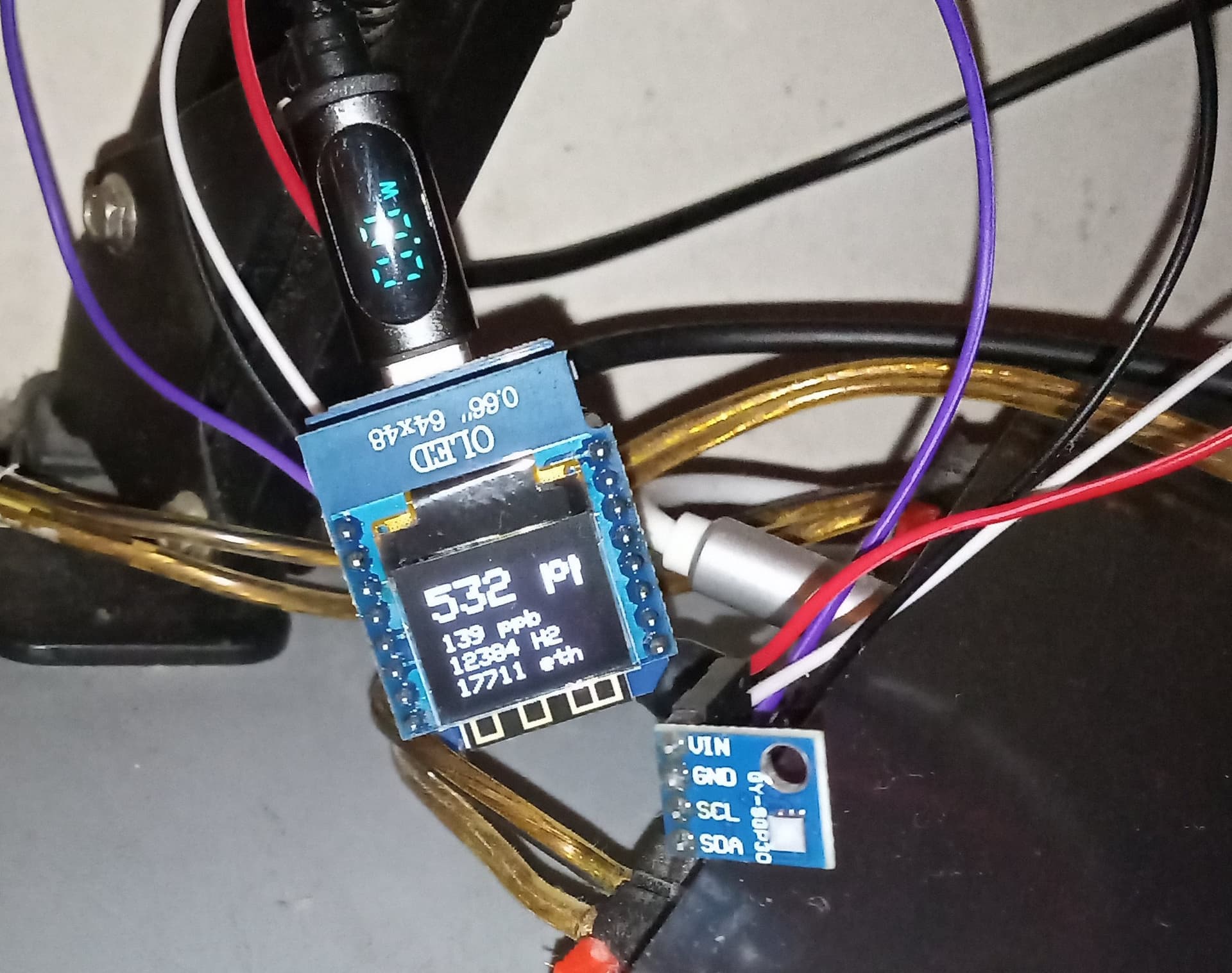

Sender is D1 mini ESP8266 with 0.66 OLED shield display. Attached is the SGP30 with i2c bus in the following way:
SGP30 --> ESP8266 D1 mini
VCC --> 3.3V
GND --> GND
SCL --> 5 SCL (labelled D1 on mine)
SDA --> 4 SDA (labelled D2 on mine)
Library: GitHub - adafruit/Adafruit_SGP30: Arduino library for SGP30

  Serial.print("TVOC "); Serial.print(sgp.TVOC); Serial.print(" ppb\t");
  Serial.print("eCO2 "); Serial.print(sgp.eCO2); Serial.println(" ppm");
  Serial.println(time2);
      display.setCursor(33,00);
       display.setTextColor(WHITE);
         display.setTextSize(2);
         display.print(sgp.eCO2); display.print(" ppm");
         display.setTextSize(1);
        display.setCursor(33,20);
              display.print(sgp.TVOC); display.print(" ppb");
       display.setCursor(33,30);
             display.print(sgp.rawH2); display.print(" H2");
      display.setCursor(33,40);
               display.print(sgp.rawEthanol); display.print(" eth");
  if (! sgp.IAQmeasureRaw()) {
    Serial.println("Raw Measurement failed");
    return;
 Serial.println("");
  Serial.print("Raw H2 "); Serial.print(sgp.rawH2); Serial.print(" \t");
  Serial.print("Raw Ethanol "); Serial.print(sgp.rawEthanol); Serial.println("");
 // display.print(sgp.rawH2);
 // display.print(" H2");
//    display.setCursor(33,20);
 // display.print(sgp.rawEthanol);
 // display.print(" eth");
  display.print(time2);
  display.print(" time");
  display.display();
  counter++;
  if (counter == 30) {
    counter = 0;
    uint16_t TVOC_base, eCO2_base;
    if (! sgp.getIAQBaseline(&eCO2_base, &TVOC_base)) {
      Serial.println("Failed to get baseline readings");
      return;
    Serial.print("****Baseline values: eCO2: 0x"); Serial.print(eCO2_base, HEX);
    Serial.print(" & TVOC: 0x"); Serial.println(TVOC_base, HEX);
 time2 = millis()/1000;
  if ((millis() - lastTime) > timerDelay) {
    // Set values to send
    myData.a = sgp.rawH2;
    myData.b = sgp.TVOC;
    myData.c = sgp.eCO2;
    myData.d = sgp.rawEthanol;
//    myData.e = time2;
    // Send message via ESP-NOW
    esp_now_send(broadcastAddress, (uint8_t *) &myData, sizeof(myData));
    lastTime = millis();
ESP8266nowSender_CO2.ino (6.1 KB)
Sometimes I have to hit reset to get it to display after I've uploaded it.
Delighted with how this turned out. It looks so sciencey with the minimum and maximum bars. I tested it overnight and it did reset as I had hoped once I added the xpos = 0 line which I updated in the above post.
I moved the sensor to the lounge room and these were the overnight readings. You can see toward the right where I got up and opened the windows, the CO2 spikes a little and then down to the minimum of 400ppm for two 11 minute bars.
I realised you can retain more data simply by clearing a rectangle near each new graph column instead of clearing the whole graph space. And I moved the numbers down for a neater appearance.
Updated ino:
