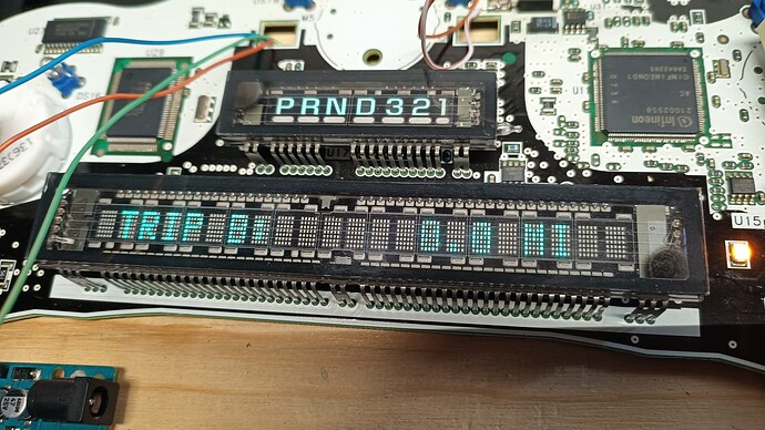

Hello all, I'm looking to intercept serial data sent to a custom display chip that controls a 1x22 VFD. It has 3 lines:
-Latch
-Clock
-Data
All idle high at 5V. The incoming data appears to be at about 1Mhz, in two bursts per display update (I can't tell how much data per burst due to the limitations of my scope.)
I already have the data wires in place into SPI pins on the Arduino, but I don't know much about receiving serial data.
I copied this code from Gammon.au, modified the data rate, and added the SPI mode line:

I'm using PuTTY to monitor the serial since the Arduino serial monitor data rate is limited. I get a few random characters every 4th display update or so, but that's about it.
The problem is, I don't really know much about SPI, what I'm doing, or how the data is stored and pushed out to PuTTY.
Once I can reliably store the display update "bursts", I can then move on to processing the data (I have a character map from the display chip datasheet).
Can anyone help with the data capture portion? What other info do I need?
Thanks all!

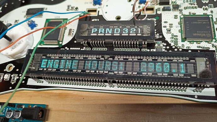

Each transmission starts with a command byte followed by at least one data byte.
Messages:
" ODOMETER: 201680 MI. "
" TRIP A:      0.0 MI. "
" TRIP B:      0.0 MI. "
"ENGINE HOURS:  2960.1 "

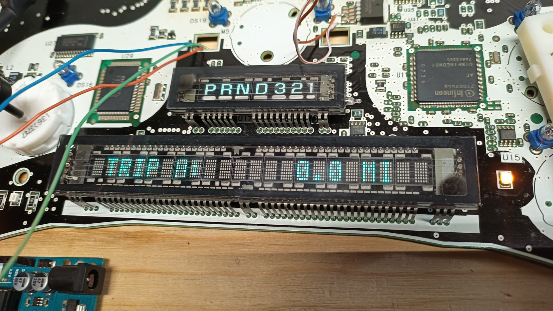

In case anyone is still following:
trip a
09 04 4A 0A 82 04 04 04 0C 0C B2 04 08 2A 92 04
5C 04 04 04 74 04 92 04
trip b
09 04 4A 0A 42 04 04 04 0C 0C B2 04 08 2A 92 04
So I'm seeing the "82" byte change to "42" which is a good sign (only difference in the display is A character vs. B character). If my conversion is correct:
A = 1000 0010
B = 1000 101
The character map shows (MSB, LSB)
A = 0011 0001
B = 0011 0010
So the bit moves, but I still have some deciphering to do. I wonder if building a new HEX character table would make the process simpler?
Not quite correct:
0x82 -> 1000 0010
0x42 -> 0100 0010
A -> 0011 0001 -> 0x31
B -> 0011 0010 -> 0x32
It looks like the bits are reversed and the result is off by 0x10:
0x82 -> 1000 0010 reversed -> 0100 0001 -> 0x41
0x42 -> 0100 0010 reversed -> 0100 0010 -> 0x42
0x41 - 0x10 -> 0x31 -> 'A'
0x42 - 0x10 -> 0x32 -> 'B'
The SPI settings probably default to LSBFIRST. You should configure for MSBFIRST:
`SPI.setBitOrder(MSBFIRST);'
