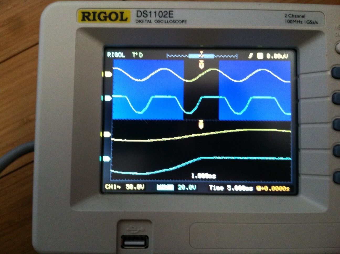

Is this is a problem what I observe on my oscilloscope or it will work?
OP's images:
That scope signal doesn't make sense AT ALL for this circuit - assuming you indeed built the circuit exactly as the schematic drawing you posted.
The signal should make peaks at the transitions. It looks like one of the two diodes is blown, so there's light produced only for one half of the wave pulling the signal low (but apparently not completely), and the other half of the time the signal is pulled high as there is no light produced by the LED at all, and the transistor blocks.
The 8.3 ms you mention is what you expect for a half wave of a 60 Hz signal.
What voltage do you see when you connect the scope to the input pins of the H11AA1?
Can you post a picture of your setup of the H11AA1 and the connection to the scope please.
I agree with #wvmarle it looks like one of the diodes in the opto has failed.
It is really a H11AA1 as that is the sort of output you would get from a standard single LED input opto?

That's another thing indeed: the low level should be zero but is about 1/2 Vcc. That's not good either, and implying either the H11AA1 is defective, or there's another error in the circuit.
I change the H11AA1 again and now I have half wave +5V and half wave +0V. I think remarks of "cattledog" (If you can get the output voltage levels correct, you could use the device you have with a CHANGE interrupt, and pick up the zero crossings), are good and instead( attachinterrupt, RISING)to use CHANGE. See attached photo of my oscilloscope with final reading.Now it is no matter what voltage I use the readings are the same only difference is the resistors in the input of H11AA1 (at 150V max , R=15K) and(at 24V, R=2.2K). May be with constant input of 24V is more safe for the optocoupler.

Voltage now between pin1 and pin2 is 1.2V and I have short +5V picks on my oscilloscope. You are genius Tom!!! Why is this so confusing when I monitoring input wave?
Your scope probes, the gnd on each is connected together at the scope.
So when you were monitoring the input and the output of the opto, the gnds from each channel were connecting the input and the output of the opto.
So it defeated the isolation you needed to be able to see full AC at the opto input.
Tom... :slight_smile:
