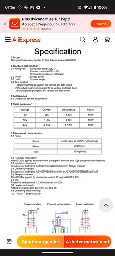

Can you provide a link to where you got the solenoids from? We need to see the spec.
Of course, here it is for the loading solenoid coil :
https://m.fr.aliexpress.com/item/32731717962.html?spm=a2g0n.order_detail.order_detail_item.2.4f367d56RSi0Hc&gatewayAdapt=glo2fra
And here for the bat coils (less details available) :

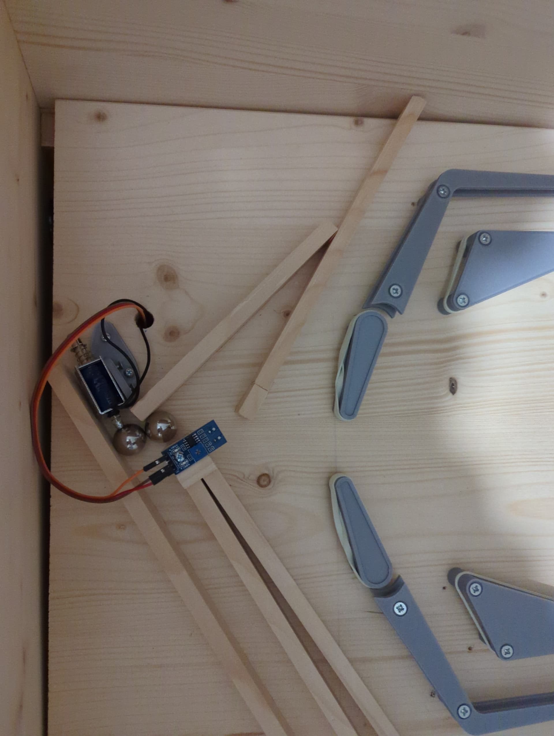

By "everything is burning", I mean I can smell the solenoid melting and also the plastic part that holds it in place.
Is it really normal for a solenoid to heat this way ? Could it be due to a lack of available current because of the other solenoids ?

There are three different solenoid voltages in that link.
Which one do you have.

No, it's not normal. I think you have a solenoid rated for a lower voltage then 24V. What you are seeing is what you would expect for a solenoid being powered with a higher voltage than it is designed for.
I have the 24V solenoid. Thanks, I'm going to try with a MOSFET :wink:
Ok thanks, good to know, even if it is a 24V solenoid (written on the component) :wink:
I really think you need to check and double check this because what you describe is what you should expect if the solenoid is rated for a lower voltage than 24V. Using a MOSFET won't make any difference, it will still be being fed with a higher voltage, and therefore current, than it is designed for.
Well, I would suspect that it's wrongly labelled. Do you have a 12V and a 6V power supply? I suggest you try it on 6V first, then 12V, and in each case see if it overheats and see if it works as expected. Just connect the solenoid across the power supply without any other components and see what it does.
