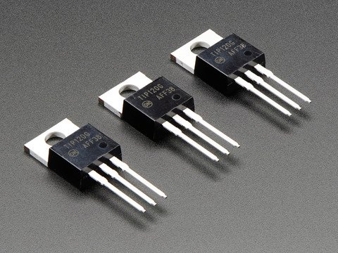

what kind of transistor should I use? Would this be ok?

It has to handle 5V and 1.1A, so this completely rules out simple BJT's which don't have
enough saturated current gain to drive 1.1A from an Arduino pin. (Saturated gain is about
10 to 20 for a single BJT).
A darlington has enough current gain, but will lose 1V or more, so will need a 6V supply or so,
and may need a small heatsink.
A logic level MOSFET with 0.3 ohms or less on-resistance will be perfectly fine.
The TIP120 from a 6V supply and with 1k base resistor would be fine, remember the Arduino 5V
rail cannot provide enough current anyway so a separate supply for the solenoid is needed.

So, if I understand, TPJ's are these ones
right? So, We can rule them out. Ok.
I don't know much about the heatsink. How would I do it?
Hmm, ok, so bottom line I can use the TIP120? Otherwise, could you suggest me one? What would you use?

The threshold voltage is not relevant here. You need a logic-level mosfet, and the IRF3205 is not logic level.
The gate threshold is nothing at all to do with using a MOSFET as a switch, forget it, go straight to the
"on resistance" rating in the datasheet and see what value(a) of Vgs is quoted - that's the gate drive
voltage needed to turn the device on, and typically will be 4.5V for a logic-level device, or 10V for a
non-logic level device.
The threshold voltage is the point the device turns fully off, not on, and is very much less
than the Vgs needed to turn a device fully on, typically 3 or 4 times less. And also note the IRF3205
has a threshold voltage of between 2 and 4V, depending on manufacturing variations, so if
your device happens to have a turn off threshold of 4V how poor it will be at 5V.

So, I should go back to the TIP120 idea? As you (MarkT) were saying here:
