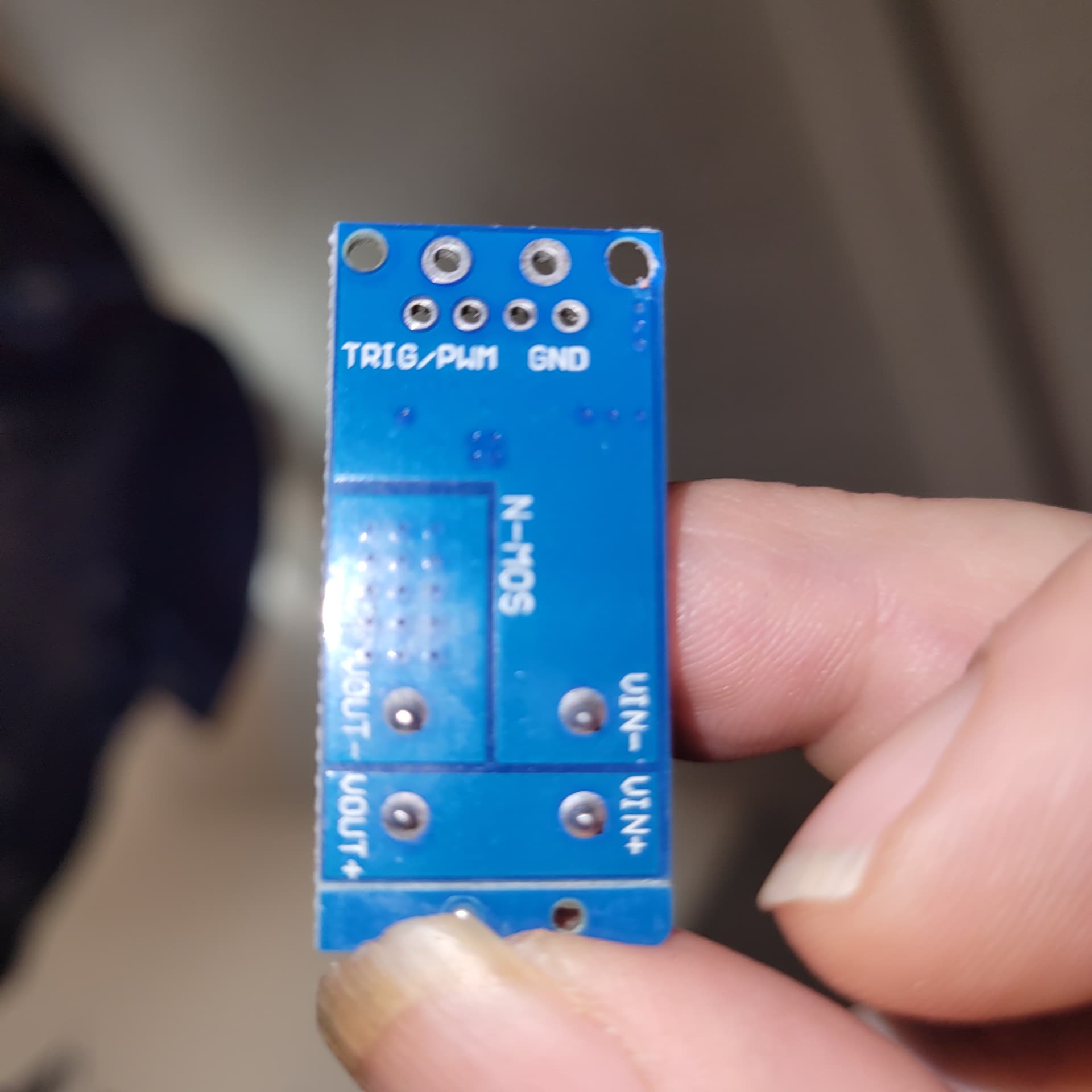

Does it make sense to exchange my 12v car injector signal for 5v signal, using one of these Mosfet switching boards? (to Nano.)
12v signal will be the trigger, and running 5 volts through the switch. (Those voltages are well within the specs of the switching board.)
The board is rated at 15a (max 30a) which is kind of high, I think.
(My fuel injectors are not connected. [I'm using the injector signal to meter fuel through another method.] Thus there should be no spike in the 12v)

The MOSFET input signal has a max of 20V, and even a really really narrow spike will burn it out

Well, @sterretje already suggested a transistor and that should be fine. A bipolar NPN transistor like a 2N3904 costs under 50 cents and is pretty rugged. It will work fine to translate the 12V signal into a pull-down at the arduino pin with less impact on the driving circuit than an optocoupler. Hope this is legible: it's from a previous project with a similar need. Ignore everything besides the transistor and the base resistor :slight_smile:

but why does the input and output (across the "switch") require both, positive AND negative wires (dc in my case)?
Couldn't it just manipulate the positive one?
(Especially in my use here; a brushed motor going one direction)

I mean the VIN that is being switched.
Not the trigger.
The problem is I want control the duty pulses on three separate units.
I want to run 1 wire to each of the three units,
and ground each '-' coming out of the loads, to chasis.
I'm just confused why the mosfet requires both + and - of the dc.....or does it?

Any signal needs a return path.
One pin of J1 goes to the gate of the MOSFET, the other one comes back from the source of the MOSFET and provides the return path for the first one. Those need to be connected to your 12V.
Note: I do not know which pin on J1 is what; reversing the two pins might result in a damaged Arduino. So you will have to find the schematic of your module to be able to check.
OUT+ is connected to the drain of the MOSFET and will go to your Arduino input; you can use an external pull-up resistor or use the internal pull-up resistor. OUT- is connected to the source of the MOSFET and will go to the Arduino GND; this will complete the return path for OUT+.

The thing I really dont understand is why there is two trigger (holes) and 2 ground (holes).
Edit: watching a video, the + (blue block) goes straight through the board.
There goes my idea.
But cant I just run my 12v+ through the MOSFET?
Then I could use chassis for ground?
You will have to measure with a multimeter or find the schematic. This looks very much like your module: https://www.robotics.org.za/XY-MOS?search=mosfet. There is unfortunately no schematic but it shows how it should be connected. Based on that, it's just for convenience.
Ah yes, exactly. Another video shows 2 small holes and one big hole are all conected.
