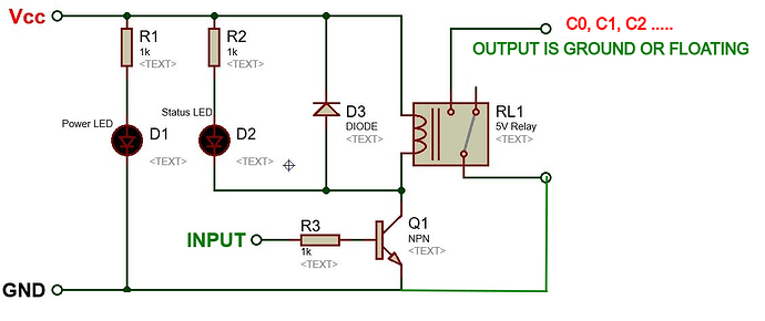

Yes, your schematic is not showing which signal is closing the contact.
The relay circuit is something like this:
That's completely correct.
The relay is closed by a manual button, or by a high signal from Arduino via Optocoupler and relay, or by a hardware contact on the railway, ...
It doesn't matter in my inital question.
Matter! Because we need understand the context to give a good answer.

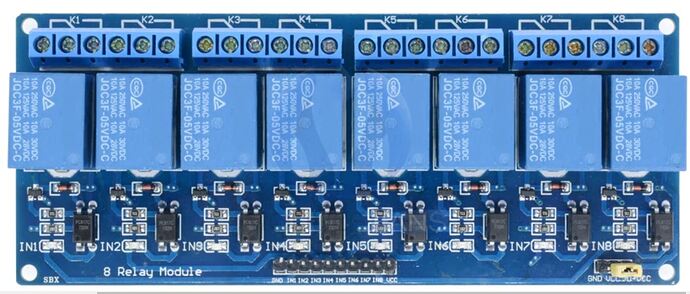

Another question.
I use the Mux CD74HC4067 also to set a 16 port relay module for 100 milliseconds. The relay is used to set the turnouts with 15v AC.
I use the function below and it's working.

Do you have a data sheet (or link to) for the relay board/module?
Here is a part of the shematic, (without ARduino)
Mux VCC is coming from Arduino
Relay VCC = 15v AC coming from other supply

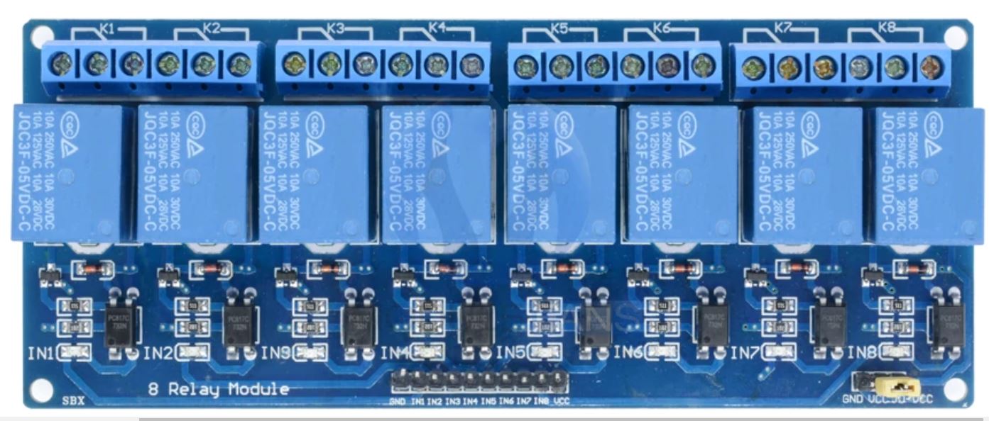

I use this kind of Relay boards
or
On the relay board are optocouplers.
In fact the relais is just used to set the turnout left or right with 15V AC.
