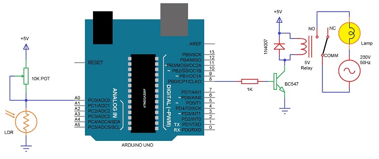

I have some problems in controlling relay using Arduino. I am using Some electronics to switch ON/OFF the relay. I use circuit from the following link.
I am using the following code to control the relay.
int relay = 8;
  pinMode(relay, OUTPUT);
  digitalWrite(relay, HIGH);
  digitalWrite(relay, LOW);
I have 5V relay.The relay is not switching as per the code given above. I am connecting Arduino to PC Via USB cable. I also tried connecting the battery to power relay coil(If there is not enough current supplied from the USB) What am I doing wrong?

I presume you are using the output circuit in this image?

I am uploading the images. You can see the connections on the breadboard. The RED and Green Wires parelllel to the diode is connected to the relay. Second image is my relay connections.
@TomGeorge.. Yes that is the correct image
https://i.imgur.com/dJmGXj7g.jpg
Your diode is the wrong way around, the end with the white strip is the cathode and it should go to the positive side of the relay coil, the other end of the diode to the transistor collector side of the relay coil.

Relay itself says 6V, not 5V.
Connect the relay to your power supply directly, you should hear it clicking (or at least using your multimeter you can see whether contacts are made and broken).
Yes now the things are working!! :slight_smile: :slight_smile:
The relay is switching from USB supply of Arduino.
