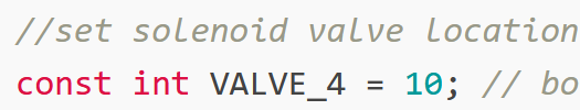

Hello all,

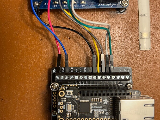

I am currently working on a precision irrigation project. The microcontroller I am using is the Feather M0 Express along with the Adafruit Ethernet FeatherWing, both stacked on the TermBlock FeatherWing terminal board. In short the whole system opens or closes solenoid irrigation valves via a relay board that is prompted to turn on or off by low soil moisture values picked up by Teros 12 soil moisture sensors. I have written three functions that work as expected independently from each other:
getSensorData : takes a reading from Teros 12 sensor and returns a float, volumetric water content(VWC).
activate_solenoid : uses a VWC reading and set parameters to turn on and off a specific relay valve.
data_to_adafruitIO : sends data to adafruitIO feed via ethernet.
the getSensorData and activate_solenoid functions work together as expected. When incorporating the data_to_adafruitIO function, the activate_solenoid function stops turning on and off the relay valve. the function still follows the same logic as before, but the digitalWrite(Valve, LOW) does not turn on the relay valve. through testing it seems that when the IO.run() function is included in the sketch, this behavior repeats. I am at a loss as to why the inclusion of this function would be affecting the digitalWrite() in activate_solenoid. The IO.run() function is necessary to maintain connection to the adafruitIO feed, so I am trying to figure out the cause of this bug and if I can work around it. thanks for your time, my code is as follows:

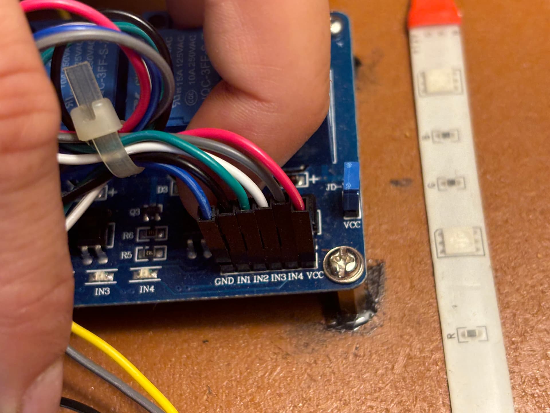

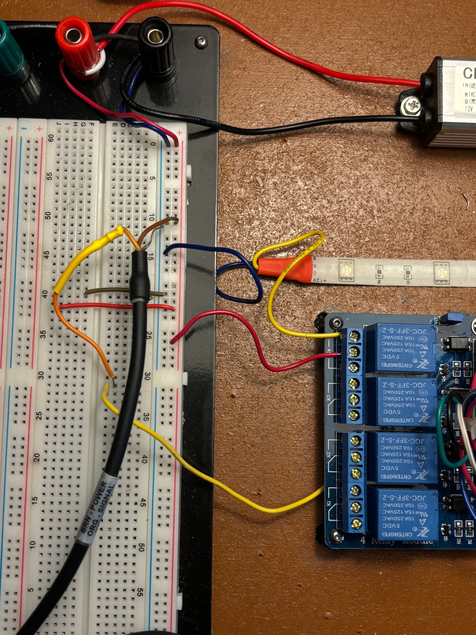

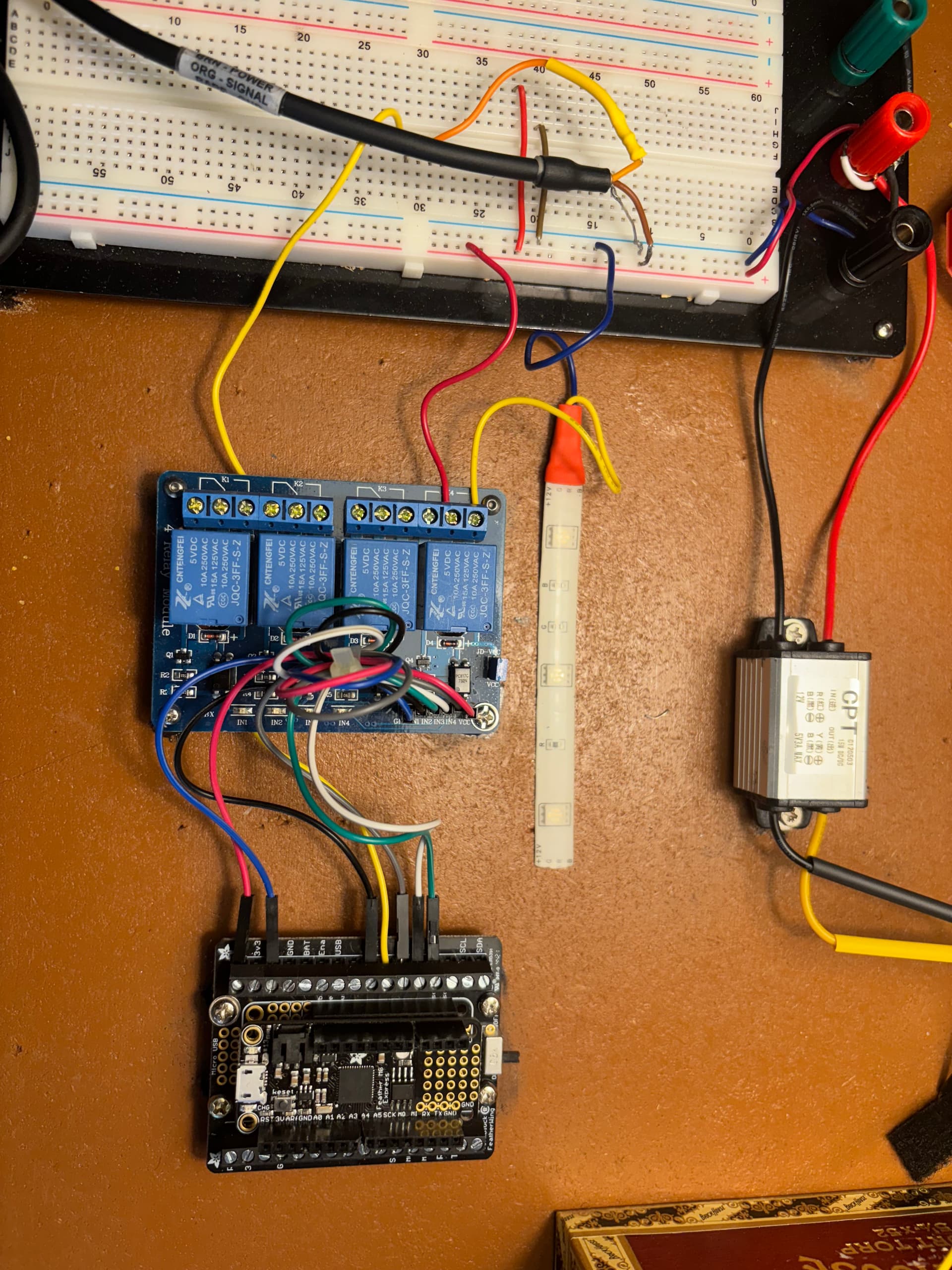

@LarryD here is the system diagram and layout along with links to component hardware:
This is a wiring diagram of the site installation:
B2 Microcontroller Circuit 1.2 .pdf (2.3 MB)
These images are of the twin set up we are currently using for troubleshooting:
Sensors and relay are powered by 12 V power source.
components:
Relay Module
Feather M0 Express
Ethernet Board
Teros 12 Soil Moisture Sensor
  • Those relays have 5v coils.
  • Those relay modules will need 5v drivers connected to IN1 thru IN4.
  • You will need an external 5v power supply for the relays.
  • Have not looked at the code yet.
  • Not your hardware but your connections will be similar to those in the schematic below.
Or
Is there a conflict with the use of pin 10?
The module has a transistor to drive the coil
This solved it! Pin 10 was the issue. The Ethernet FeatherWing was indeed using pin 10 for Chip Select. We moved the wire connected to the problem relay to the to pin 5 and it fixed it. Thank you!!!
