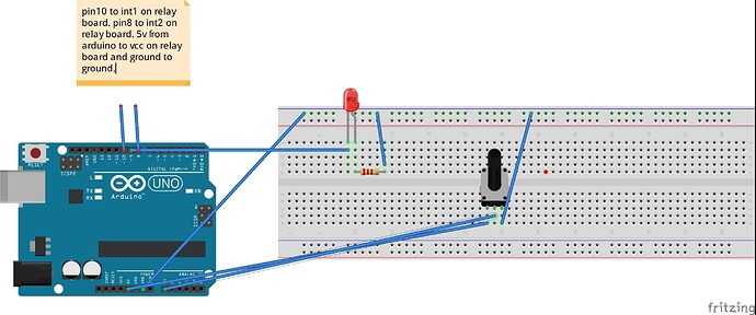

Forgot to add the wiring as well.
siimrikas:
It doesn't include the relay board. Please direct us to some information about it. A simple pencil sketch or cell phone image of the setup would be fine. The point is to include all the details. A little post-it note about the connections to the relay board is not good enough.
Sorry, I don't have any sort of manuals or anything else about it, but I added an ebay link where I bought a few of them.
The relays have a little led on board that indicates if the relay is on or off. If it's off the centre pin on the relay and the left pin are connected. If the relay is on, the centre and right hand pin are connected (the on-board led is on ) so it pretty much has a normally closed and normally open function.
http://www.ebay.com/itm/4-Four-Channel-Relay-Module-DC-5V-Optocoupler-For-Arduino-PIC-ARM-AVR-DSP-W-/221504398421?hash=item3392b0e455:g:~cEAAOSwxH1T0iRe
The board is probably using reverse logic on the input pins. Try setting both pins to HIGH, I'll bet the relays turn off.

Changed the pins to HIGH and works great now.
Thank you so much. Wouldn't have figured this out myself :slight_smile:
