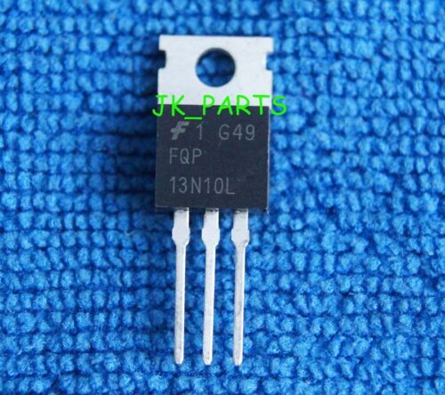

Here are 2 types of MOSFETS, both are logic level, in the end of the post I have 2 questions about them.
N-chanel MOSFET :
P-chanel MOSFET :
https://www.ebay.com/itm/10-x-RFP10P03L-Logic-Level-P-Channel-Power-MOSFET-TO-220-30V-10A/184022255709?hash=item2ad894c85d:g:IxsAAOSwaTtdwBKc
I will probably play with both MOSFETS, in order to learn by action what is the difference in their configuration in a circuit.
  1. both are rated 100v, is this the maximum voltage that it accepts ? so 12V is no problem ? or it needs a high voltage to function, and 12v might not be enough ?
  2. the threshold is min 1v, max 2v, what does it mean ? the arduino sends 5v in HIGH, will it be ok ?

For the arduino start with and become familiar with N-Channel MOSFETs, they are much easier to interface to Start with a Logic Level Avalanche Rated FET. Package etc depends on your preferences. For only a few use the high amp devices they will run cool and save you a heat sink. For LEDs 2N7002 work nicely. Connect the source to ground, the gate to the arduino pin (you can use 50 Ohm or less if you like in series) with a 10K pull down resistor at the gate. The 10K keeps the MOSFET off when the arduino is in reset The drain goes to your load which has its other end connected to the + voltage, can be 3V 5V 12V etc depending on the FET. In all the examples you see MOSFETs connected to motors, with a diode across the motor, this diode is not needed with the avalanche rated MOSFETs. Look at this link for some ideas. http://www.irf.com/product-info/datasheets/data/irlz44n.pdf Here is another link that well help: https://www.quora.com/What-amount-of-voltage-is-required-to-switch-MOSFET

The "standard" circuit:
For a two-terminal device, you use a logic-level N-channel MOSFET - far easier to come by and much more practical than the additional complexity (and cost) of a high-side driver. :grinning:
