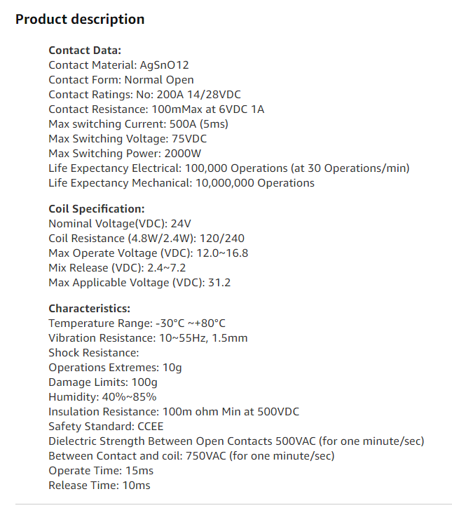

This may help, from another "supplier";
Surprisingly an Amazon product with a spec sheet!!!!!!
