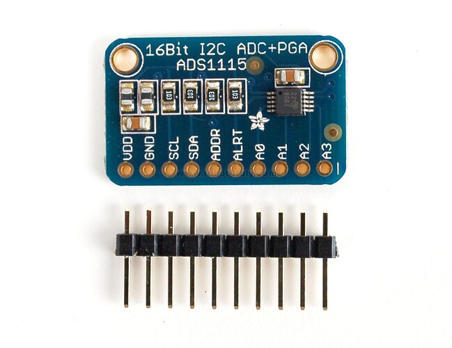

How reliable are this types of connectors (male part show on image) compared to ICs in a socket over time?
It's bad connection that worry me.

As long as there's no wiggling of the connectors going on, those contacts will be quite durable. If the device is subject to a lot of movement and shaking etc., I'd consider something like the JST XT series.
It really depends on the environment the board will be in (temperature, dirt, moisture) and if the female header has gold plated connectors.
The crimping is of utmost importance.
Female connectors I have crimped have never failed, however, all have been inside clean environments.
The PCB which the female connector is attached to, will be inside a box mounted on a wall. So movements are not my concern.
The box is sealed but can be opened (to operate the keypad). So moisture is what concerns me. The box will be inside a non-insulated room near the sea.

Why are you using this type of connector? Do you expect to need to replace the ads1115 board? If not, it would be more reliable to simply solder the pin headers into a PCB/stripboard/protoboard.
That is why I ask. All the ICs are mounted in sockets so I thought maybe use this kind of connector on this modules.
I have thought about soldering them directly to the PCB.

If you don't solder to the board, be sure to NOT mix gold and tin contacts. Either both gold or both tin.
If you are near salt water I would suggest some conformal coating. I like silicone spray but if not available, GE II silicone calk at home depot (or eq) is usable. DO NOT get the type I which smells like vinegar as it cures.
Not sure what you're measuring but near salt water you must watch every connection, especially if you are expecting any type of accuracy.

I'm using IP66 boxes and only water-proof connectors so I hope I do not have to use coating.
Maybe I put together a small PCB, connect it to power and leave next to the box (and fully exposed for the environment) and see what happens with it during the autumn/winter period where the weather is most likely to cause damages.
I've seen a lot of the male parts (as shown in your post) that are gold plated. I've not seen any female contacts plated in gold, although they can be purchased through a distributor (digikey or mouser etc).
Your test board is a good idea. You should make sure it is powered while in your test box. Power makes a big difference when corrosion is of concern.
