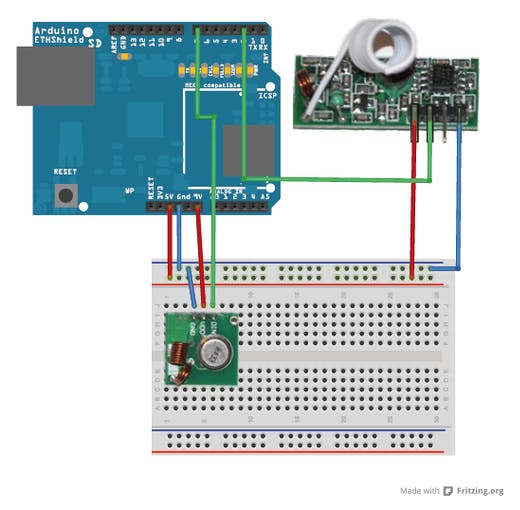

The wiring of the components is fairly easy
Receiver:
The GND Pin(-) of the receiver must be connected to the GND Pin(-) of the Arduino. The VCC Pin(+5V) of the receiver must be connected to the+5V Pin of the Arduino. The Data Pin of the receiver must be connected to the Pin2 (Interrupt 0) of the Arduino.
Transmitter:
The GND Pin(-) of the transmitter must be connected to the GND Pin(-) of the Arduino. The VCC Pin(+) of the transmitter must be connected to the +9V Pin or Vin of the Arduino. The Data Pin of the transmitter must be connected to the Pin 7 of the Arduino.

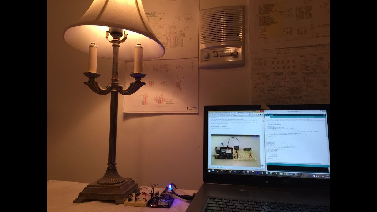

Yun Light Set up?
To setup of the Yun Light, we just need to connect the power cord of table light to 433MHz power outlet as show below:
