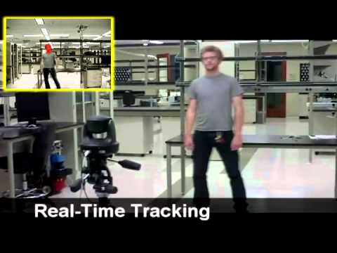

basically I want something like this:
(relevant part starts @ 0:55)
or this
