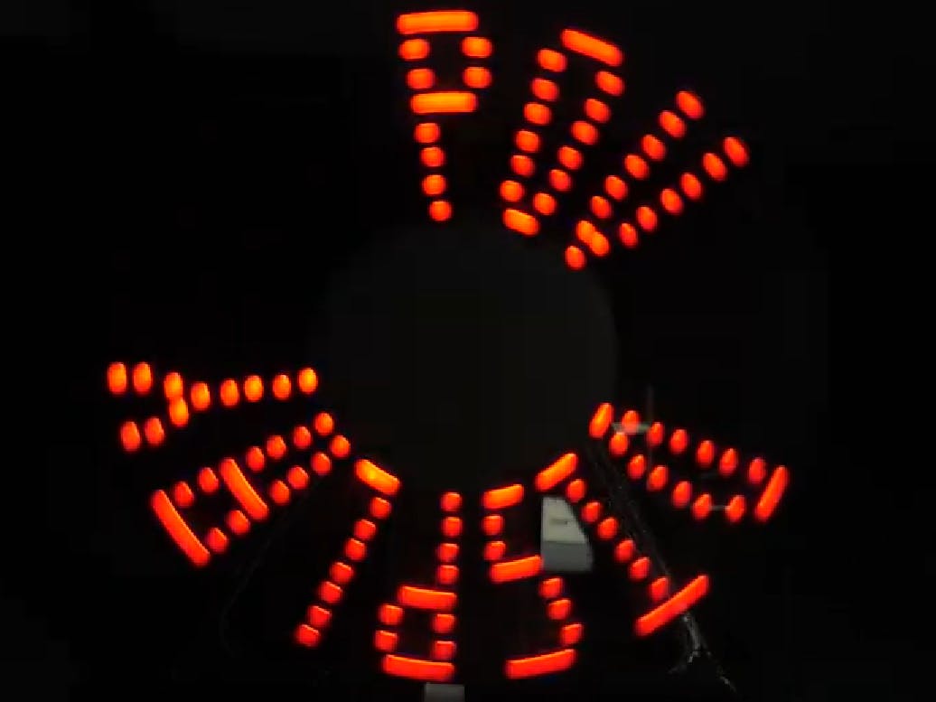

Hi, i would like to do this project: Persistence of Vision (PoV) Display Using Arduino - Hackster.io
But i need to replace the battery on the mobile part and find a way to use it with a power supply...
Is it possible?
Thank you.

It looks like a standard 9v battery so any 9v DC power supply should be fine.
If that does not answer your question you will need to provide more information.
...R
I want it on the moving part of the project... Wires can't be used, i need a brush system... Can't find it on ebay or amazon.
elbico:
Why didn't you say so.
It should not be difficult to make your own from some plastic tubing, brass tubing and brass strip that should be available from hobby suppliers.
...R
Thanks to all of you, i think a found a solution with your hints.

Sounds like you could buy a slipring.

I will use a slip ring.
