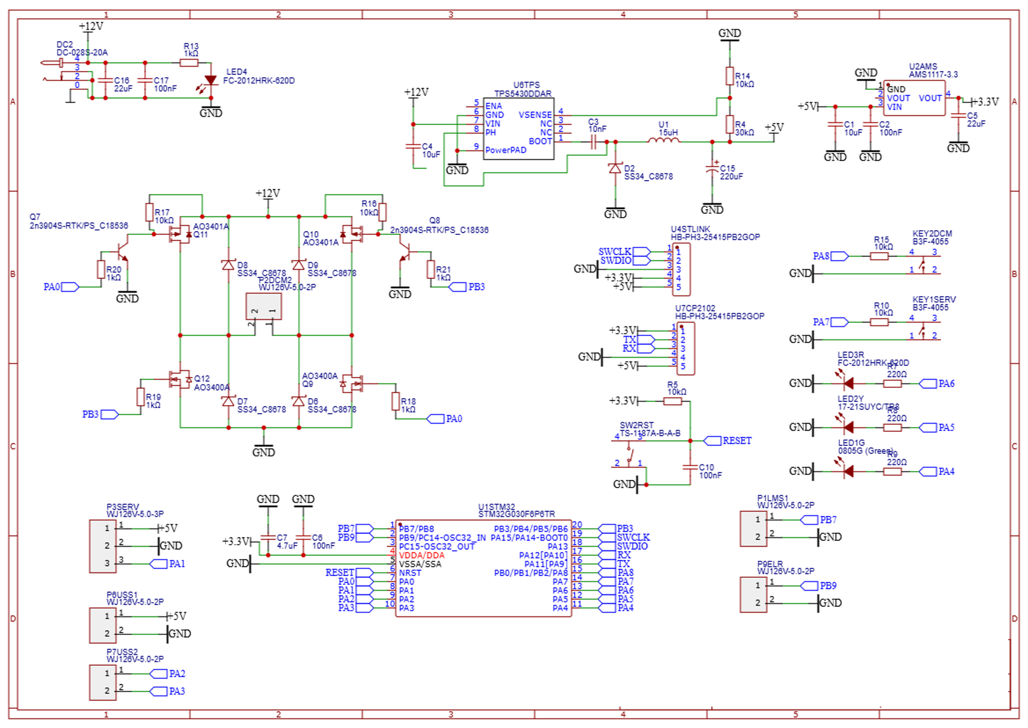

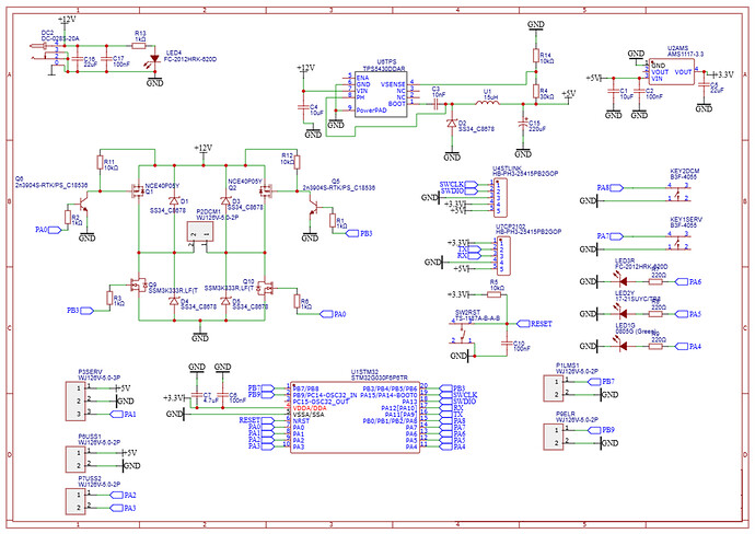

Hello everyone,
I’ve been working on designing and testing my PCB, making some adjustments along the way after encountering a few issues (and even burning a few boards!).
I’m hoping this version will finally work as intended, but I’d greatly appreciate it if you could take a look at my schematic and provide any feedback. If you notice anything wrong or think there’s room for improvement, your input would mean a lot to me!
Thank you in advance for your help!
  • R15 and R10 are not needed.
  • Your MOSFET Vgs(max) is 12V.
    You are too close to this limit.
Generally, a schematic review is a good thing, but irrelevant to the PCB until you’ve done a PCB layout.
The sch is of no consequence, but the pcb is directly a result of the sch.
Hello LarryD,
Thank you for your message and your valuable comments.
Regarding the resistors, I noticed that many Arduino schematics I find online
include resistors for buttons, but I understand they may not be necessary for the STM32. I’ve also updated all the MOSFETs to models with at least a 20V Vgs rating, so I hope this setup will work as expected.
Once again, I sincerely appreciate your feedback and guidance.

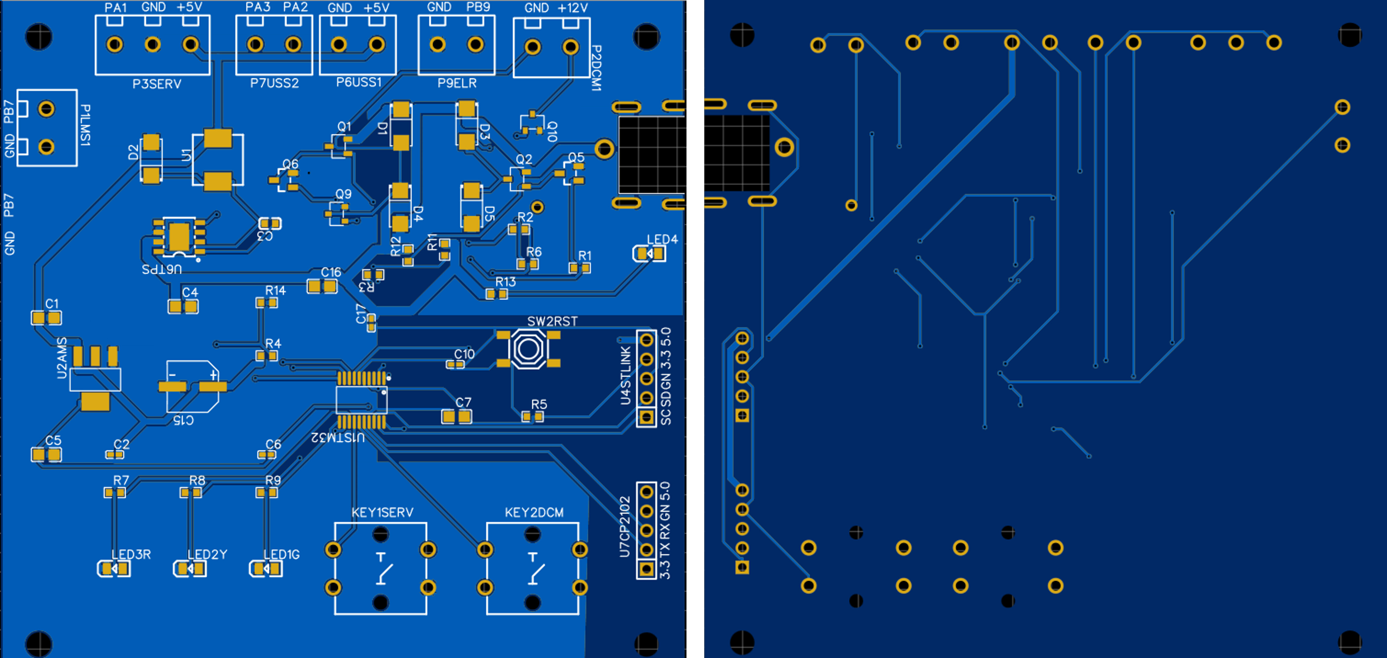

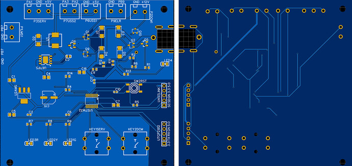

Hello everyone!
I'm designing my first fully functioning PCB and would greatly appreciate your help reviewing my PCB layout. This board is based on the STM32 microcontroller and includes buttons, LEDs, motor drivers and so on as you can see. I'm hoping to catch any potential issues before moving to production, as this is an important step for me, and thank you so much for your feedback in advance!!

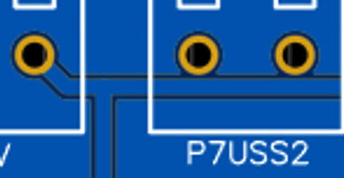

I would change:
  • 90° angles.
  • thin traces.
  • mounting holes should be connected to ground (via).
  • increase the distance between tracks. traces close to vias/pads.
  • fill/polygon should be connected to ground.
  • use thermal relief pads.
About the use and connection, it would be desirable to have all connectors placed by 'type'. You are using 5 times the same connectors, that might be problematic.
I dont get why you have connectors by mcu port name. I would add a label (X axis, or somthing like that).
Also, motor connectors are weird. Some have ground+port, some have 2 ports. You even added labels where there are no connectors. PSUSS2? P9ELR? What is that?
I would change the position of all those connectors. And make all those connectors different. Or at least use a usefull label .
Also, key2 is too close to the pin connector, make you sure you can press the buttom without damaging the conector.

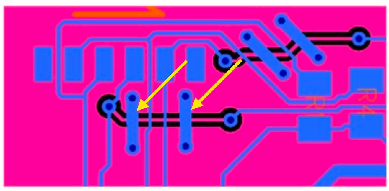

  • Widen traces, spread tight areas.
  • Increase Via diameters.
  • Your cross-unders are very long. Try harder to get them on the top.
    Add top straps for return current over these gaps.
    Remove the component side GND pour and add it to the bottom side.
Example

90° increase parasitic effects like inductance.
I know, most of the times this won't change anything, but is better to use 45° angles every single time. You get use to eventually.
Wider traces and increasing distances between tracks does the same.
  • I thought this too but the theory that electrons in a high-speed signal are unable to make right-angle turns has been debunked.
  • Maybe we need to worry at 10GHz speed or microwave designs.
    I do like 45° or rounded corners for aesthetics.
Thnx, seen this 90° advice before, now I know why.
Good, because I've always designed more 45° than 90°
Oh! VERY MUCH that.
This is ridiculous and probably dangerous, just from an assembly PoV - you have plenty of space; use it!
You don't need the resistance R5. The STM32G030F6 datasheet (page 64-65) shows that NRST pin has a internal pull-up resistor. Only connect the capacitor and the push button.
According to TPS5430 datasheet (page 17), they mention that
For any TPS5430 design, start with an R1 value of 10 kΩ. R2 is then 3.24 kΩ.
So I would choose R4 = 10k and R14 = 3.24k
For the U4STLINK connector I would add the NRST pin instead the +5V. Which STLINK debugger-programmer are you using?

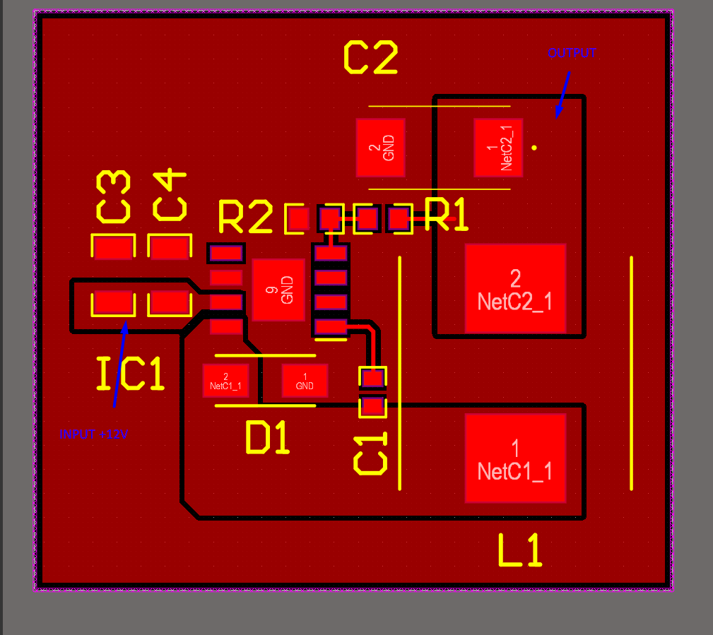

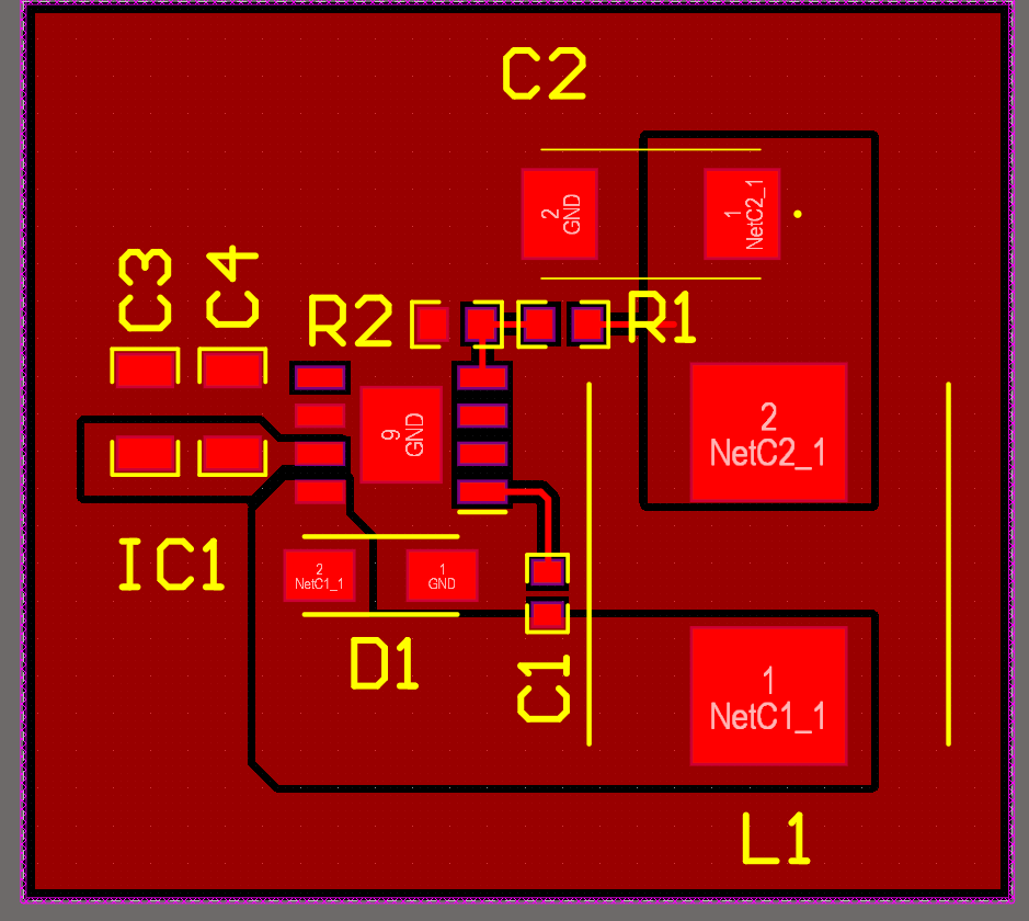

For the step down converter I would use this design

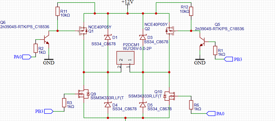

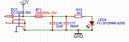

You need a fuse or similar, especially with the risk of shoot-through in that H-bridge.

Turns out I was jibbed, and now that H-bridge stuff I wrote... actually I managed to save it:
Additionally, those low side SSM3K333R is never gonna turn on fully with 3.3 V. Lowest Rds(on) datasheet list is 4.5 V.
  1. Features
    (1) 4.5-V drive
    (2) Low drain-source on-resistance
    RDS(ON) = 42 mΩ (max) (@VGS = 4.5 V)
    RDS(ON) = 28 mΩ (max) (@VGS = 10 V
SSM3K333R_datasheet
Install drain resistors for those FET's as well.
The high-side: use P-chan FET's that works with 3.3 V, use pullups from 3.3 V line and skip the BJT's.
There's probably more, but I'm not that skilled in H-bridges. YT have good videos on the topic, and there's lots of reading when you search for it.
Thank you so much for your feedback; it means a lot to me.
I will work on implementing these changes, but I have a couple of questions:
  1. Regarding the traces and spacing, here are the design rules I'm currently using (see image). Do you have any recommendations for the value?
  1. About your comment on "Key2 being too close to the pin connector," did you mean the button is too close to the U7CP2102 pin header? If so, how far apart would you recommend they be?
Once again, I truly appreciate your comments and look forward to hearing your thoughts.
Thank you for your feedback and suggestions!
  1. I see that the STM32 has a 40k internal resistor, so it doesn’t make much sense to keep R5 as a backup either. I’ll remove it.
  2. I initially thought a 30k resistor (more readily available) might work instead of 3.24k, but I realize I also had them swapped. I’ll update R4 to 10k and R14 to 3.24k as recommended in the TPS5430 datasheet.
  3. For the U4STLINK connector, I’ll add another pin for NRST while keeping the +5V as an optional backup.
  4. For the step-down converter design, I’ll review your suggestion. Do you think it might cause issues with the existing layout?
Thanks again for your valuable input!
Thank you for your feedback!
I’ve added a resettable fuse (SMD500L-16V: datasheet link) close to the barrel jack. I hope this should work well for the H-bridge as well.
