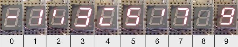

I have a problem with my LTS-546AP 7-segment display (single digit, common anode) that I use with a CD4543BE BCD decoder. I wired everything correctly (normally). By sending the corresponding bits to the desired digit on pins A, B, C and D of the decoder, I can correctly display 1, 3, 5, 7, 8 and 9, but not 2, 4 and 6. By the way, the display is inverted for these 3 digits: the leds that should be on are off and vice versa (so it "draws" a 4 for example but in leds off). I tested with two displays (same LTS-546AP component), two decoders (CD4543BE) and two Arduino cards (Uno and Mega): same result...
It's hard for us to check this part out since you haven't provided a photo but my hunch is that your problem is related to pin 1 (phase) on the CD4543BE.
Don
I checked again everything pin by pin and realized that I was using the wrong decoder pin for the Phase (I confused it with the latch). After connecting the ph to the 5V, everything went back to normal. Thank you!
