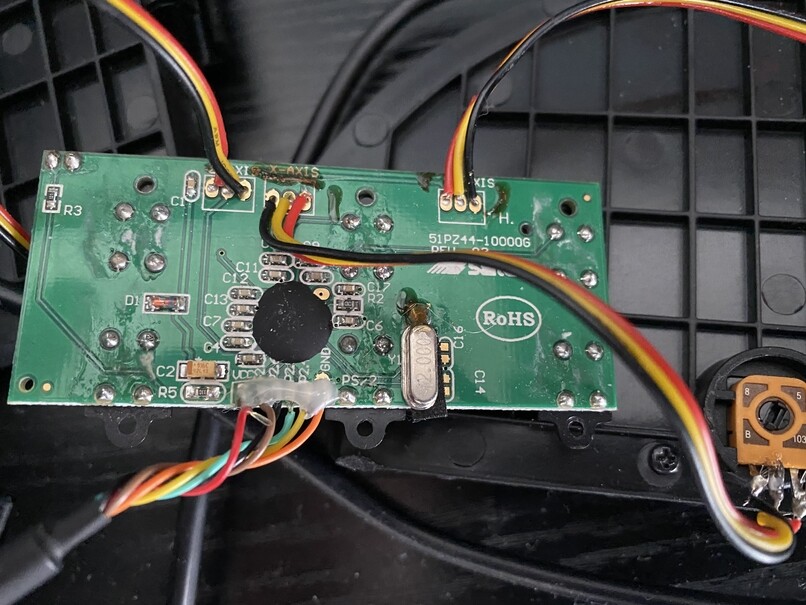

I have an old Saitek Throttle Quadrant at hand and thought I might hack it to use with an Arduino.
The challenge is, it uses a PS2 connector and a custom one I think.
I found out so far, that it isn't a standard PS2 connector, all Pins are in use.
I managed to find the power and ground connector, but there are still 4 pins left. I haven't found any documentation so far and believe that there isn't any publicly available.
I cut the cable and soldered the connections to a prototype board.
I'm not familiar with PS2 protocols or Serial protocols or whatever they are using.
Is there a way to reverse engineer the data which is sent by the throttle quadrant? And also doable for someone with little experience in that matter.

Not sure if this is still relevant to you, but I'm currently working on exactly the same thing. I've managed to reverse engineer the interface between the throttle and the yoke. I've attached my handwritten notes, maybe they are still of some use to you.
I have managed to turn the throttle into a standalone USB controller using an Arduino Leonardo. I'll share the code once I've cleaned it up a bit.
I've cleaned up the code a bit. I've used Atmel Studio and directly flashed it to the Leonardo via SPI. Unfortunately, I wasn't able to make it work using the Arduino IDE, I assume that it has something to do with the Arduino bootloader.

If you want to use my code, you can either download the source files I posted above and then customize and compile them using Atmel Studio. I've also attached a compiled .hex file suitable for flashing to the Arduino Leonardo, also using Atmel Studio (or avrdude, if you're using Linux / macOS).
As for the pin assignments, the throttle cable consists of six wires. You can either cut off the connector and hook them up to the Arduino directly, or you can use a 6-pin mini DIN connector. The pin mapping (for an Arduino Leonardo) is as follows:
miniDIN pin Wire color Purpose ATmega32U4 pin Arduino Leonardo pin
1 blue clock / SCK D1 Digital Pin 2
2 brown throttle data ready (active-low) D0 Digital Pin 3
3 red +5V
4 orange ground
5 yellow data / MISO D2 Digital Pin 0
6 green +5V
As for the calibration: Using my code, the Arduino Leonardo will show up on your PC just like a regular joystick. In fact, it will show up as the standalone USB version of the Saitek Throttle Quadrant. On Windows you can then calibrate it just like any other game controller.
