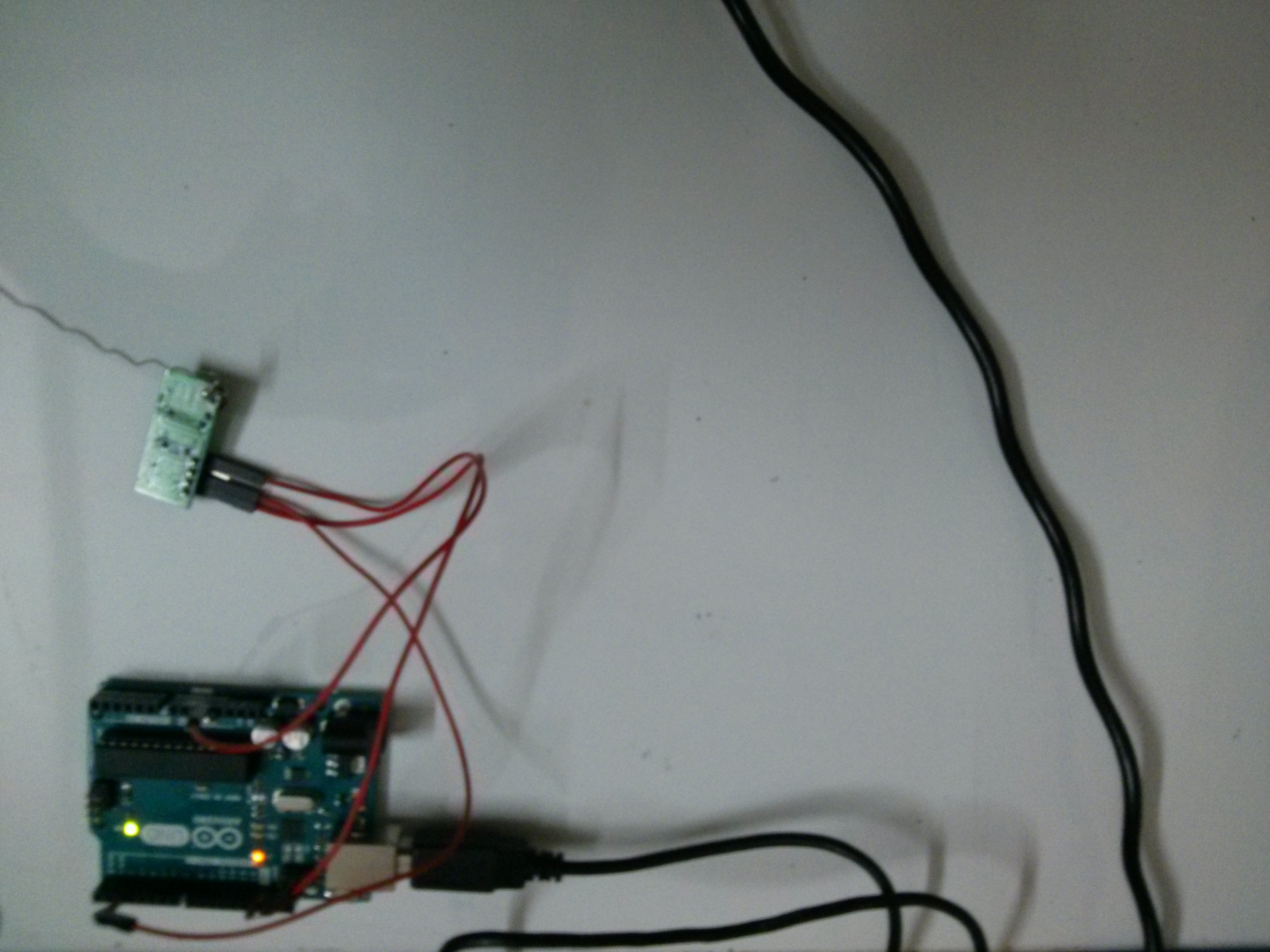

Thanks to each on of your for your response.
I have made some changes as per suggestion.
I completely removed bread board and now connecting to arduino using jumber wires as can been in the attached picture.
Antenna is now soldered to the RX ANT pin directly.
Vcc from RX is connecting to 5V of arduino
DATA is connecting to PIN 2
GND from RX is connecting to GND of Arduino.
My arduino is powered by USB from Laptop.
I am still not getting the range. It works only when I bring my remote very close to RX (around 2-3 CM).
Could it be a problem due to my laptop?
It may be that either the transmitter or the receiver is incorrectly tuned. You could try tweaking the receiver coil for maximum signal.
Is it possible there is some external RF interference? Have you tried moving the whole project to a different location?
