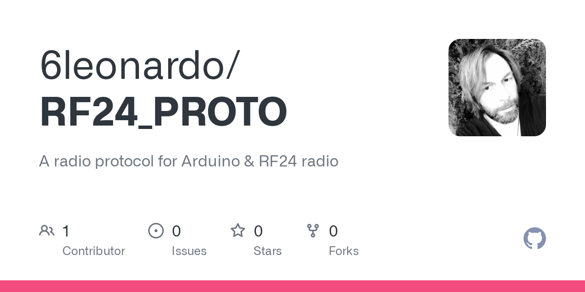

I'm looking for someone to try the library I'm writing about a Master + Slaves communication protocol with Arduino and RF24 ...
Try to use it to understand what functions need to be integrated and how to improve it ... maybe even to collaborate on development .... :slight_smile:

roto is a library that allows you to replicate registers (which can be variables or copies of analog / digital input / output) from an arduino to all the others that create a network using RF24
In the network an arduino carries out the task of master while all the others of slaves ... Each node has a name and an address (autoconfiguring address through the master that always listens on a fixed configuration address and configures the addresses of the new cards) .
The slaves, when they present themselves to the Master, also list all the registers configured on the slave, so that the master and the other slaves can know the new variables that will enter the network. Each register has an address, a name and other features such as the type of register.
The registers can be updated on the master and therefore on all the other slaves whenever their value changes or through a polling by the master, the updating method can be configured register by register ....
Furthermore for the output registers if written by the master towards a slave, in addition to updating the register automatically, an event is triggered (via callback) which allows the slave to update any output signals of arduino ....
the library is all in a file that is compiled both on arduino and esp32 ..
All the communication is hidden in the library so whoever found himself using this library must not send and / or receive any message through RF24 but everything will be automatic, on each arduino you will find a database of registers that will be automatically applied to the other nodes of the network ...

Sorry... but may be for the english...may be because is not so easy to explain something... I have some problem to explain how it works ....
In my library I call this variables, Devices... but I know this is another frequent used word....
here an example....
you must create some devices that can be input or output devices...like here....
Device temperature{Input,AnalogFloat,0,0,"Temp1"};
Device humidity{Input,AnalogFloat,0,0,"Hum1"};
Device level{Input,AnalogInt16,0,0,"Level1"};
this devices are not field devices connected to arduino but they replicate the values of some sensor connected to arduino or they can be some variable that you want to replicate on the all nodes of the network....
After you have create an instance of the class proto as here
Proto slave1(radio,"Slave1",10,5,false);
and you have added the devices to proto
slave1.deviceIndex.addDevice(temperature);
slave1.deviceIndex.addDevice(humidity);
slave1.deviceIndex.addDevice(level);
the proto will send the values of local devices to all node of the network ....
and the instance of proto slave1 will receive the values of all devices of all other nodes of the network ....
so you can have local and remote sensor values on the arduino board and you can command output of remote arduino boards....
