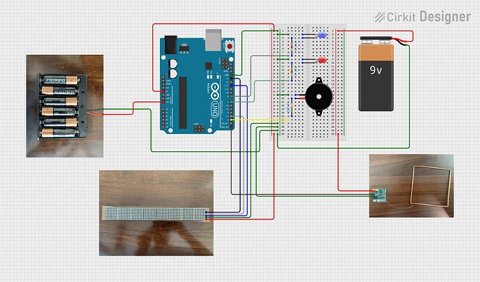

Hey there, I could use some troubleshooting help with this. I have a build that uses an Arduino Nano, two led's, a piezo buzzer, an 8x64 Dot Matrix LED Display Module, and a 134.2K AGV RFID Reader. This is the type of RFID reader for animal microchips and I'm using it on a build that interacts with my dogs. More for a personal POC to see what I can do with it.
My issue is that the RFID Reader range drops in half when the dot matrix is connected. So basically, without the Dot Matrix, the range on my reader is great, exactly what I need. If I turn it off, plug in the Dot Matrix, everything works as expected, but the range cuts down significantly.
This is my first more-complex build with more than one power supply, but I'm thinking this is because there's a drop in current to the RFID Reader, right? I'm confused why that would happen when they don't share the same power supply as the RFID Reader is on its own 9v battery, while everything else is on the 5v power supply from the microcontroller. I've looked all over for why this might be happening, but can't seem to figure it out, so I thought I would reach out to the community for help.
Thanks, y'all. Below is a schematic I made with some of the more obscure pieces pasted in as photos. The RFID reader and Dot matrix are both linked above for reference.

Get you DVM out and begin to measure voltages and current draw as you change things.
Better dont use the 5V output of the Arduino board as the power supply for the led matrix. I also doubt the 9V battery will last long; it's better to use a power supply that can source more current. I best that rfid module is pretty inefficient and as a result can probably draw a surprisingly high (momentary) current.
How close is the display to the reader? You may be getting RF interference from the display. The scan rate is in the audio range, but the sharp current pulses driving the LEDs could be a problem. The MAX7219 data sheet suggests bypassing the power with 10uf and 0.1uf capacitors. The first is for the bulk power and the second may help with RF. I have never seen these on the common cheap displays.
As noted above, the 9 volt battery will not last long with the 120ma current draw of the reader. It would be better to get another 6xAA battery holder like you are using on the Arduino.
That LED display can pull upwards of 2A at max brightness with all LEDs let. You're NOT going to be able to run that off AA batteries. Get a REAL AC/DC power supply. I like these:
I get them from Jameco for $22 each. They really make a difference when powering your projects. I added an ammeter:
and matching 2.1x5.5mm plugs and jacks so everything just snaps together.
2_1x5mm
You're also going to need an isolation switch in the USB RED wire. This will prevent your project from trying to power up your computer via the USB port if you turn on your project before the computer,
Would a Schottky diode be an acceptable substitute for a switch?
If you put in a blocking diode you'll lose .7V (instead of 5.0V, you get 4.3V) when powered by the USB port. This can cause some devices to get silly.
I 3D printed a box and used a $2 SPDT toggle switch.
Apparently you have not looked! :thinking:
See that capacitor in the bottom left ? That i s the 0.1 µF on every module. No, they don't have the 10 µF on the FC-16 modules as they do on the old ones.
Not if you want to light up many LEDs. A completely lit (8 by 8) matrix would be about 320 mA and the regulator on the UNO would almost certainly shut down. Let alone eight matrices as madmark mentions.
Which devices?
The diode is exactly what the Nano uses. Mind you, it is supposed to be a Schottky.
IR receiver for one is very fussy about supply voltages. Different devices react differently and can kick in and out, dynamically altering the load. A relay, for instance can chatter when it kicks in it loads down the PS to the point where it drops out, the load goes away and the PS recovers only to repeat the cycle.
Yes RFID readers can be prone to interference from many sources. Basically they are a low frequency radio receivers and so by definition are trying to pick up the sort of interference your are generating by the Dot matrix multiplexing.
You need good supply decoupling on the power input to your RFID reader for a start see http://www.thebox.myzen.co.uk/Tutorial/De-coupling.html
Maybe even use the schematics with inductors. The other thing is you must keep your display well away from your coil antenna.
I used to design RFID readers for a living so I know how much interference can deafen your RFID receiving of signals. We could always get a great range on the bench with the micro controller doing the decoding was separated from the coil. But the marketing lads always wanted a compact reader which inevitably meant putting the coil round the electronics which drastically reduced the range. So what you are seeing is only to be expected.
The other thing is that you could change your display to one that didn't produce so much interference. Like an LCD or the ultimate in lack of emissions is the ePaper display Electronic paper, because they only produce emissions when they change what is being displayed so any interference they cause is only temporary.
There are a variety of these available like this one. inky phat
I ended up doing just this. I tried distancing the dot matrix from the antenna, but still didn't get the range I wanted, so I switched my display to a classic 16x2 LCD display, which is fine for now. Thanks for the help!
