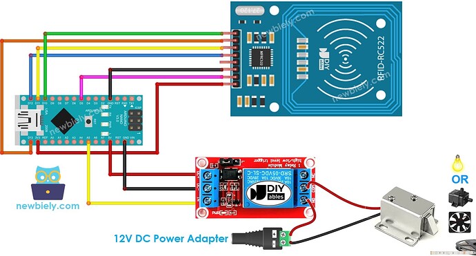

Hello,
I have a strange problem and i hope you can help me.
I am building an RFID card reader that opens a solenoid lock with an arduino nano ESP32.
The code is working perfectly when i don't plug the solenoid on the 5V relay NO and COM.
However as soon as i plug the wire on the NO and COM my RFID reader stops working after 1 to 3 reads (depends)
Do you have an idea what is causing the issue ? i was thinking of electromagnetic interference of the solenoid..
Below you will find my wiring and my code
I tried to simplify the code to just reading the correct NUID and i have the same behaviour. So i think this is an hardware issue.
my power source is DC 12V/1A for the solenoid and USB-C cable plug on a phone charger for the arduino Nano
I also read those different topics and tried the different response without success :
RFID reader stops working as soon as relay is engaged
important note for the wiring, i am not using the same 5v relay as in picture but this one :
Capture d'écran 2024-05-18 193357
also i use an ARDUINO nano esp32 so relay is plug on the VBUS and not 5V

thank you for your help
  • First off the solenoid should have a reversed biased kickback diode across its coil.
Do you think this is the reason ?
Should I follow the diagram you gave here :
Flyback diode required for relay board and 12v solenoid?
you are very active by the way :smiley: thanks for helping all of us
Just a little nit of a nag. Your schematic does not reflect the components that you describe. You use an ESP32 but the schematic shows a Nano. The relay module in the schematics is totally different from the relay module in the image.
It might not be that relevant for this project but correct schematics are important.
