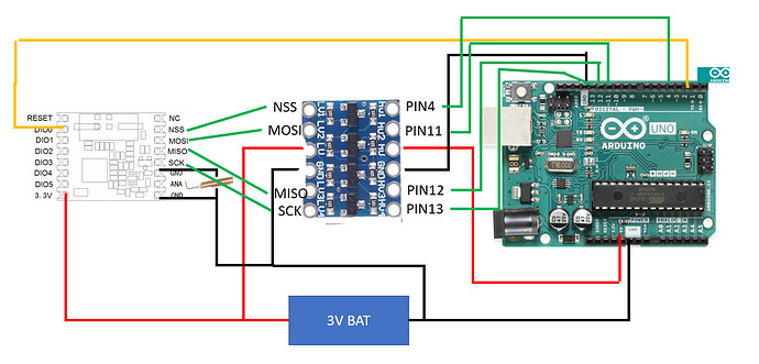

Hi Arduino Users,
I have communication problem between two Arduino Uno boards using RF69MHW (RFM69HW-433S2 modules.
DataSheet of RFM69HW: https://www.pollin.de/productdownloads/D810800D.PDF
Target Setup:
Extract from the datasheet:

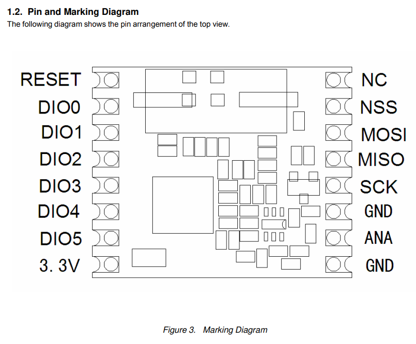

  • How to connect the ground pins of RFM69HW?
  • what about the NC Pin? Do I need to connect it also to Ground?
My Source Code is using RadioHead library. I am using the same source code as attached here:
https://learn.adafruit.com/adafruit-feather-32u4-radio-with-rfm69hcw-module/using-the-rfm69-radio
My assumption is that the issue is somewhere in the Target setup.

What's the weird schematic. This connection is completely wrong and can even fry the module or arduino. Did you use the logic level converter as voltage converter for power lines?
How the module and Arduino communicate with each other - you do not have a single signal line connected. To communicate with the module, the SPI bus is used; the MOSI MISO and SCK pins on the module are intended for this - all of them are not used in the diagram.
Additionnally, this tutorial and code
is not for the module from your picture

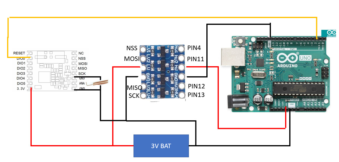

I hope the following scematic is more precise
It looks like...
But the source code from your link is not for your module.
