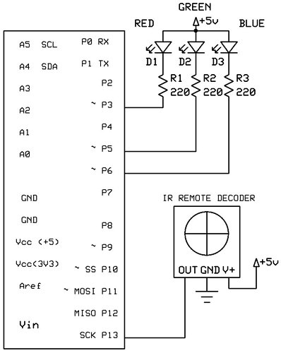

RGB LED controlled using IR Remote
The code that you posted is written for the old version (< 3.0) of the IRremote library. What version do you have installed?

Version 3.3.0 installed for the IRremote library

Since you have the latest version of the IRremote library installed you will need to modify your code to work with the new version. The IRremote library github page has instructions.
That is the picture of the circuit
#include "IRremote.h" //include the library

Would this code work in the latest version?
No. It will not.
IrReceiver; //create a new instance of receiver
decode_results results;
Those lines do not belong with the new version.
The code below does work. It is basically your code updated to the new version of the IRremote library with the magic numbers removed and written in my style. You will need to replace the key codes with the ones for your remote. The new version returns key codes differently from the old one. Run this code, press a key and note the value, then replace the value in the code. This code has been successfully tested on my setup (see below). Note that this code is formatted and posted properly in code tags.

With a few changes and the addition of toggling the LED full on and off with the power key.
