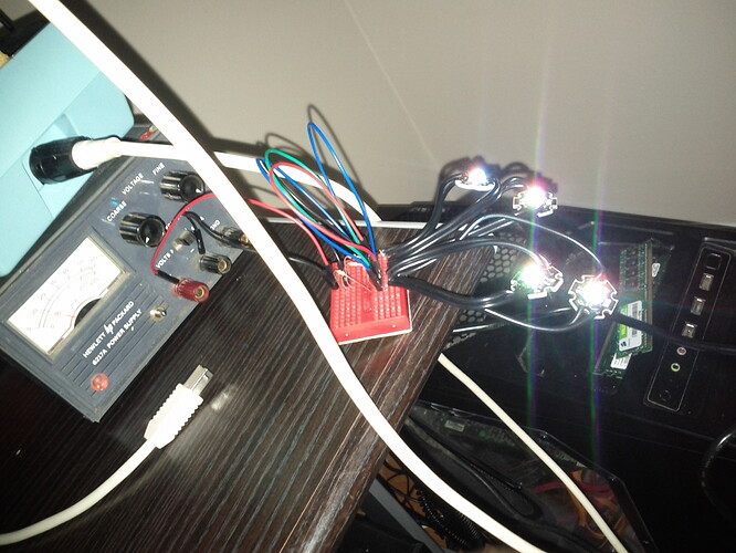

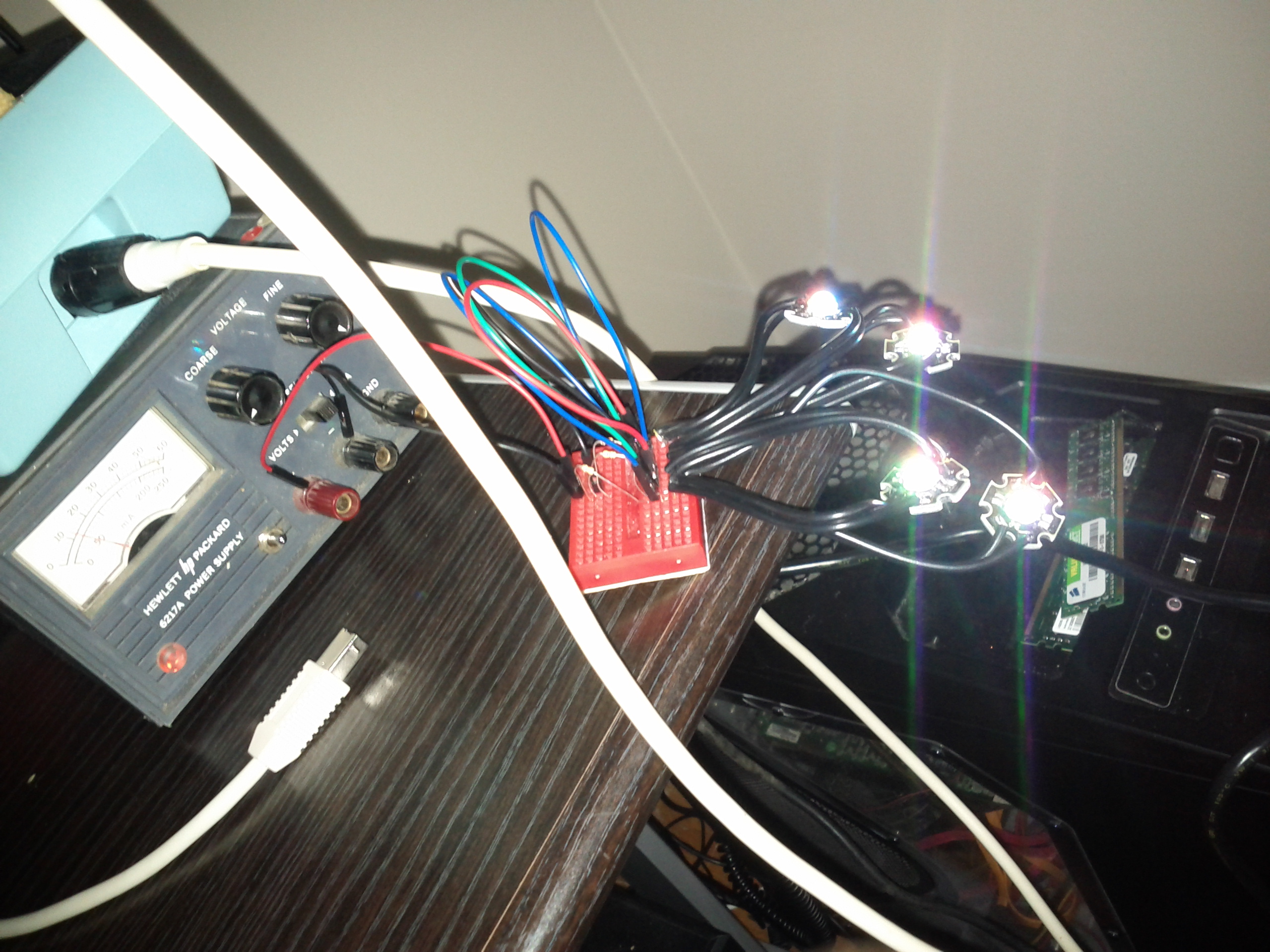

I soldered all of my 12 LED stars up with wires now, and tested each one, and did some test running 4x at once.
used 3 330 ohm 1/4w resistors powering the 3 RGB channels. Very bright now, but only running up to 5v 250mA for all 3 channels. Really excited now to see their full potential.
Also one thing to note! These are common anode LED stars, they're mislabelled. That means I'm not using an NPN transistor any longer, but a? PNP I think?
Attached is a picture of 4 stars breadboarded in with 3 330 ohm 1/4w resistors.

This are common anode LED stars, they're mislabelled. That means I'm not using an NPN transistor any longer, but a? PNP I think?
No common anode RGB LEDs need to use a NPN to switch them on and off.
It is common cathodes where you need a PNP.
