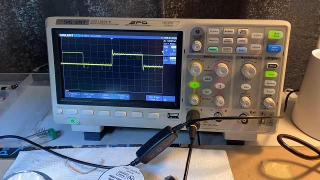

The issue is the RGB strip simply does not light up. Using an oscilloscope, I can see the voltage fluctuate between 0V and 3.3V on the data line, so it's not like it's completely flat at 0V as if I had a short. However, compared to a working unit, the faulty units all exhibit the same characteristic where the data signal is highly compressed time-wise.
Here is the scope display for the working units (from breadboard, and the 1 working unit I made with the perf board, they all look similar):
And then here is what the scope display looks like for all the faulty units:
Note the axes are identical - same sampling rate, same voltage. Like I said, I'm brand new to electronics, so maybe I'm misinterpreting what the scope is saying - but it looks to me like the signal is still there, but highly compressed time wise. Why would that be, though?

Find out what is different. The design is surely good. Assemblying it, something went wrong.
Could be soldering or wiring. 2814F leds are not so well documented, are you sure 3V3 is good for signal? Long wiring?
Popup blocker blocks your screencasts. Is it possible you have different data lengths, may be many LEDs on the one side, one LED on the short one? Data burst for a 3-colour LED would be 24 bits at 800 kHz, or about 30 uS, multiply that for the number of LEDs in your string; that assumes timing similar to the WS2812B/D, of course. Haven't played with a WS2814F, so things may be different.
And yes, verify that a 3.3V signal is sufficient for that LED string.
