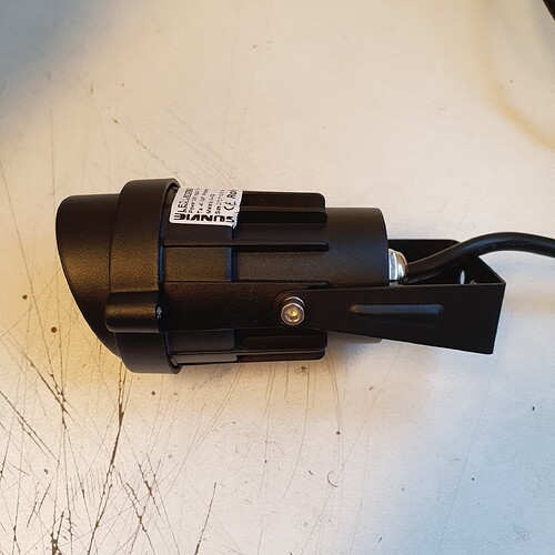

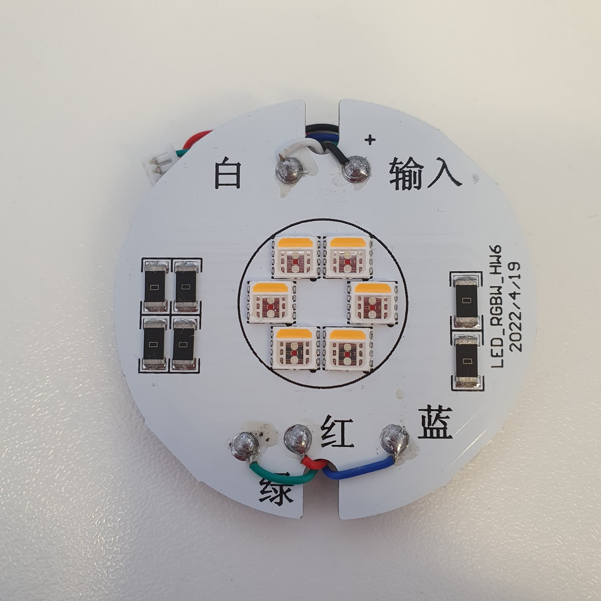

Now I am trying to control these RGBW Spotlight from Sunvie. Each Spotlight has a built in PCB and 6 x RGBW leds. The circuit can be supplied with 12-24 V AC or DC.
When I measure the voltage going through the wires for each color when only that color is on full, it's only 6,25 V DC.
Does this mean I should only supply the MOSFET with about 6V?

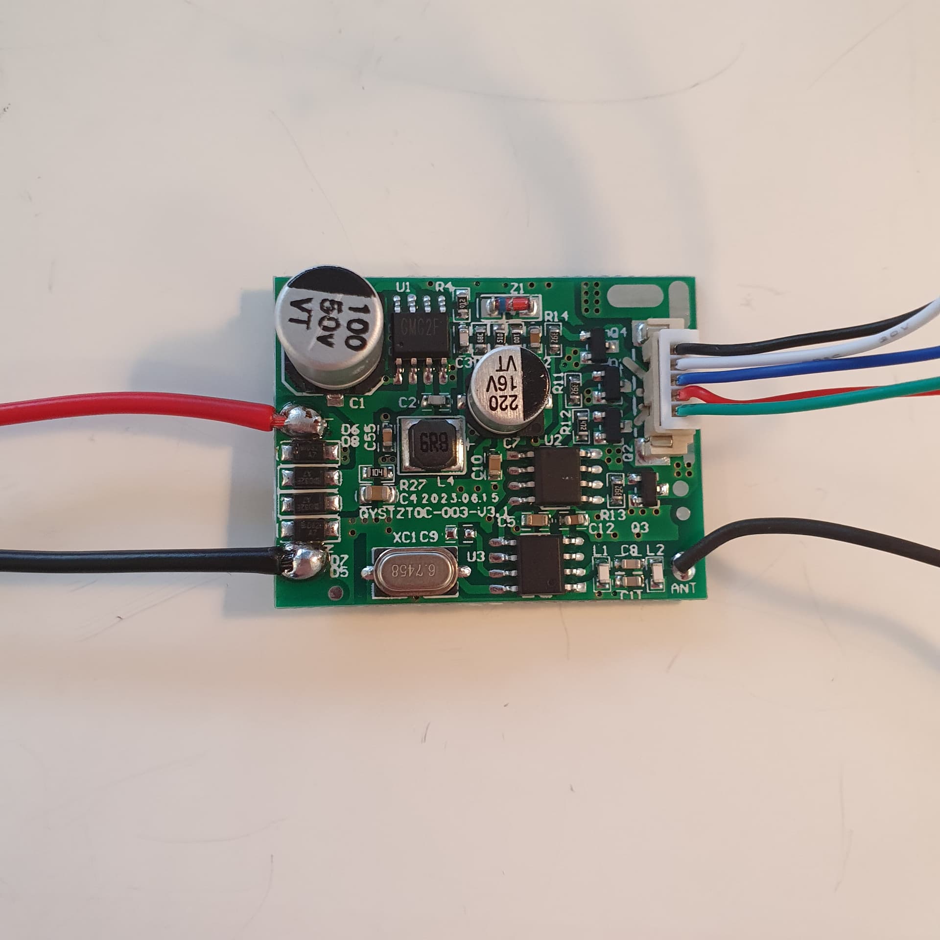

Top left chip (GMG 2F): Voltage regulator. Outputs 6,25 V DC on pin 3 (pin 4 =Ground)
Top right chip: 5V logic PWM outputs to Mosfets in full color mode:
White LED: 4,98 V / Red LED: 4,21 V / Green LED: 4,67 V / Blue LED: 4,67 V
Y1 N-Channel Mosfets: Between the PWM chip and the Gate pin of the Mosfets. there is a resistor. For White, Green and Blue : 3,9K For Red: 4,7 K
LED's on the other PCB: 6 X 5054 2W RGBW LEDs in parallel.
Forward Voltage: Red: 2,0-2,4 / Green: 2,8-3,2 / Blue: 3,0-3,4 / White: 2,8-3,4

I don't know what all the parts do in the circuit, but I am guessing the bottom chip with the x-tal is the micro controller, taking input from the remote control, and relling the chip above to control the RGBW channels according to the program: strobe / blend / color by with a specific voltage on each pin, I am guessing with PWM.

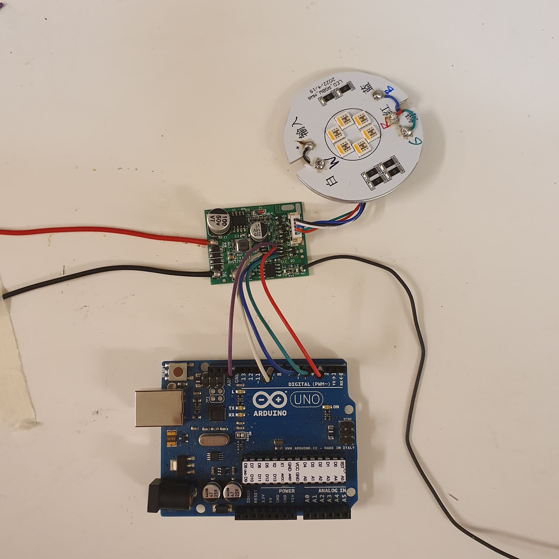

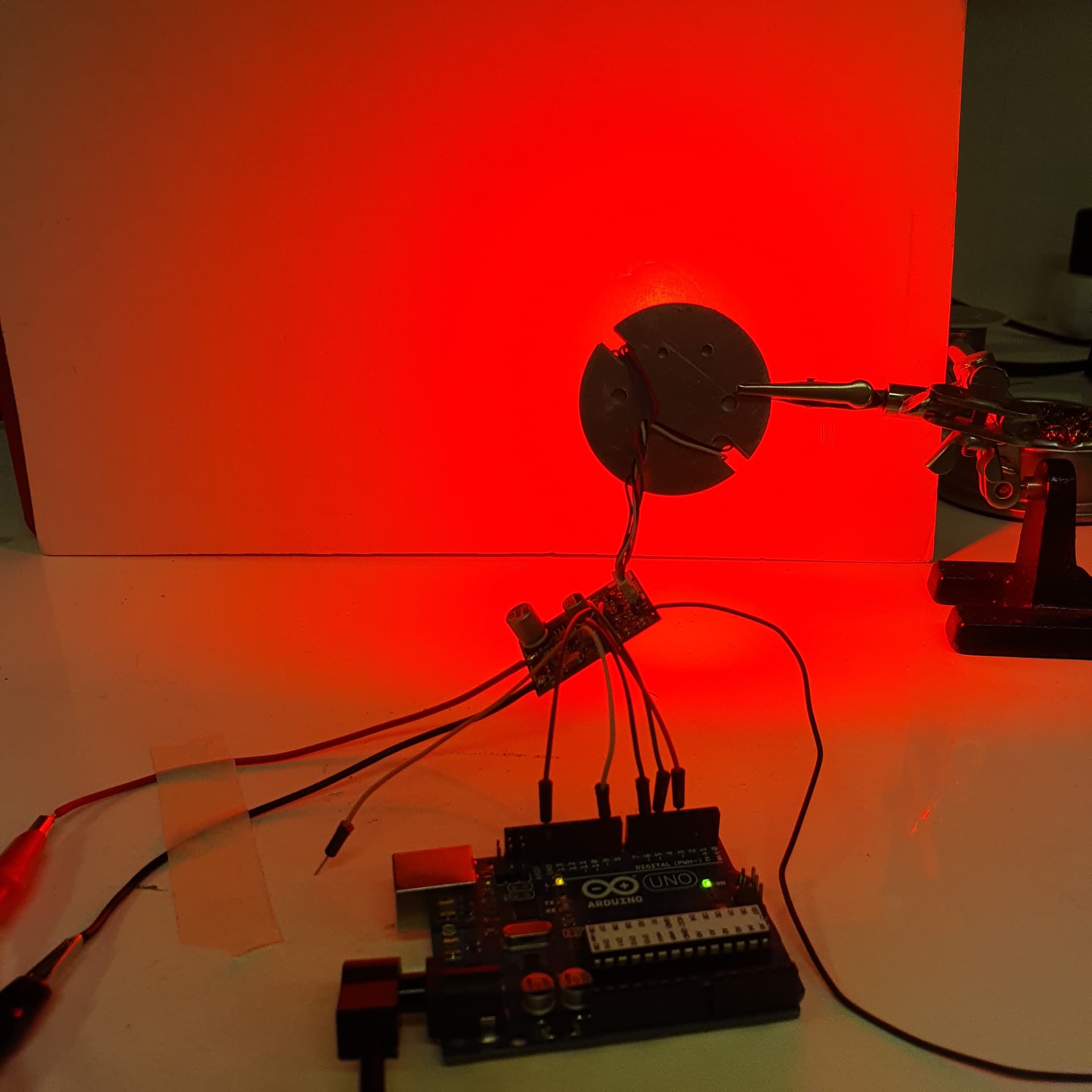

I am now hoping I can desolder that chip, and connect the 4 output pins for each color to PWM pins on the Arduino :slight_smile:
It's worth a try anyway
The 6.7458 MHz crystal is for a reference clock for some 433.92 MHz [ISM band] transmitters and receivers so the chip it is wired to is probably the receiver for the remote. There may be another chip that is the microcontroller rather than the chip associated with the crystal if that has any affect on finding which chip to remove.

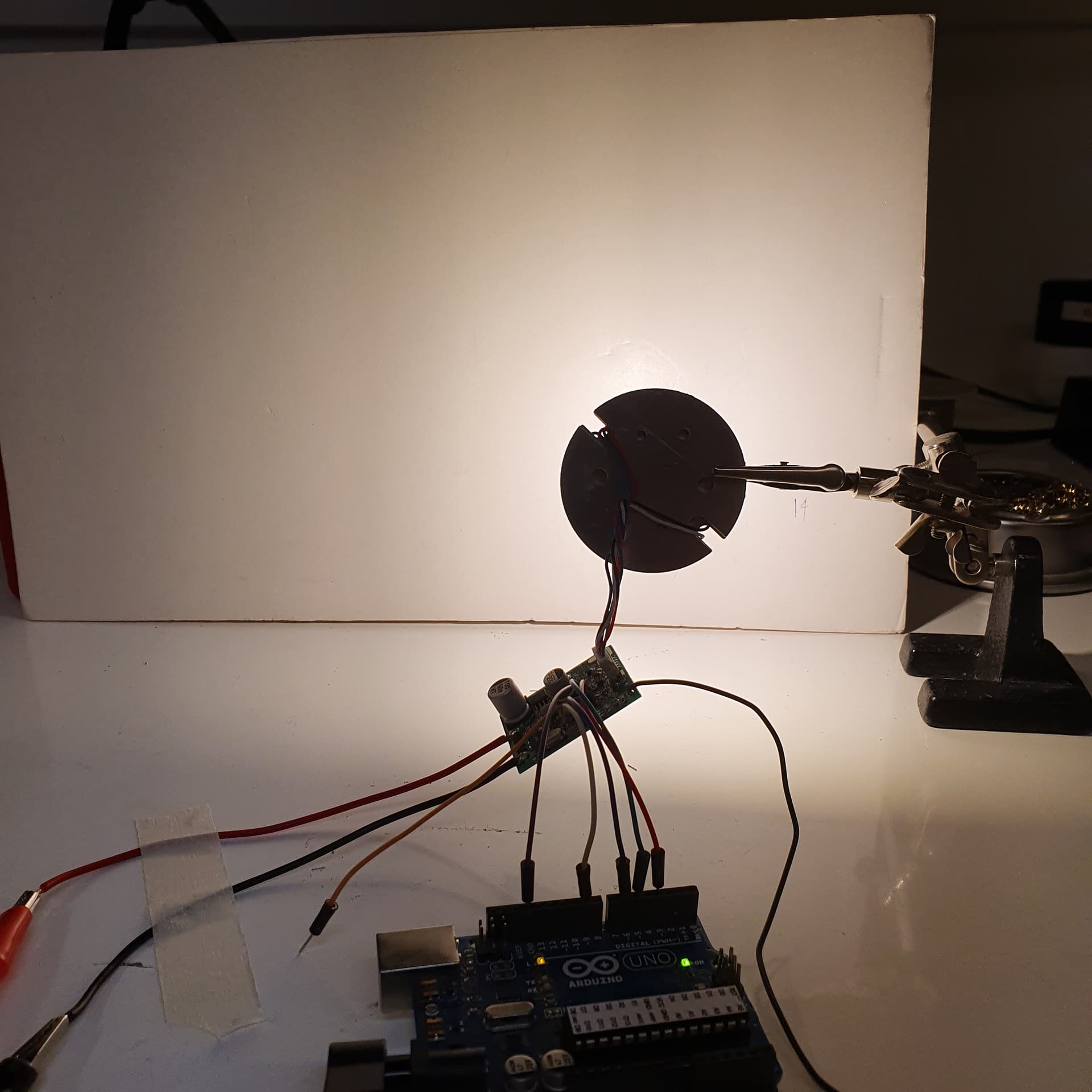

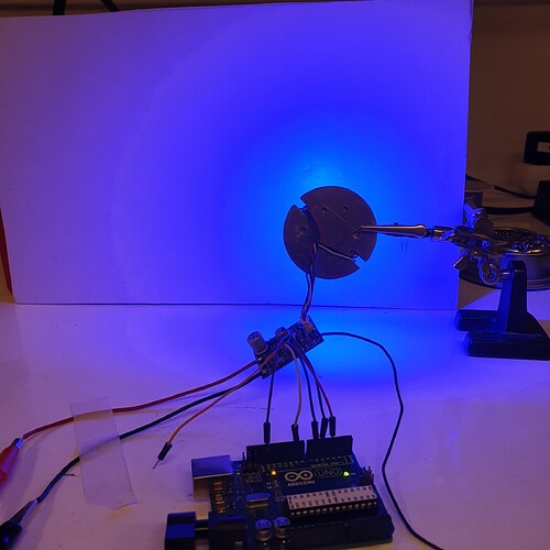

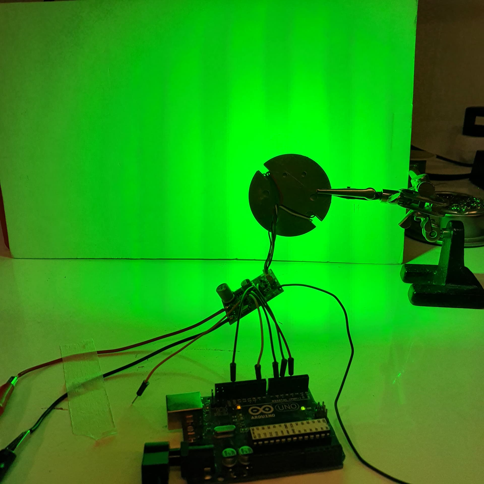

That worked great.
Removed the U2-chip, and soldered wires to the 4 pads that goes to the Gate pin on the Mosfets through a resistor, and a wire to Ground. Connected them to 4 PWM pins on the Arduino, and now I can control / dim them with PWM.
To stick with the voltages I read on the U2-chip when each color is on max, the Red has max 215, Blue and Green 240 and White 254
