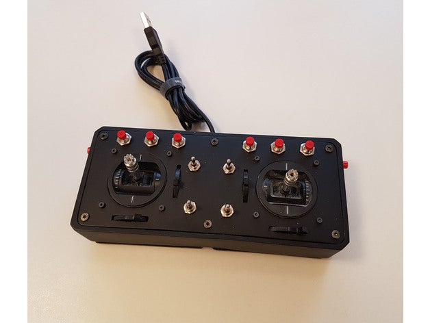

I'm making a game controller and have before successfully used the incredible Leobodnar boards, like the BU0846 and the BBI-64. On these it's abreeze to connect buttons, pots, rotary encoders, joysticks etc.
My goal now is to replace the Leobodnar BU0846 with an Arduino Pro Micro and have done this quite successfully. Buttons are connected in a matrix and multiple buttons can be pressed simultaneously without the need for extra resistors or diodes using the excellent keypad.h library. I use joystick.h library to setup the controller and everything works as it should, right now it seems to be as good as the BU0846.
Now to the problem. I'd like to add rotary encoders and possibly also rotary switches, most important is the rotary encoder though. I've searched for suitable libraries but haven't been very successful. The kind of rotary switch I have and want to use only has three pins, inputs 1 & 2 and ground. I've tried some code I've found but according to the serial output it doesn't work very well.
Preferably I'd like to find a library that makes coding a breeze but anything to help me is aprreciated of course. :slight_smile:
