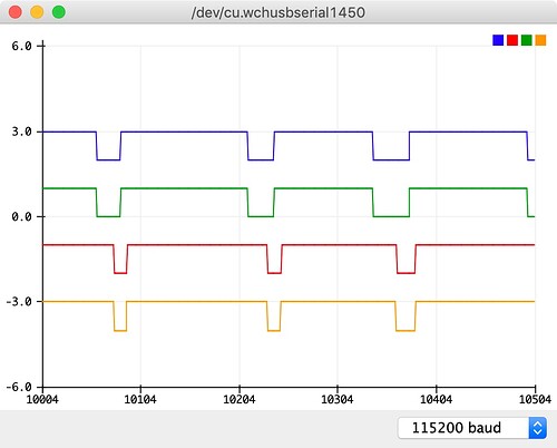

Second: This one is a real head scratcher. I couldn't understand why my interrupt based rotary encoder code was reading very strange result (bouncing back and forth), so I wrote a simple plotter program and plugged both clk and dt into analog pins, then plotted their outputs. Very clean square waves that look exactly as expected. So I put them back onto the digital pins, and did the same, and got the same result. very clean state transitions with no bouncing in state. So then I wrote another plotter to log the value of the clk and dt pin in the loop, as well as separately in the interrupt for clk. This is where things got weird.
When I have the clk pin configured as an interrupt, and the dt pin on any other digital pin (I tried a few... all produced the same results), if I read both pin's states in the interrupt, the dt pin is the inverse of the clk pin. always. but when both pins are read in the loop, they are as expected. what?! So I setup interrupts for both pins, and then they read correctly. Am I to believe that I can't read any of the digital input pins other than the interrupt triggering pin in the interrupt routine? I didn't see that anywhere in the documentation. Here is some code and graphs to show what I saw:
Read pin values in the clk interrupt and in the loop:
const byte clkPin = 3;
const byte dtPin = 2;
int clkPinState;
int dtPinState;
volatile int clkPinIntState;
volatile int dtPinIntState;
  pinMode(clkPin, INPUT);
  pinMode(dtPin, INPUT);
  pinMode(LED_BUILTIN, OUTPUT);
  clkPinIntState = clkPinState = digitalRead(clkPin);
  dtPinIntState = dtPinState = digitalRead(dtPin);
  attachInterrupt(digitalPinToInterrupt(clkPin), clkPinInterrupt, CHANGE);
  while (!Serial)
    delay(10);
  for (int i = 0; i < 700; i++) {
    Serial.print(clkPinState == HIGH ? "3.0" : "2.0");
    Serial.print(" ");
    Serial.print(dtPinState == HIGH ? "-1.0" : "-2.0");
    Serial.print(" ");
    Serial.print(clkPinIntState == HIGH ? "1.0" : "0");
    Serial.print(" ");
    Serial.println(dtPinIntState == HIGH ? "-3.0" : "-4.0");
  delay(10000);
void clkPinInterrupt() {
  clkPinIntState = digitalRead(clkPin);
  dtPinIntState = digitalRead(dtPin);

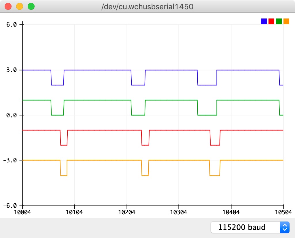

After updating the code so that clk and dt each have their own interrupts, the pin values read during the interrupt make sense:
int clkPinState;
int dtPinState;
  attachInterrupt(digitalPinToInterrupt(dtPin), dtPinInterrupt, CHANGE);
  while (!Serial)
    delay(10);
    Serial.print(" ");
    Serial.print(" ");
    Serial.print(" ");
  delay(10000);
void dtPinInterrupt() {

Ideally, I'd like to have an interrupt on the CLK pin, record the values of both CLK and DR, and set a flag, and then in the program loop when that flag is set, decode the direction that the rotary encoder moved. But since I'm getting tons of extra interrupts and I can't read the DT pin in the interrupt, I'm a little stuck. I can think of some workarounds for the latter (like waiting to check DT until the loop), but the former is a bit disconcerting.
I have read quite a few articles on debouncing switches and rotary encoders, and a lot of them implement filters on the state transitions, which make sense, but the state transitions don't appear to be bouncing around, and the pin value being read incorrectly is really weird.
I ordered a pack of resistors and capacitors, and i'll try putting a capacitor on the CLK and DT pins to ground to see if that reduces the number of interrupt triggers.
Any advice would be appreciated!
-Dan

So I came up with a software debouncing strategy that works very well. Essentially, in the interrupt I capture the state of the digital pins, set a flag, and the current time since starts. In the loop I check that that more than N milliseconds have passed since the last interrupt was triggered, before deciding that the pin states are stable.
I tried a few different values for the stability time to balance between the max time between bounces and the minimum time between legitimate changes. After a few trials and some aggressive rotary encoder spinning, 5ms seems to work very well.
I got the idea from adding timing data to the interrupts and I noticed that most of bounces happen less than 1ms apart, although occasionally a couple trailed by more time.
I'll still try adding the capacitor and see if the number of bounces that happen is reduced or not.
