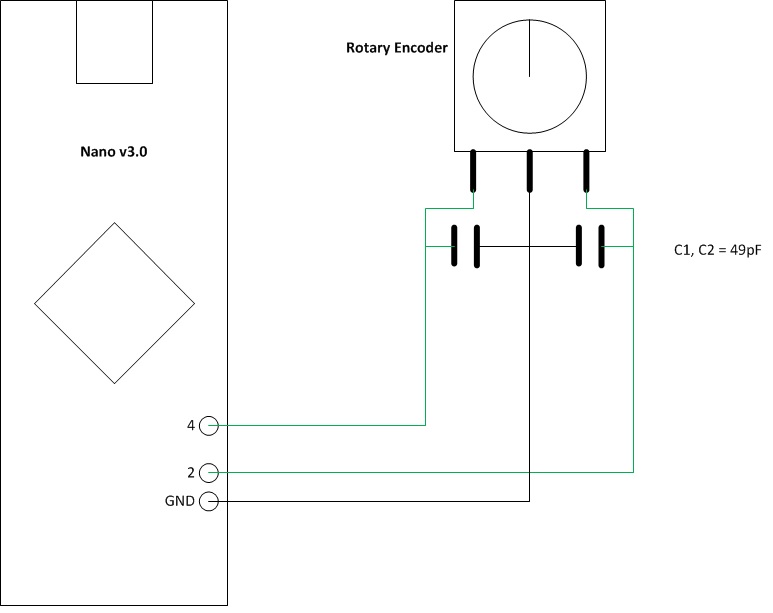

I have a rotary encoder connected to my Nano v3.0 and I have written a simple sketch to read the input of the encoder. My goal is to have the 'count' increase/decrease when the encoder is turned clockwise/counterclockwise.
In its current form, I can only get the 'count' to move in one direction, irrespective of the direction I turn the encoder shaft.
I have attached a schematic of the circuit setup, which includes capacitors on the encoder outputs in an attempt to prevent switch debounce.
The sketch is as follows:

  IF (encoderPinB == LOW) {    		//cw turn
    newCount = count + 1;
  } ELSE {						//ccw turn
    newCount = count - 1;

  IF (digitalRead(encoderPinB) == LOW) {     //cw turn
  } ELSE { //ccw turn

Also, encoderPinB is defined as 4. LOW is defined as 0. The two will NEVER be equal.
Did you examine my code correction?
Have you actually measured the 5v and 0v levels at the output, what is the spec of the encoder.
Some encoders need pull-up resistors on their outputs to give proper output levels.
I see no 5v supply to the rotary encoder.
I do!

That's OK for the output devices of the encoder, what about the rest of the internal circuitry?
As I have said before, I prefer to see pull-ups externally.
What value of pull up does the encoder spec recommend.
Tom.... :slight_smile:

My betting is that he is talking about one of these:
Now, these modules do appear to have pull-ups on the board.
Post #8
Still waiting......
