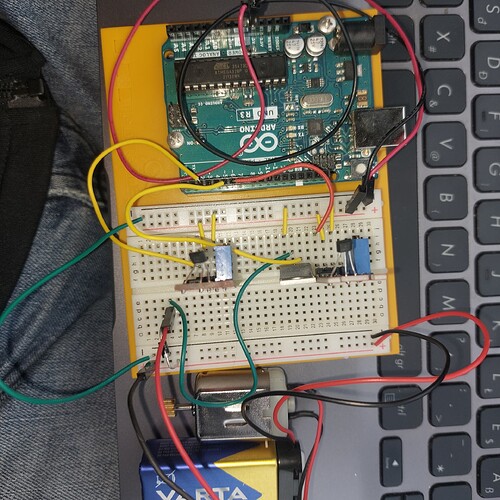

Hi All, and thank you for helping/adding thoughts!
A little bit more about the project:
On a vehicle (ATV) I would like to install a hall sensor and and magnets on the wheel of the vehicle so I can measure the length the vehicle made. I would like to attach an ejector (similar to a cylinder of a revolver gun) that holds small tubes and fill automaticly by gravity from the top and releases the tubes at the bottom also by gravity. This is what I call the ejector.
The ejector is rotated by a motor, and the cylinder holds magnets so with a hall sensor I can read the rotation of the ejector so I can regulate how many tubes are released at a certain distance. The project is so far basic and I can only share a picture of the test version - obviously, I will get industrial-grade sensors and motors (windshield wiper motor) and I might include a relay for controlling the motor but in principle it does not change much in the wiring.
Based on the comments so far (and thanks again for them) I realized that I need to change the program, especially in light what MicroBahner suggested.
My code is now the following:

Seems to work fine, the ejector starts on every 9th magnetic impulse on the hall sensor (rotation) and the ejector stops on every magnetic impulse on the hall sensor attached to the ejector - no matter what the value of the rotation counter is.
I am a rookie in Arduino (and have no programming background at all) so any modification/suggestion is more than welcome and thank you for reading this!

Hi Everyone,
I adjusted the program a bit and made a technical drawing.
drawing.pdf (207.7 KB)
This is the code:

The problem I am facing now, is that when I push the pushbutton, the ejector starts as it should and stops as it should, but on the LCD screen the ejection counter is increased noz by the number of pushes but the number is running up depending how long I keep the button pushed. I am stuck here, can you suggest me what I should change?

Nice! It looks like you are directly driving the relay from an output pin. That may work, and may only work for awhile. That really draws a fair amount of current and you could damage the output pin.
Also, FYI, in the 21st century you can lose the little croquet wickets on your signal lines.
On a schematic, if two lines cross each other and are meant to be connected, a dot is placed at the intersection. No dot, no connection. So you can cross your wires right over each other all you want.
It would make for less visual noise, which may be why the fashion has largely been abandoned.

HI,
This is where the problem occurs.
I have explained in the other thread that a relay module or a driver transistor will need to be used.
With some diagrams.
