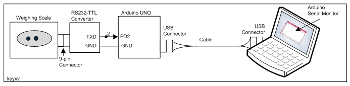

1. Make the following connections between the RS323-TTL Module and the Arduino UNO.
(a) TXD-pin of the Module with DPin-2 (Digital Pin Connector) of UNO.
(b) GND Pin of the Module with GND pin of UNO.
(c) Vccpin of the Module with 5V-pin of UNO.
(2) Put different weigh on the pan of the Weighing Scale. If the display unit of the Weighing Scale shows changing weight, then go to the next step; else, you have bad Weighing Scale.
(3) Upload the following Sketch.
#include<SoftwareSerial.h>
SoftwareSerial mySUART(2, 3);  //SRX, STX
  mySUART.begin(9600);
  if(mySUART.available()>0)
    byte x = mySUART.read();
    Serial.println(x, DEC);
(4) Change the weights on the pan of the Weighing Scale. Check that the Serial Monitor shows changing digits (this is an un-calibrated signal). To see the exact meaningful weight, you need to calibrate the received signal.

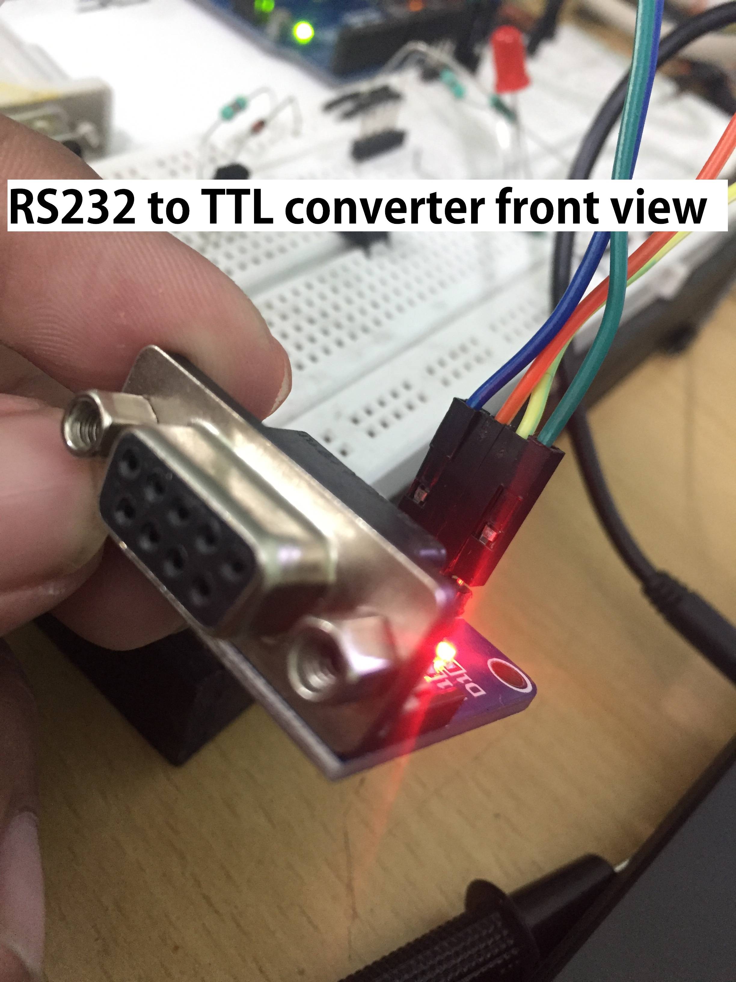

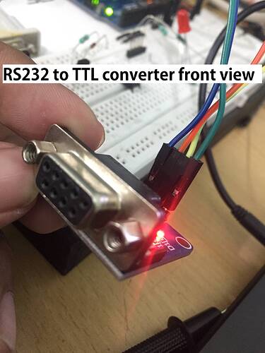

@GolamMostafa In previous attempts also, I have tried similar codes and connections but there was no success and I was receiving random values.
I followed your steps exactly but then again I am getting same random values
My weighing scale is displaying weight perfectly and with the help of RS232 to USB cable I am also able to view weight on serial monitor which is in format "+000.000 Kg", for example- If I place 390gm weight it shows "+000.390 Kg" on serial monitor
Random values on serial monitor with RS232 to TTL converter with steps followed as directed by you:

Please help me out further, If I can use any other way to receive data on Arduino because I am on last step of project and if this doesnot work my project will fail!
Thanks in advance!
PS- I have ordered a new RS232 to TTL converter with MAX3232 chip not the SMD chip, lets see

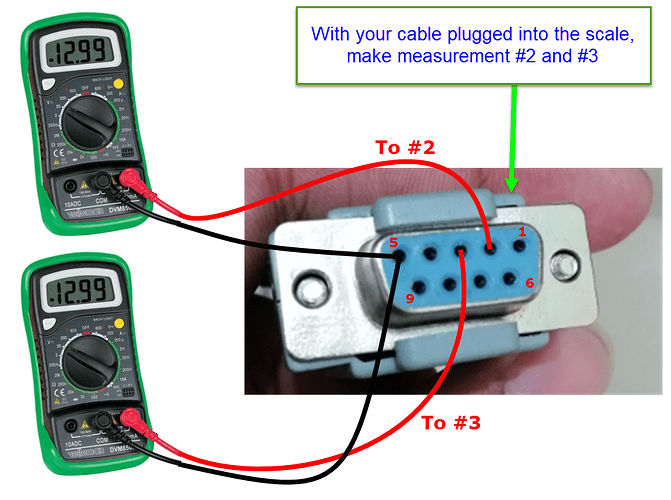

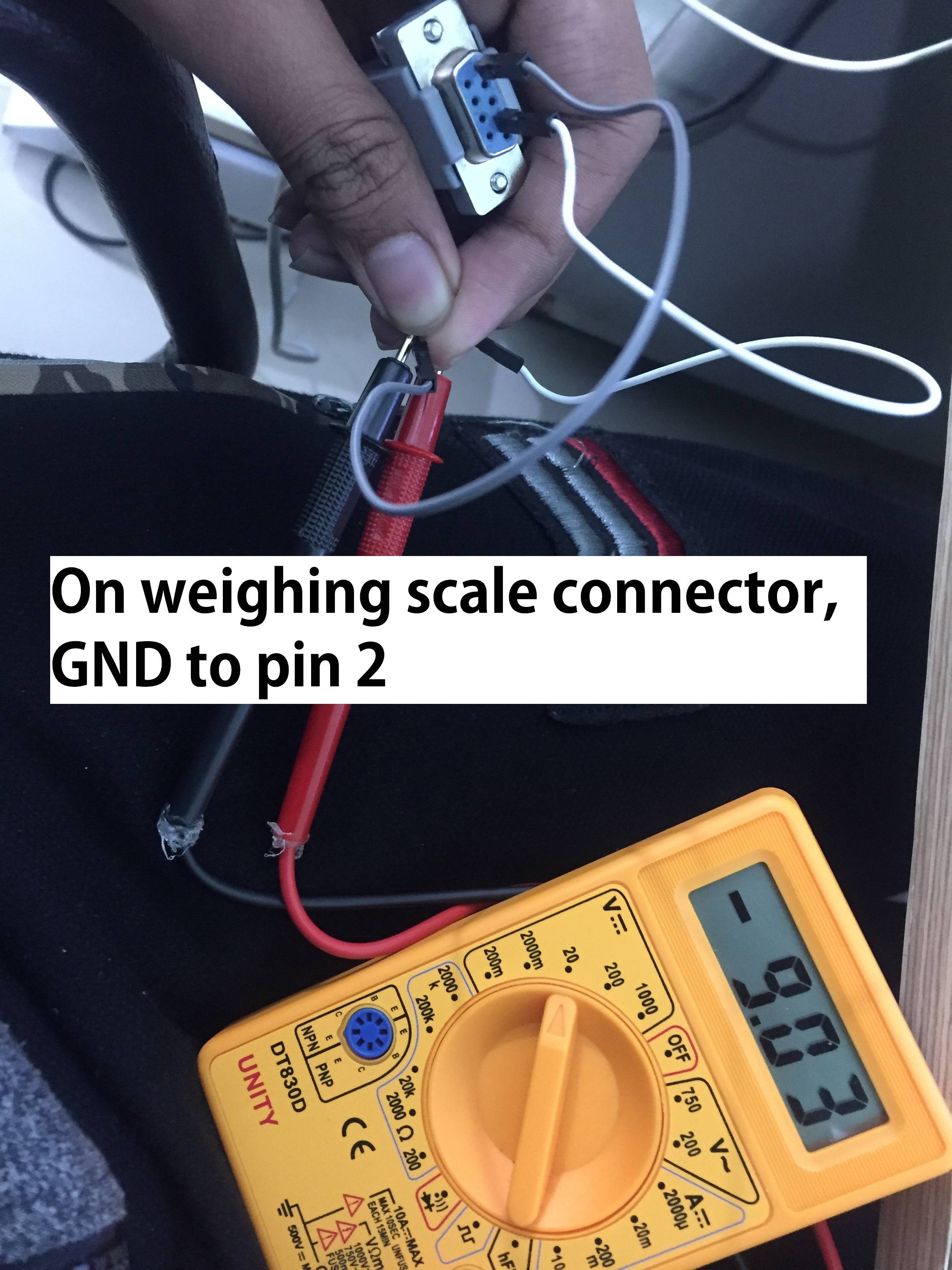

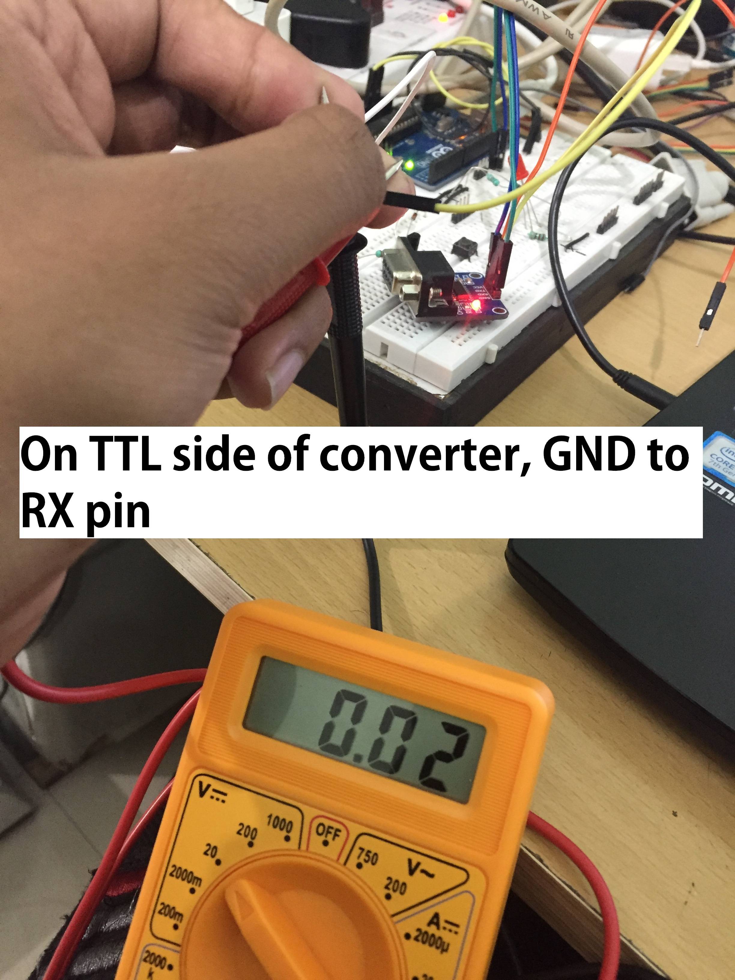

  1. If Hyper Terminal is showing the correct data, tell us what you have setup in Hyper Terminal for: Baud rate, start bit, data bits, parity and stop bits?
  2. What is the voltage on the weigh scale cable: pin #2 to pin #5? pin #3 to pin #5?

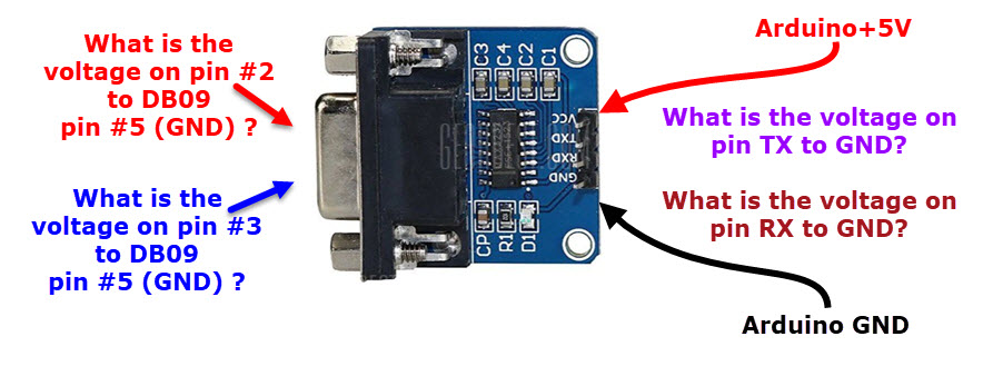

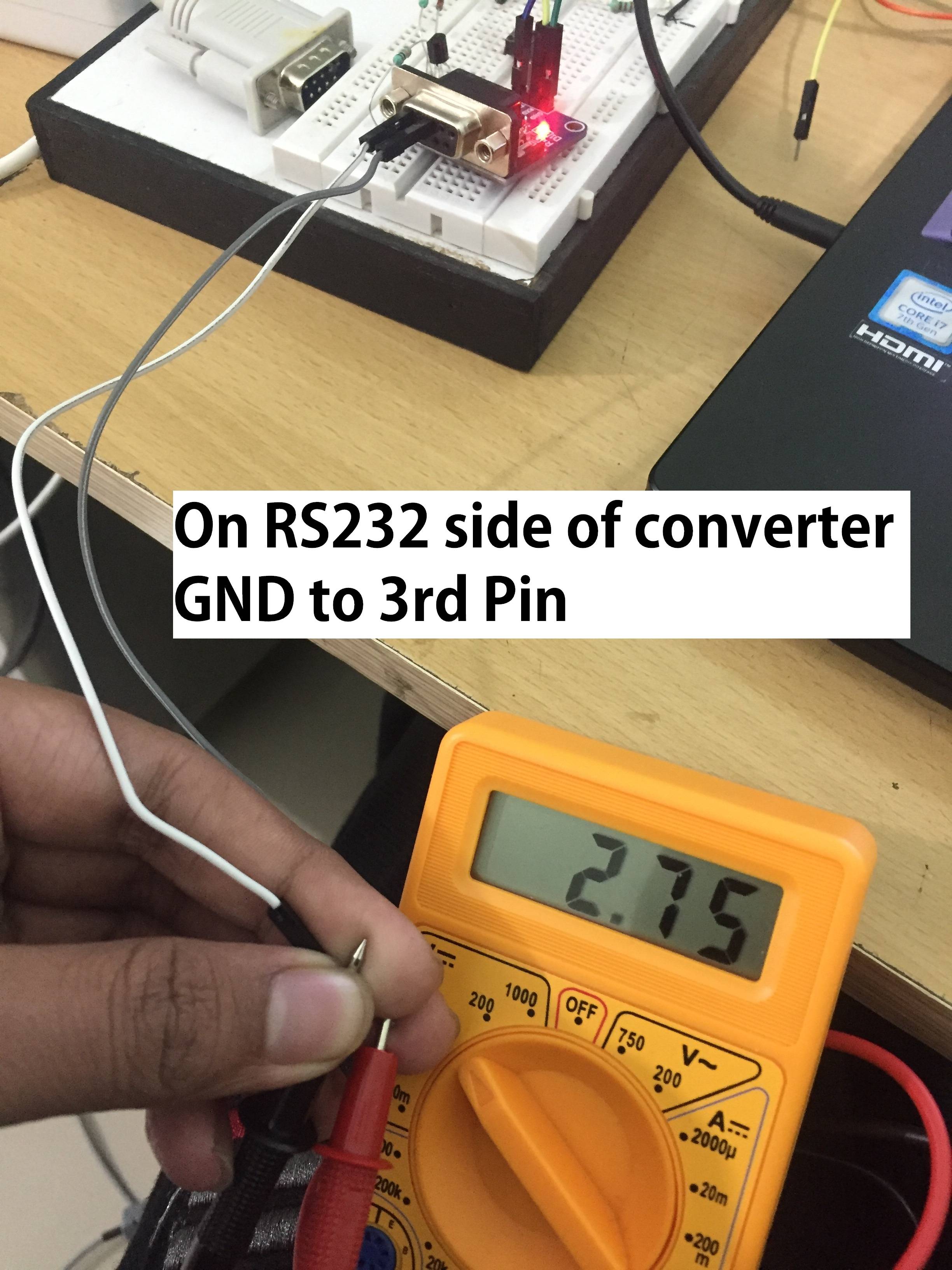

  1. With only 5v powered connected to the converter, what is the voltage on DB09 connector: pin#2 to pin #5? pin #3 to pin #5?
Make sure you identify the pin numbers correctly.

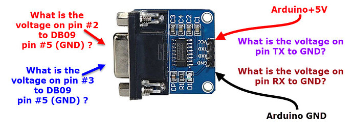

  1. On the converter, what is the voltage on TXD to GND? on RXD to GND?

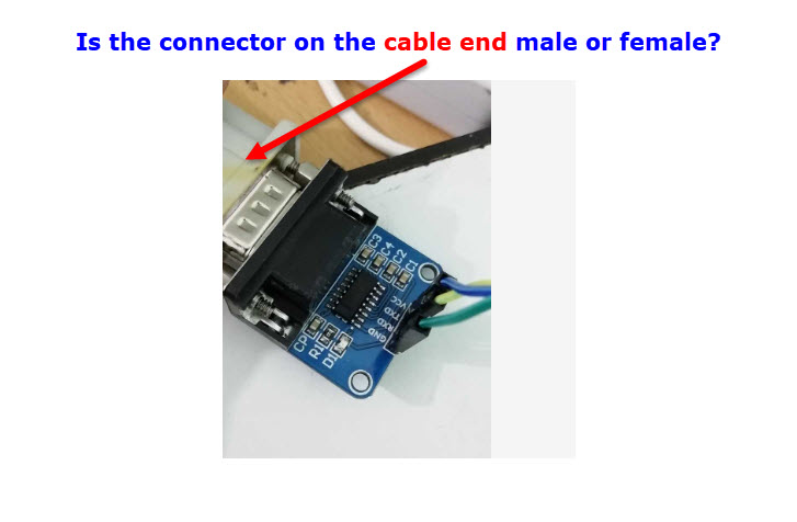

  2. The cable connector that plugs into the converter is male or female?

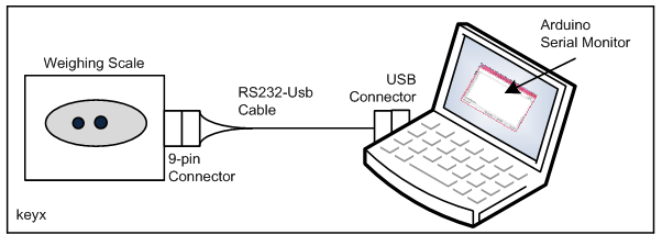

1. According to you, the following setup is working using Arduino Serial Monitor.
How have you operated it?
(a) You have opened a sketch. You have launched the IDE which has brought in a (Blank) sketch.
(b) And then you have brought in the Serial Monitor at 9600 Bd.
(c) You have engaged the RS232-USB Cable and have chosen the correct COM Port from the IDE.
(d) The Serial Monitor shows correct weight that corresponds to the weight you have placed on the pan of the Weighing Scale.
OK! Fine!
2. Now, you want to make the following setup operational -- correct?
I am curious to know why you have been so interested to make the above setup working. What do you want to achieve/what is the purpose?

OP sent the scale data to PC with RS232 to USB converter.
Then went to Tools in IDE then selected that comport and then opened the Arduino serial monitor. ? ? ?
To bring in an Arduino Serial Monitor, one must launch the Arduino IDE which (in turn) brings a (Blank) Sketch.

larryd:

  1. Hyperterminal setup:
  2. On weighing scale connector:
![|375x500](https://i.imgur.com/IDLYSmA.jpg[\img]
  1. On DB09 connector side:
  1. On TTL side of converter:
  1. Female:
  1. I tried this code, first I want to declare one thing, when I connect GND to GND and VCC to 5v from Converter to Arduino and then connect RX pin or TX pin - Nothing happens, but if I remove +5v from arduino then serial monitor starts getting values.
I have tried all combinations!
I tried your code and I am getting output like this:
0000
Same result I am getting with @GolamMostafa codes, I also tried by "Pin-2 of the 9-pin connector of the Weighing Scale will be connected with Pin-3 of the 9-pin connector of the RS232-TTL Converter Module", then I got result like:
I think my converter is faulty and I have ordered a new one!
Thank you so much for your support, and do guide me what should I do next!

1. You have worked with the following setup and you have seen the above reading on the Serial Monitor. Let us begin from here to understand the nature of the 'Transmission Frame' being sent by the Weighing Scale processor over the UART Port. Once the frame structure is known, we can easily develop our sketch for the UNO setup to catch the numerical value of the weight and save it into a variable.
2. Serial Monitor shows: +000.390 Kg; it means that the Serial Monitor (it is an ASCII device) has received the following ASCII data bytes from the Weighing Scale.

You have said that the Weighing Scale works fine with RS232-USB Cable + Arduino Serial Monitor at 9600 Bd; if this is really true, the circuit of Post#37 and the Sketch of Post#51 is guaranteed to work in this setup: Weighing Scale + Circuit of Post#37/RS232-TTL Module + Arduino UNO + Arduino Serial Monitor.
GolamMostafa:
Yes with RS232 to USB + arduino serial monitor/Putty/HyperTerminal at 9600 Baud rate output is perfect!

Looks like the Converter is NFG (not functioning good).
Your scale transmits on pin 2 therefore it is DCE, it is sitting at -V on pin 2.
DTE transmits on pin 3 on a DB09 connector, pin 2 on a DB25 connector.
The Scale has a female plug and the converter has a female plug.
It would have been nice if you told us you were using a gender changer.
You might have a wiring problem with it.
Good pictures.

  1. Please, post the screenshot of the Arduino Serial Monitor of this setup: Weighing Scale + RS232-USB + Arduino Monitor. (Press Print Scrn Button, paste in the MSWORD and enlarge, Press Print Scrn button, paste in the paint, select the image and save and then make a post.)
  2. You don't need to include those codes with the sketch of Post#51.
Coming soon with the next advice.
