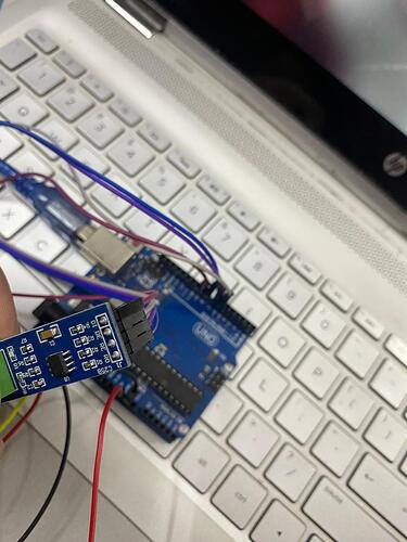

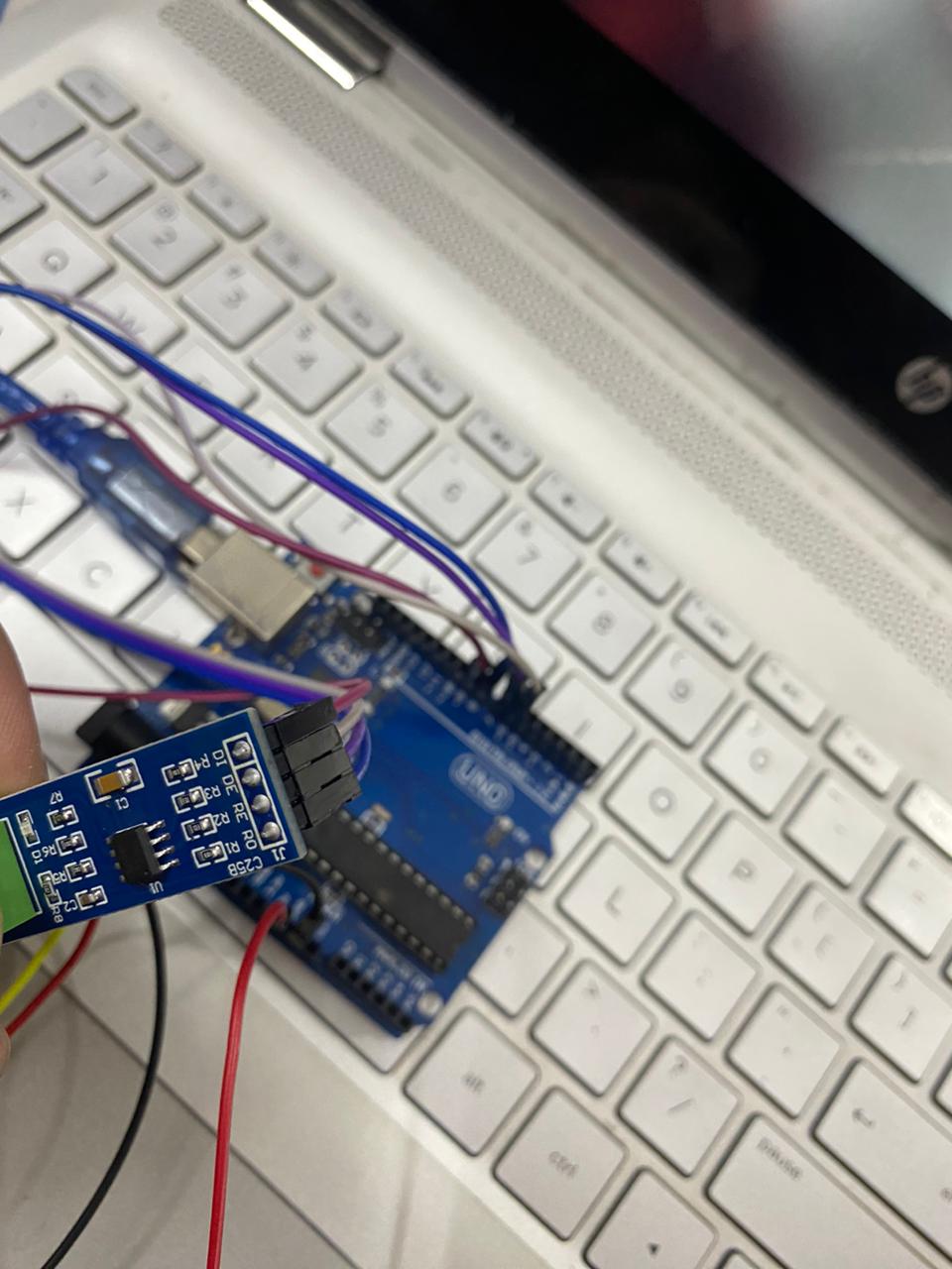

Also note that you are right at the bottom end for supply voltage for your sensor if you are powering it from the 5V of your UNO. Your photo in post #1 indicates that the supply voltage range is 5-24V DC.
I would advise you power the sensor from an external DC bench supply - somewhere around 12VDC should be fine. Just make sure that you have a common ground (0V) between your sensor, the RS485 module and the UNO.
Looking back at your photo in post #9, I assume that you may be on an Electrical Engineering course? Can your tutor provide the user manual for the sensor?
my connections,
I did connect it with 12 volts external battery and got that null output same as before. my tutor didn't provide me with the datasheet as they didn't have it either. I've been searching the datasheet for this specific sensor for quite some time now but didn't get successful and posted it here.

That's going to make it interesting! What does your tutor want you to do with the sensor? What's the purpose of the exercise?
But first, correct your wiring as @jim-p advised back in post #20.
so they only told me this sensor will measure soil moisture and temperature, i need to configure it with ESP 32.
wiring has been corrected as advised by @jim-p.
Ok, but I would suggest sticking with the UNO for now as the MAX485 module you appear to have uses a 5V RS485 device. Lets get you communicating with your sensor first before introducing more issues.
With your wiring altered as suggested, are you getting any response from the sensor?
no, it's same as before.

Yes but the wiring is the same.
Is your wiring the same as shown on the website?
