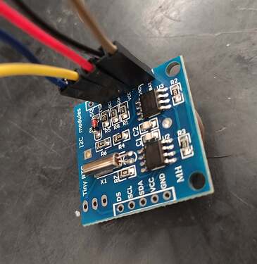

I am currently developing a project in which I'm using a RTC DS1307 module to get access to current time and date.
I managed to get it to work just fine when connected to my Arduino Mega 2560. I am connecting the SDA and SCL from RTC to pins 20 and 21, respectively.
However, as soon as I put my Ethernet Shield (which I use to access an SD card) on top of the Arduino, the connection with the RTC boards stops to work, and I get the following message from my Serial Monitor:
Couldn't find RTC
I am using the example code available from the RTClib library, with no alterations:

Does anyone have any idea on how I could solve this problem?
Thanks in advance.

Post links to the specs of your shield and your RTC module, and post a photo showing how you are physically connecting both to the Mega at the same time.
Generate a schematic of how you have it wired showing power and ground, I am fairly confident you are using a pin for two incompatible functions. Post links to technical information on all hardware devices.

Here is what the connections look like for the RTC DS1307:
