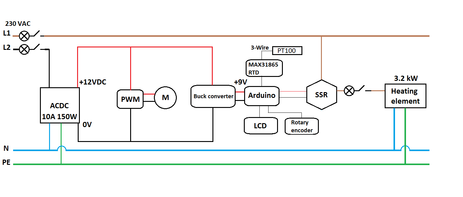

I'm working on an automatic beer brewing project. I have built a control box that basically consists of:
SSR relay
3.2kW heating element
Arduino to control heating element w/ PID
12V 150W PSU
12V motor
PWM box to control the motor
MAX31865 RTD
PT100 temp sensor
See attached picture for the circuit diagram.
Basically what the program does is it reads the temperature of water in a kettle and outputs a signal to the SSR to heat the water according to the PID algorithm to reach the setpoint.
However, whenever I run the motor (it agitates the water) the temperature reading stop working. It recovers once I turn the motor off. Not that the motor doesn't actually have to start spinning for the sensor to go haywire. Just as soon as there is some current going to the motor the sensor is disturbed.

Can you take the sensor out of the kettle to try?
Whats the PWM box?
How is the motor controlled.
Do you have a kickback diode across the motor.
Leo..
I can take the sensor out of the kettle and try. The motor and the sensor are only in contact through the water in the kettle however.
I do not have any diode connected to the motor. I always assumed the pwm controller took care of that. Also the problem occurs before the motor even starts rotating which is why I assume it is not due to current generated by the motor.

Any reason not to connect the DC 0V to PE?
I tried connecting DC 0V to PE. No change I'm afraid.
Currently the microcontroller GND and motor GND are connected. Would it be sensible to separate the two by connecting the motor GND to PE instead?

I think I have solved the problem. There were actually two issues.
The temperature probe has a metal sleeve. When this touched either the kettle or the bench (metal bench), electrical noise from the motor would disturb the signal through the sleeve. I'm going to add a rubber sleeve on top of the metal sleeve to isolate it.
The second problem was noise from the PWM output. Since everything is in a box, when the output from the PWM reached a certain threshold the Arduino would pick up the noise from the power cables nearby. I added a metal sleeve to the PWM output cables. At first however, the sleeve made no difference. Finally when I grounded the sleeve to P.E. the problem went away.
